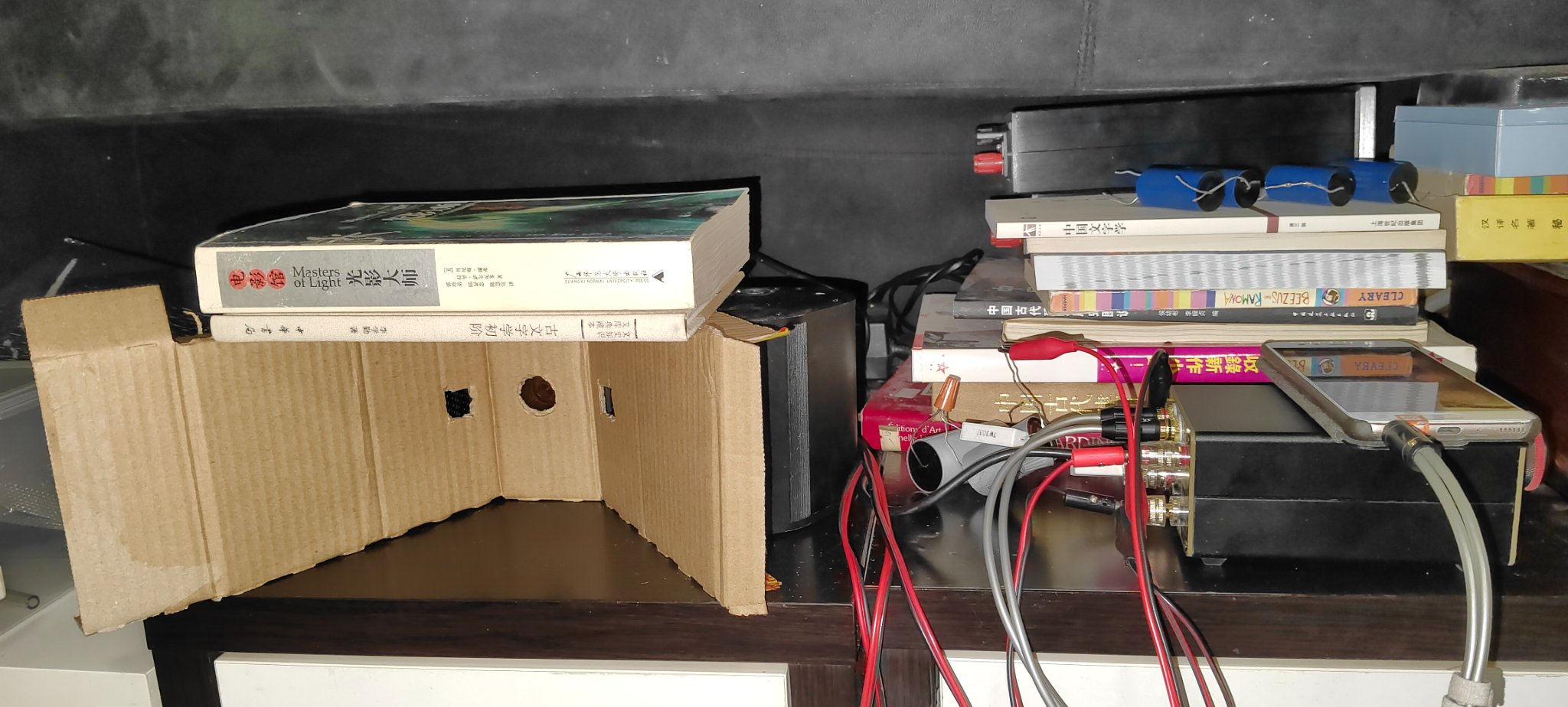

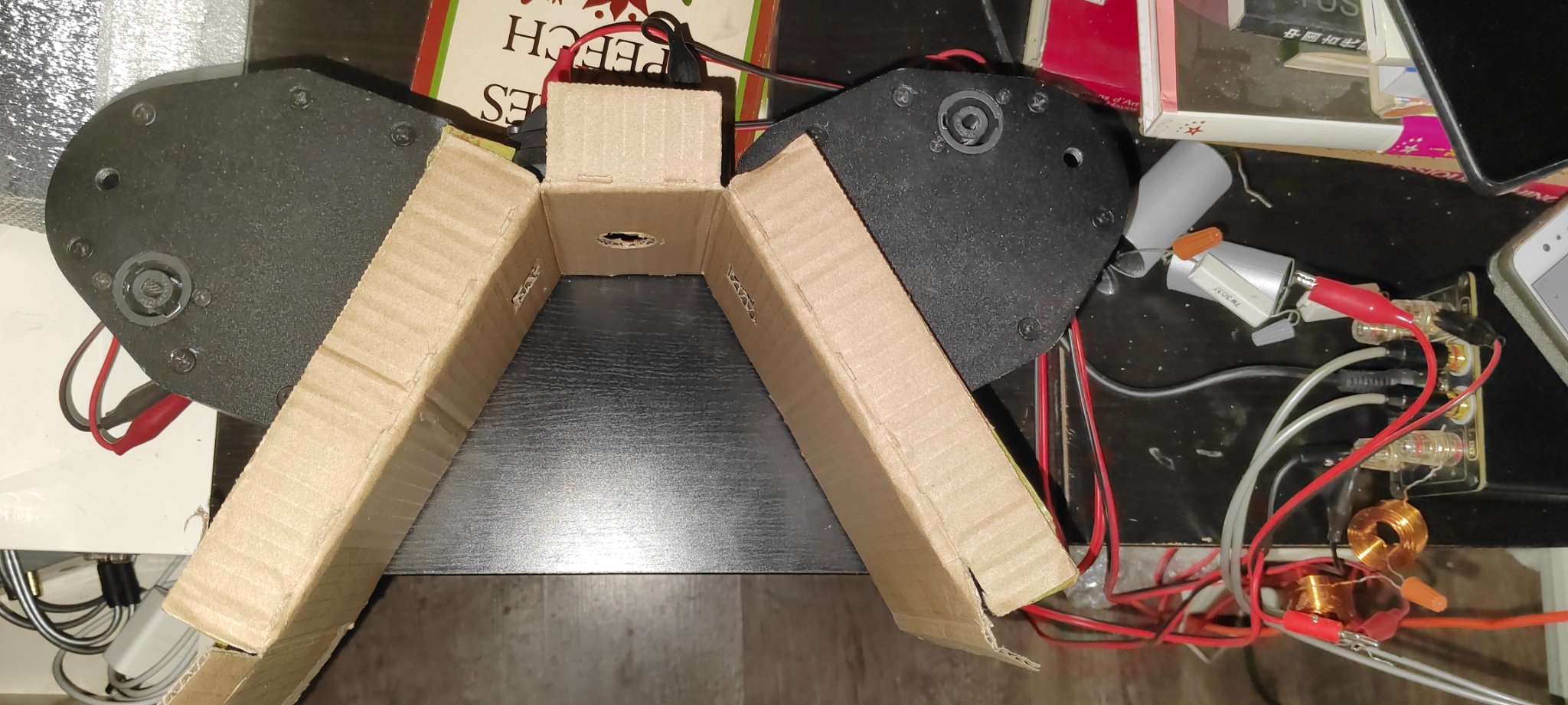

I've been thinking about this too. A pair (or quad) of bookshelf speakers placed / \ with boards (or thick Al-foil-backed car anti-vibration pads) for the horn sides. Just got a used pair of HF108 to play with next long weekend.
I think so, the 3khz hump is nicely shaped. But it's past midnight here and I had spent maybe an hour on it using scrounged bits. After tweaking the horn angle in real-time (!), I was quite surprised it worked so well. Besides being extremely dynamic, it rendered superlative transcients and performance detail I hadn't heard before. Alas mono. I think I can notch out 2.7-3.5khz passively and move the high-pass much lower; but not necessarily better.
I was really thinking active/EQ/etc but Minimalism strikes again!
(correction: 2.2uF not 0.22)

For some time now I've wanted to compare my reflector-coaxial PrimeRadiant against another quasi-coherent-point-source 2-way, the Multi-Entry-Horn. I can't really do the MEH justice, but here's a Minimalist MEH (Minmei) experiment done over three sessions, listening and tweaking the passive filters to tame back flat the horn-bloat FR -- a rather fool-hardy challenge. But it has been fun and the result extremely vivid, detailed, and dynamic -- if not "holographically deep" like my coherent speakers or a really good fullrange driver. I did more-or-less time-align the drivers but phase would...
