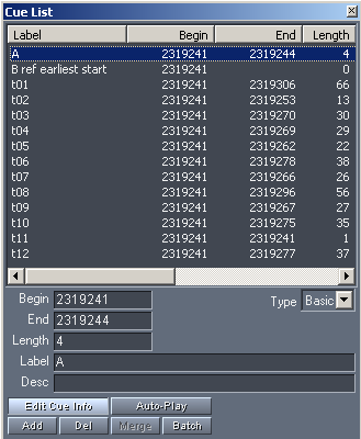

I've posted in your other listening test threads about track alignment errors. Same applies here. Your alignments are sloppy. Cool Edit allows maintaining cursor position when switching between track, and provides far better zoom control. Waveform display is interpolated as well, providing much more accurate waveform depiction compared to Audacity's crappy connect the dot display.
Loading the 14 tracks, B was found to have the earliest start time. Switching back and forth between B and other tracks a series of cue markers were made indicating alignment errors to single sample accuracy:
In above it is seen that start times vary by as much as 66 samples, roughly 1.5ms. This could impact how some sort files with ABX.

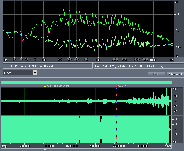

Alignment to single sample is not good enough for applying sample to sample difference (file difference) approach in analysis. This requires sampling files to higher rate, such as fs 192kHz and making further adjustment. Then amplitudes of waveforms need to be matched, preferably to levels better than 0.001dB. Once this is accomplished, difference results such as Pavel's are possible:
In above overview of tracks are shown. Yellow vertical line shows point chosen for making alignment and creating spectrum view.
With tracks aligned at this point, examination near end reveals alignment drift, this may be due to number of causes. Drift in clock frequency between recordings, sample dropout, and thermal effects as example possibilities. This is seen in difference track as increasing amplitude.
Pavel pointed out glitch in file difference spectrum around 4kHz. In his and above view closer examination reveals harmonic character, with spectral pattern recurring at about 8kHz. With closer study, this motif is also visible at 250Hz, 500Hz, 1kHz, 2kHz. This could be artifact of difference technique, but could also be subtle differences in group delay characteristic of the two test conditions, or even possibly harmonic distortion.
