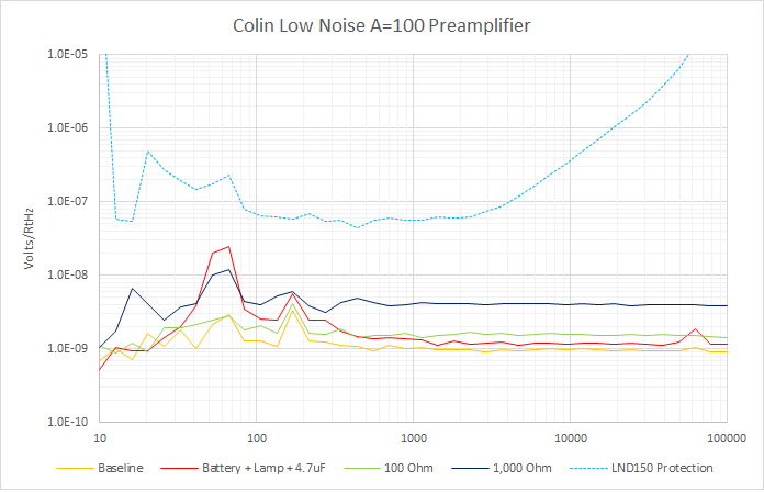

Will start another thread about protecting your low noise amplifier for measuring tube noise -- just want to post 2 different methods. The dotted cyan line is the Supertex protection scheme using two back to back LND150 depletion mosfets. It allows a maximum of 1mA to flow into the protection diodes. Totally useless for tubes.
The red line is a 4.7uF 630V polypropylene capacitor in series with a small incandescent lamp. The cap is biased with a 9V battery. The lead length picks up significant mains energy, but otherwise the scheme adds just under 1nV/Rt Hz from 200Hz to 100kHz.
Baseline for the amplifier, and "reality check" for 100R and 1kR included.
