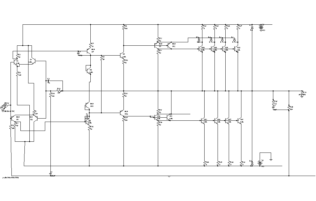

I now have liner technology spice.I have run the schematic through this software but I dont know what im looking for it looked like s**t for the start but I found dry joint and upside down transistor the output sine looks good now +68.34v to -68.22v and same as input in shape in= +2.2v/-2.2v how much should the input be ? is this correct and what else should
i look at.how do i get rms v from this? is it 137x.707 or 68.5x707
this will be a good tool when I get the hang of it .can anyone help me
