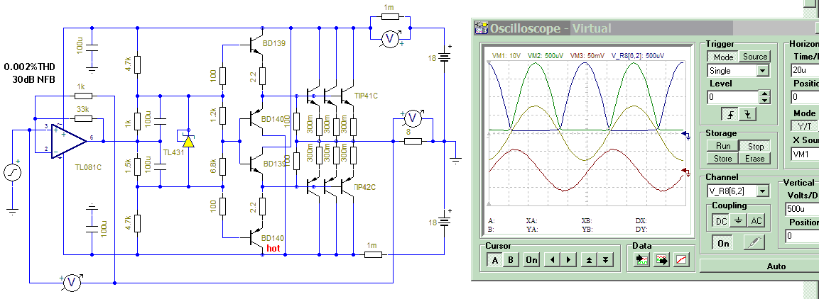

1.Soulution : Don't know what is inside, homemodder said equal with self's based with many bjt outputs (enriched class AB).
2.Technical Brain : Non switching OPS based (better than self's OPS) with balanced topology.
3.It must be your job to find the 3rd.:p
TBP OPS may better this way for stabler (may be).
Edit: I forgot there is BD139(bottom) also hot.

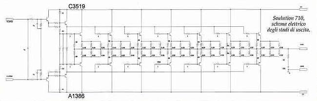

This is the Solutions 710 output stage and schematic. It uses low cost Sanken power transistors. I think the stage before the output stage is AR D-400 inspired.
Thanks tommy, that's make it clear.
So there is no feedback from OPS, Linearity just coming from reducing its triple EF gain with resistors (simplest local feedback, but it is OK to call it no feedback), then linear current fed into the OPS by opamp based current source.
But, is there really no feedback? because their DF claime 10000. I am going to look at it.

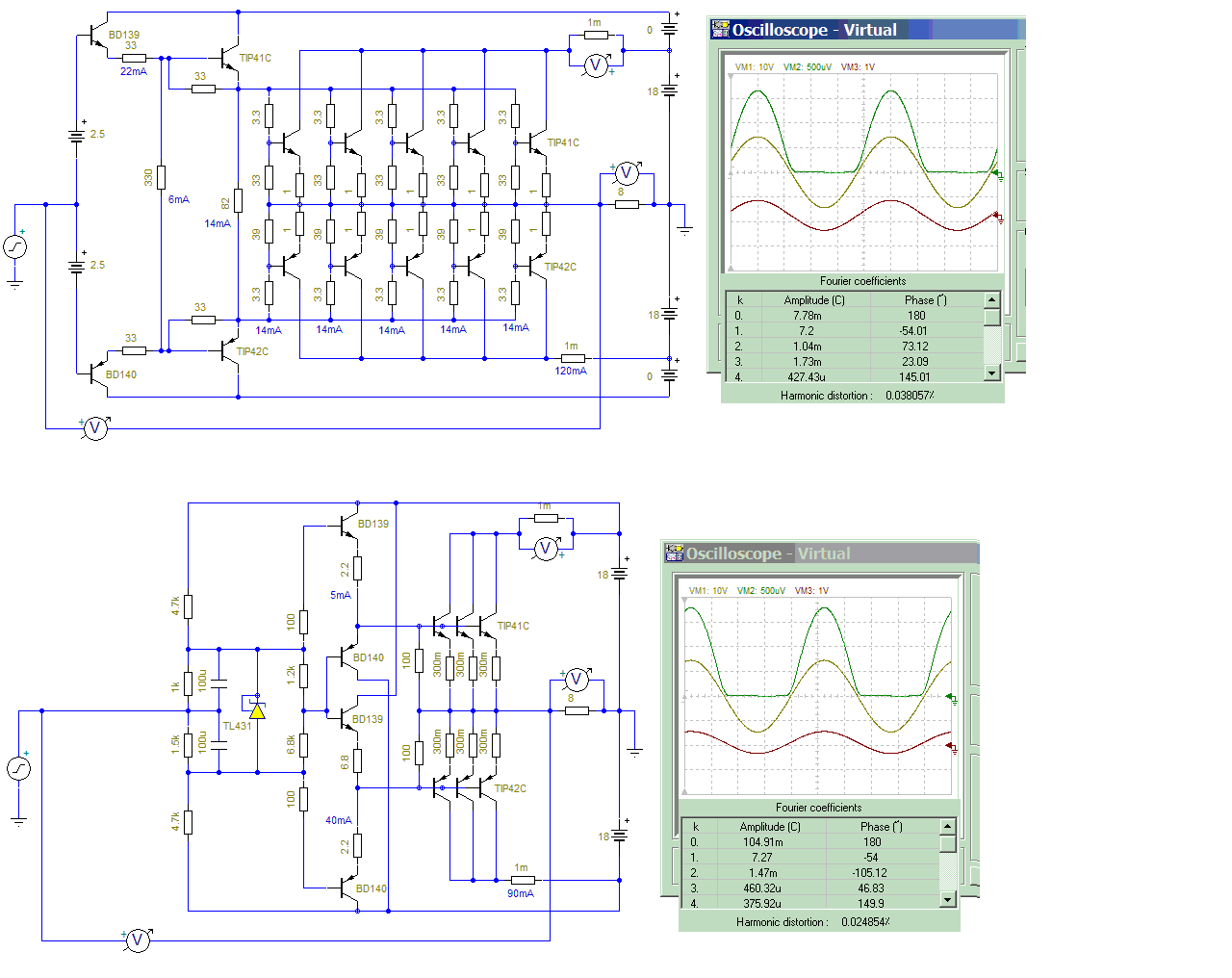

OOps, I am doing mistake in TPB zero, its asymetrical driver current isn't make the OP transistor to not switching, but only help in forward and reverse linearization, I am just think where its non switching coming from and doesn't find any reason. But just found some my measuring mistakes.:no:
So TPB Zero is not non-switching OPS, but only linearized. <0.3%THD without feedback in voltage mode. Could reach 0.1% with higher current driver.
This is both TPB and soulution plot. I tried to linearize soulution with resistors, not reaching any good results with typical BJT (TIP41/42) There may be the error correction coming from inputs (pre EC) or just choosing linear BJT's.
