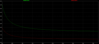

Thanks for the replies. I ran the Ic/Ib for both and one B was 160 (on semi) and the other was 220 (ST). I was not outraged - but concerned.
I have the DCA Pro - and have tested all of my power transistors, but not the BD140/139.
It was because the simulated results for the Vbe multiplier were so different from circuit, that it caused me to examine the models.
I won't go as far as examining the models in Excel ( 🙂 ), but i did have a quick look at the model used by spice and the factors surrounding beta use.

Vbe Multiplier Modelled
I implemented the Vbe multiplier using the same circuit, where one uses the On Semi model, and the other uses the ST Microelectronic model, both for the BD139 and BD140.
The results are not as expected. The difference in the Vbe curves for a change in resistance for setting the Vbe is much greater than expected.
I attach my simulation file and out for the two Vbe's. Have i made an obvious error ?
Thanks and regards,
Shadders.
