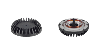

One of the problems with the titanium based diaphragm compression drivers is the breakup around 11khz-13khz. There are a couple of ways I have been reading it has been dealt with as below:-
a) Use of non titanium materials that inherently dont have breakup in the pass band, these have some sort of plastic like engineered material
b) Titanium based diaphragms with embossed strengthening pattern to increase stiffness and move the breakup above the 20Khz range
c) Use of ring radiator diaphragms, the ring is driven by the mechanical center and ring stays pistonic to a very high frequency, the material thus is less important here I believe

1) JBL CDs with embossed pattern, probably of titanium.

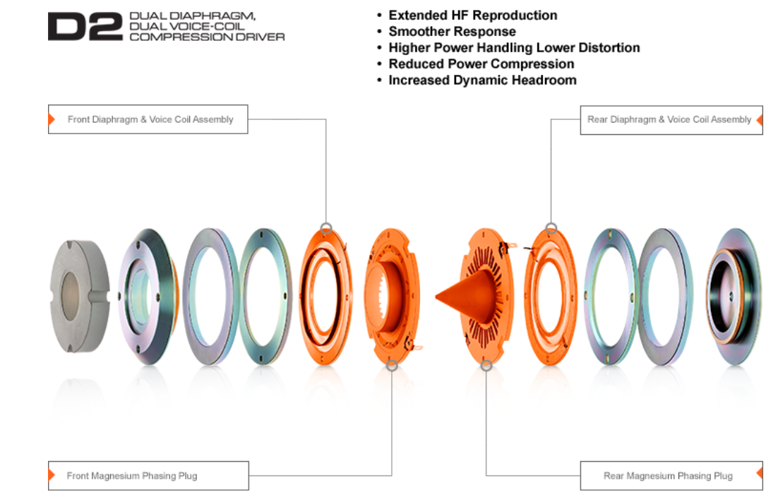

2) Then F151M-8 1" Ceramic ring radiator from Eminence.
3) JBL D2,revolutionary driver, with two rings facing each other, now patent has expired and so several clones available at Alibaba

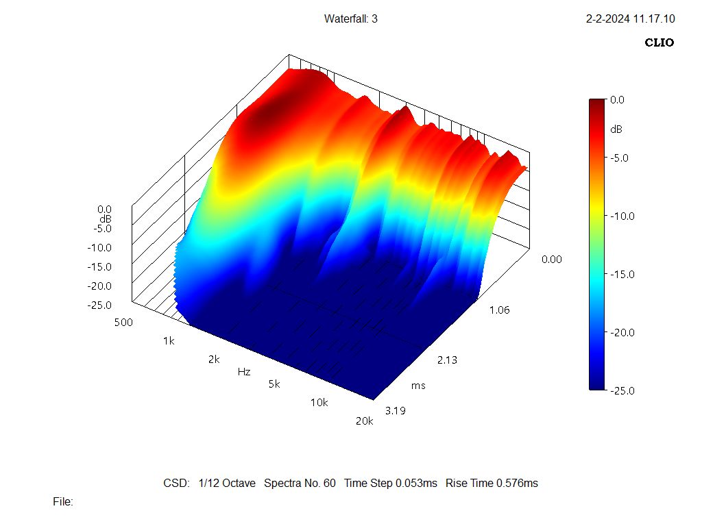

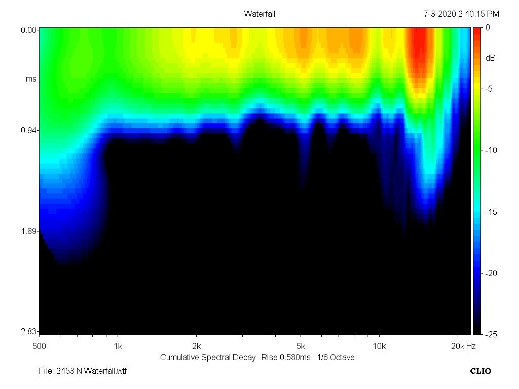

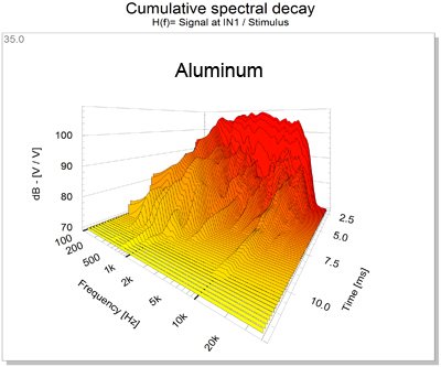

1) cure worse than disease. Look for waterfall plots, the JBL ribbed Ti dias fare worse than the smooth ones.

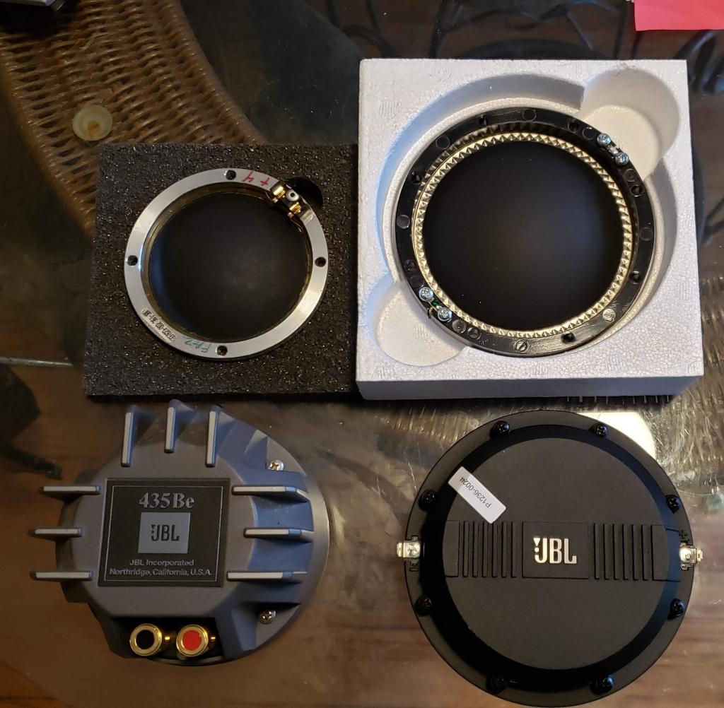

2-4) all ring radiators (including the fancy JBL D2) give up low-frequency extension, and/or lead to increased distortion below 1kHz, due to displacement limits. So you gain something (>10kHz, which may or may not be audible), but you lose something else (<1kHz, which is definitely audible).

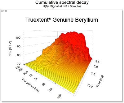

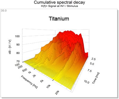

The only "fix" for break-up in the 10-13kHz range that actually works is a Beryllium diaphragm. But, of course, that's expensive.
