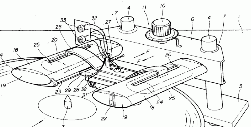

From time to time I wonder about this: Has there ever benn a linear-tracking turntable that used a liquid as the medium to "slide" the tonearm across the record? If so who made it? Is there one on the market today? I have searched the internet a bit, including DIYAudio, and found nothing. Maybe I'm not searching enough?

The problem is maintaining a reference for the bearing that is sufficiently rigid. It could be done using magnetic repulsion on both sides of the 'carriage', but that doesnt stop rotation...
So there are technical problems, that could be technically fixed, but after the efforts to do so, the result is worth listening to is anybodies guess.

Looking at the patent, which I think would have expired, I notice no-one's taken it up in 40 years, which is maybe a pointer to how practical it is.
I think the patent design is a real non-starter. Moving the float through a narrow trough is going to create quite a lot of hydraulic drag compared to an air-bearing solution and if you've read the discussions in the forum on magnetic control you'll realise how hard magnets are to implement. Those wierdo liquid contacts look like another bad idea. Also, the arm has no damping or positive stability. I have a suspicion that as soon as the arm plays a note whose frequency corresponds to a multiple of the dimensions of the trough, you'll get ripples in the liquid and the thing will oscillate between those magnets for ever.
Linear-tracking fans tend to forget that records aren't perfectly concentric and the patent design has massive inertia that the poor that little cartridge would have to overcome twice a revolution as it waggles in and out following an off-centre record.
