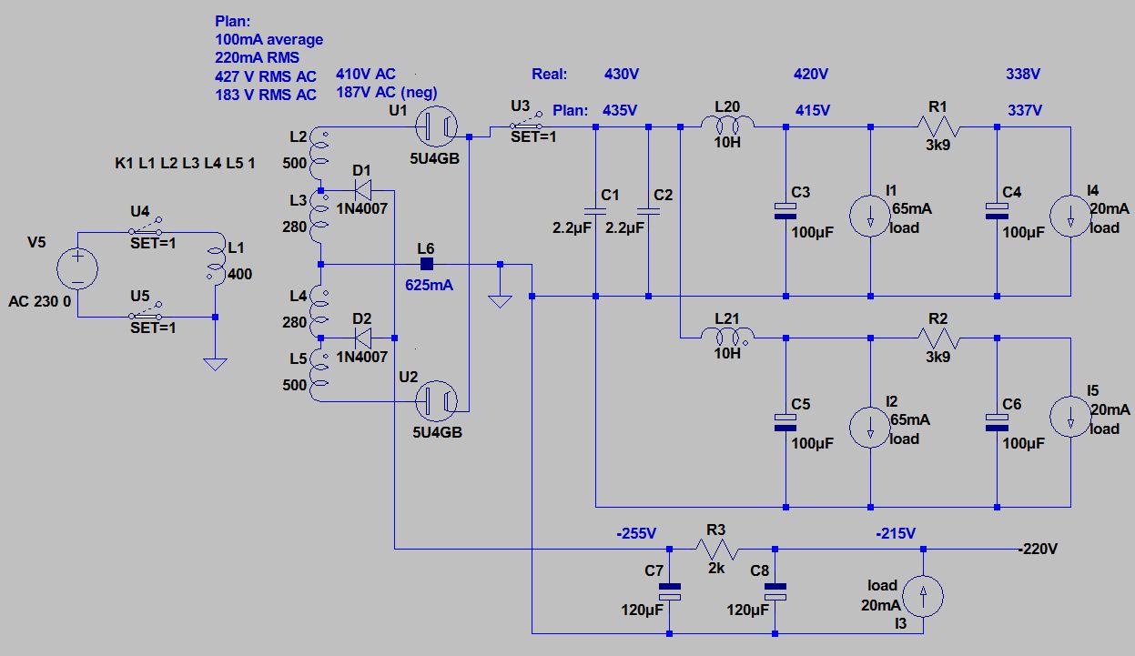

I just went out to measure B- voltage. It went up to neg. 360 volts, then dropped to neg. 325 volts when B+ came up. Measured C6, and C7. C7 measured 100uf as soon as I put the meter on it. C6 read 50uf and slowly climbed to 100uf. Maybe C6 is damaged? Anyway, I'm sending to Mouser for the stock Caps for these spots. Lets see if this fix's the B- problem.

Does it start up with -360V right on the 300B grid? What voltages on C6 and C7?
