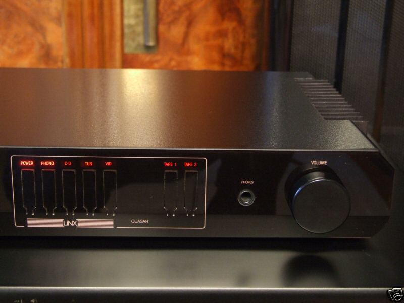

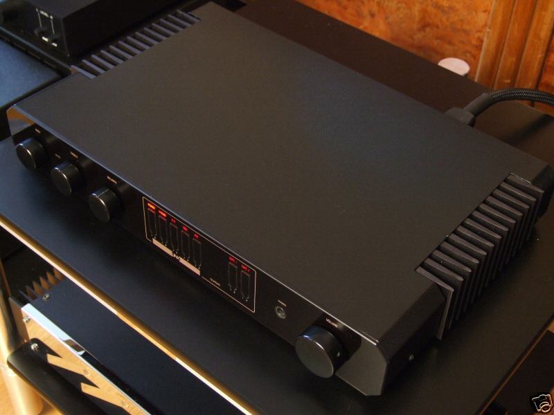

In the attached PDF files my own created schematics from LINX model "Quasar" - perhaps helpful.
