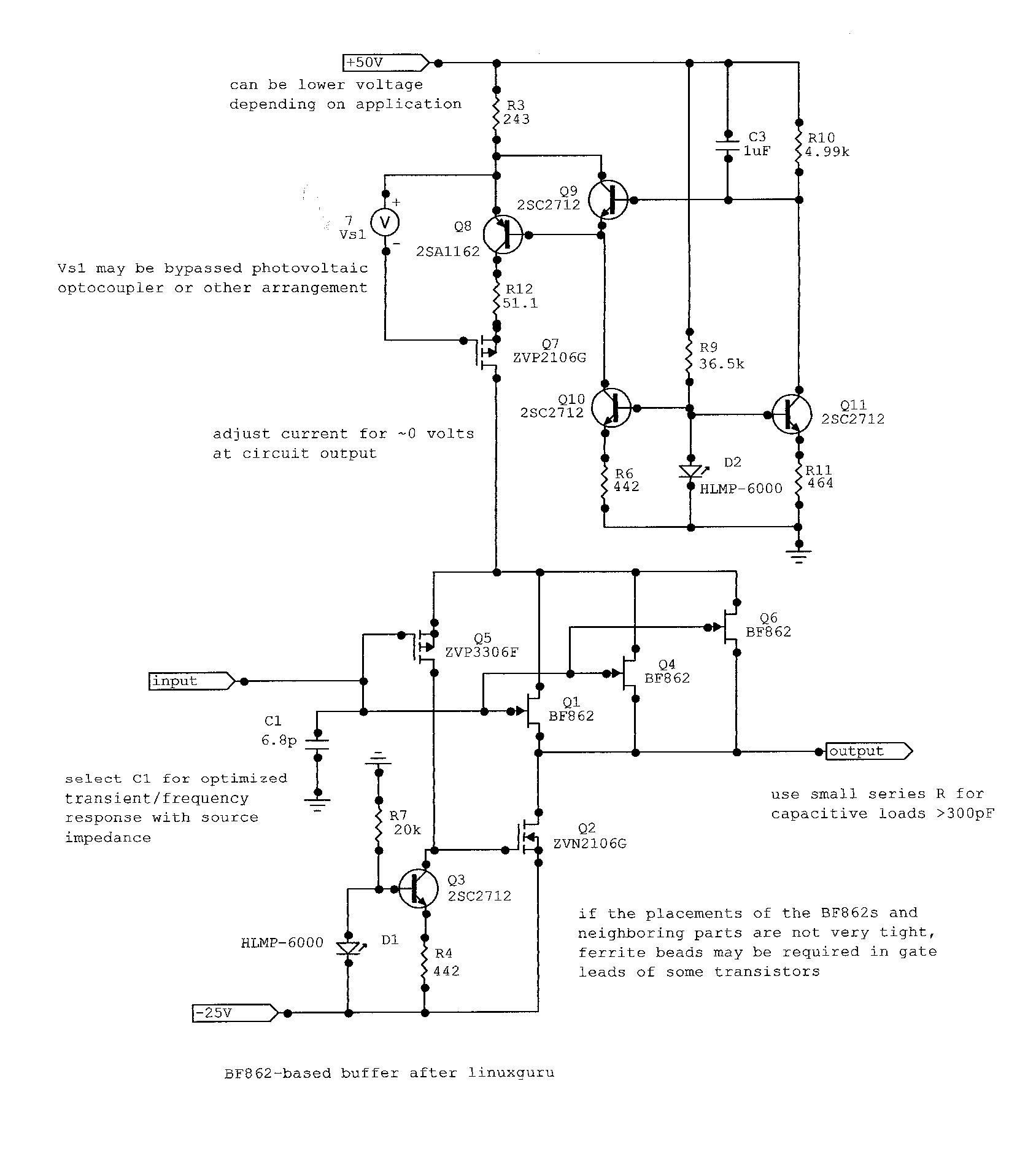

Back a while ago linuxguru posted a unity-gain buffer circuit that had some interesting features. See http://www.diyaudio.com/forums/anal...iscrete-opamp-open-design-94.html#post3164879
I studied it and began some investigations as to how its performance (already exemplary for such a simple circuit) might be improved. I mentioned I would eventually get around to posting something. I had occasion to revisit and extend that work recently while looking into an I-V converter that needed a buffer. A schematic of an example is attached.
One of the things I most like about linuxguru's approach is the notion that the JFET input device(s) are basically running the show, but with the heavy lifting into loads done by the rest of the circuitry. Not only is the noise performance outstanding, with a little care mostly due to the JFET(s), but the latter operate at both nearly constant voltage and constant current --- that is, constant dissipation. So the sorts of second-order effects that often plague designs that look otherwise good "on paper" are sidestepped here.
Quite a few more parts than the original, but I think worthwhile. The particular example will drive +/- 20V peak to peak into 600 ohm loads. I have yet to build it, and note the caveats about a propensity to high-frequency oscillations involving one or more active devices. I'd recommend actually stacking the three BF862 in the Z plane as it were, using a bit of bus wire as a combination conductor and heatsink for the gate leads.
The +50V is a constraint from other parts of associated circuits, and can be reduced for other applications, as long as the positive output swing is accomodated. The surface mount DMOS needs to have some copper in the vicinity of the large drain lead connection to manage the dissipations. The circuit needs a little lumped input C for ideal frequency response, which may well be supplied by the source impedance.

guide to the possibly perplexed
The correspondence between the presented circuit and the original may be somewhat obscured.
Q7 through Q11 are just forming a low-noise high power-supply-rejection ~39mA current source, a function performed in the original circuit by J2 and R2. This could probably be simplified without much loss of performance.
Q3 and neighboring parts are another current generator, and substitute for R2 in the original. The effect of the generator is much higher gain of the loop that detects changes in the output current and stabilizes things. Of course the input impedance at the gate of Q2 is quite high.
There is no great effort made in this circuit by itself to stabilize output voltage drift, as in the intended application of buffering the resistor-terminated output of a current conveyor, there will likely be an overall d.c. servo. However as remarked elsewhere the voltage drift of BF862 parts is fairly small near Idss. If it were to be further stabilized, a matched set or a single matched device could be used to control a current generator that would replace Q7 etc.
Note that the gate-source voltage drift of Q5 is a second-order effect, since the output conductance at the 862 drains is fairly small.

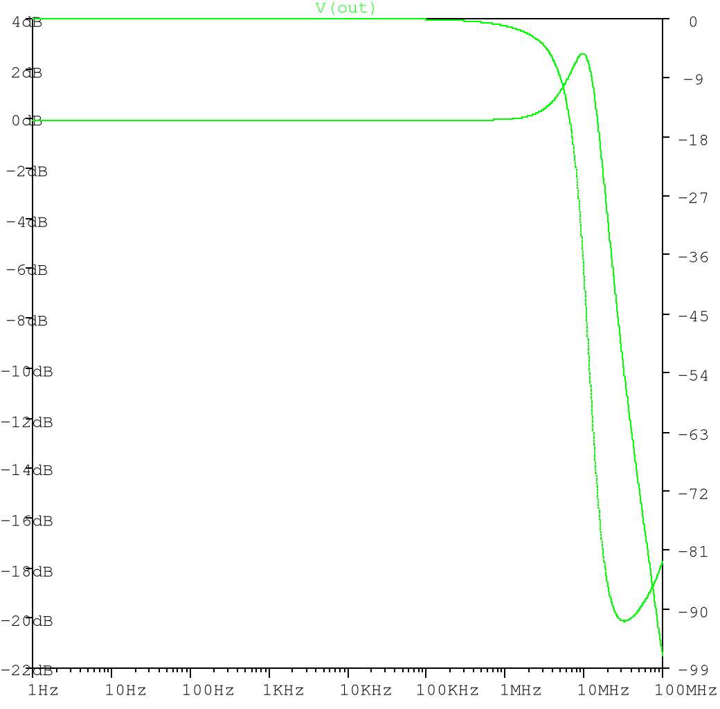

revisiting the revisited
With unity-gain buffers a topic elsewhere, I went back and reviewed the proposed design from the first post here, looking at reducing the distortion arising from variable input capacitance, which becomes important for high source impedances. Having looked at such a metric for a more conventional bootstrapped-cascode source follower and using 100k as the source impedance, including one approach to compensating for output loading, I went back to see how the linuxguru buffer was doing at 100k.
The answer is, not bad at all. But it dawned on me that I had never tried driving the P channel input device from the output, the sources of the BF862s.
It works a lot better that way, with some small changes in the input capacitance. About half a pF is needed to avoid peaking. I also changed the NPN current sink with the LED bias to a JFET with a bit of external source resistance, using a 2SK117, and this may very slightly degrade overall loop gain.
For a 10V peak input at 1kHz, with the generator driving 100k in, and the output driving 600 ohms, sims predict that most of the distortion arises at the input: to 15th harmonic, about 114ppb (0.114ppm); the distortion at the output is about 148ppb. Again thermal distortion in the 862s will be very small, as they operate at virtually constant power dissipation.
Worth building I think, to see how close one comes to these predictions. I might run some similar sims with ~SK170 parts. Although they are not likely as good as the 862s they are much easier to breadboard with.
Brad
...But it dawned on me that I had never tried driving the P channel input device from the output, the sources of the BF862s.
I believe Steven's version uses this idea, but with a PNP driving an NPN lower element. The minor problem with that is that it fixes output JFET Vds at about 0.6V - using a PMOS may give a bit more headroom for Vds. A commodity PMOS device like BSS84 may be workable, I'll check it in simulation in due course.
With a low-Z input, I found that I need R1-C1 to tame the peaking at the output. With the peaking tamed, it does give lower THD20 as shown, than with the PMOS gate cantilevered from the input. Simplified schematic below:
Yes, some compensation is required for low-Z inputs. It seems like a C to common at the input is pretty tractable. Also probably a small resistor in series with the output to a significant capacitative load is advised.

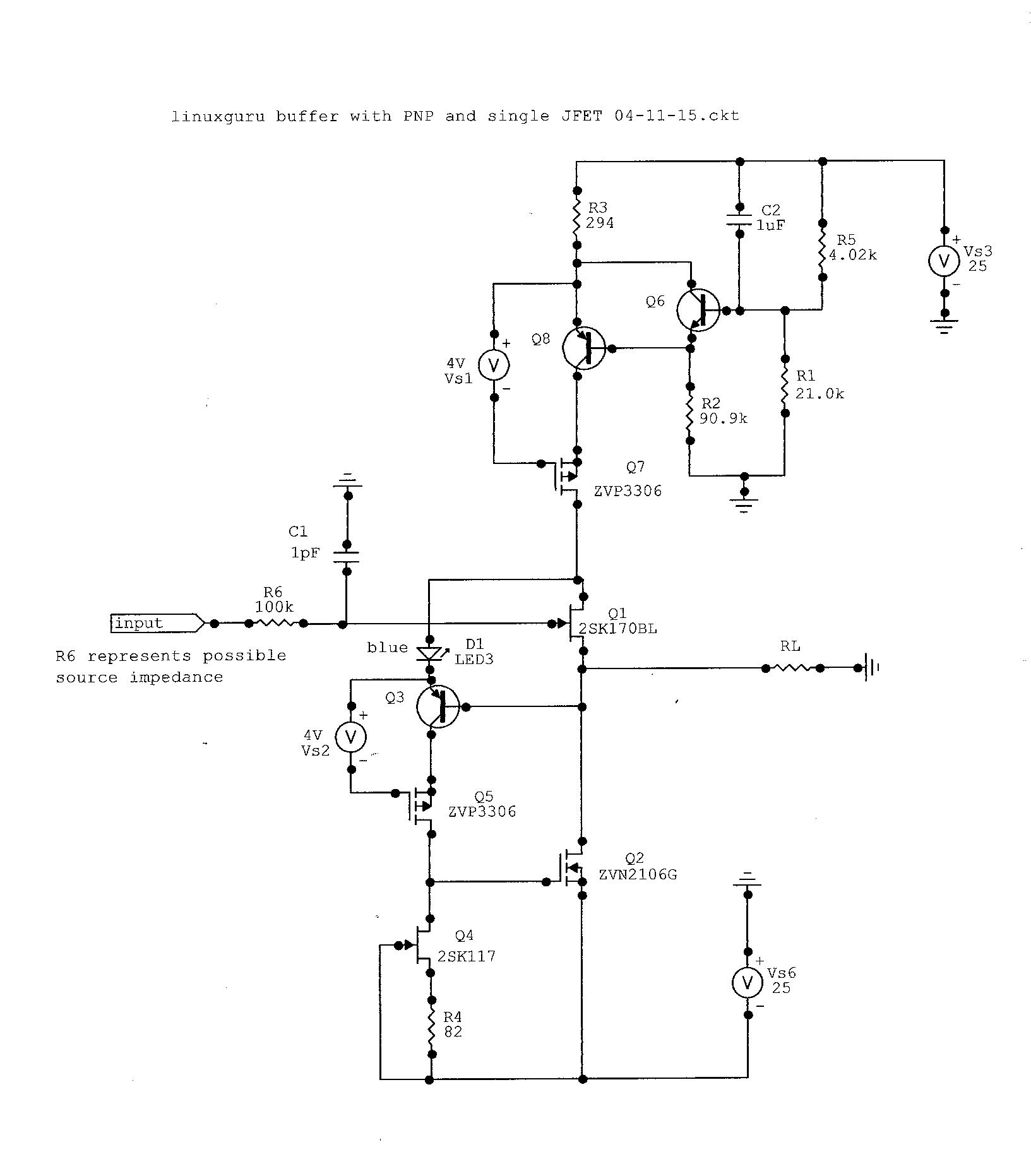

schematic
Here is a schematic for a buffer that can drive up to the Idss of Q1, in this case about 10mA. A little less heroic than the paralleled BF862s but still excellent performance predicted---and a lot easier to breadboard.
Brad
There is an instability, a couple of oscillatory bursts of several cycles at about 900kHz, predicted for big overloads (20V peak, 40V p-p) in the positive half of the waveform near the peak, which is due to the Boxall-Aldridge-style current source instability. If the positive rail is raised to 30V and R1 to 26.1k it goes away. An unlikely input signal, but the fix seems robust.
What I was concerned about when I looked at the circuit: the possibility under fault conditions of exceeding the gate-source breakdown voltage of the ZVN2106, or other NMOS part there. It seems not to be an issue, but belt and suspenders caution would provide a small diode to a biased zener spacing off of the negative rail.
