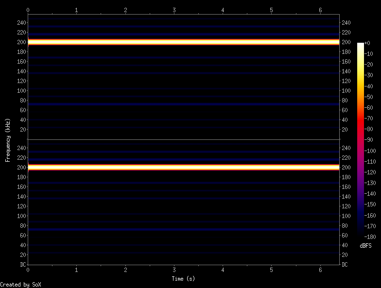

Testing the audio gadget with multiple-rates patch in win10 now. Foobar with wasapi-exclusive plugin switches the rates correctly with various samplerate files, even plays at non-standard rates such as 512kHz - attached spectrum of 200kHz tone at 512kHz/32bits. As Foobar internally works at float32, it looses full 32bit precision - hence the spectrum artefacts at -150dB.

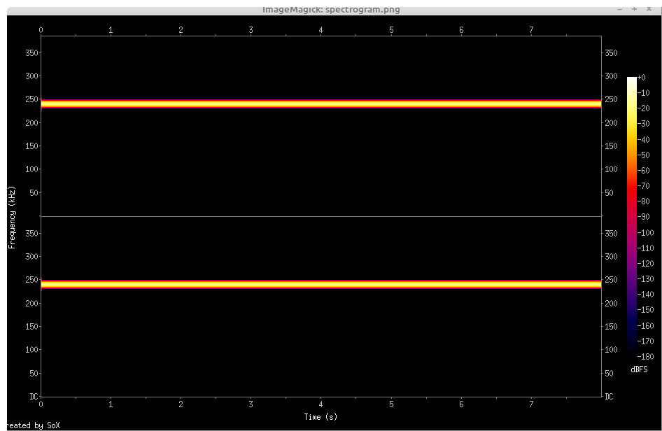

Using WASAPI exclusive mode in example code of Henrik's wasapi crate wasapi-rs/playsine_events.rs at master * HEnquist/wasapi-rs * GitHub - bitperfect 32bit playback of a 240kHz tone at 768kHz samplerate. Period time tested from reported minimum of 3ms up to 3s (which makes a VERY safe time margin for the application). The windows UAC2 driver seems to work quite good.

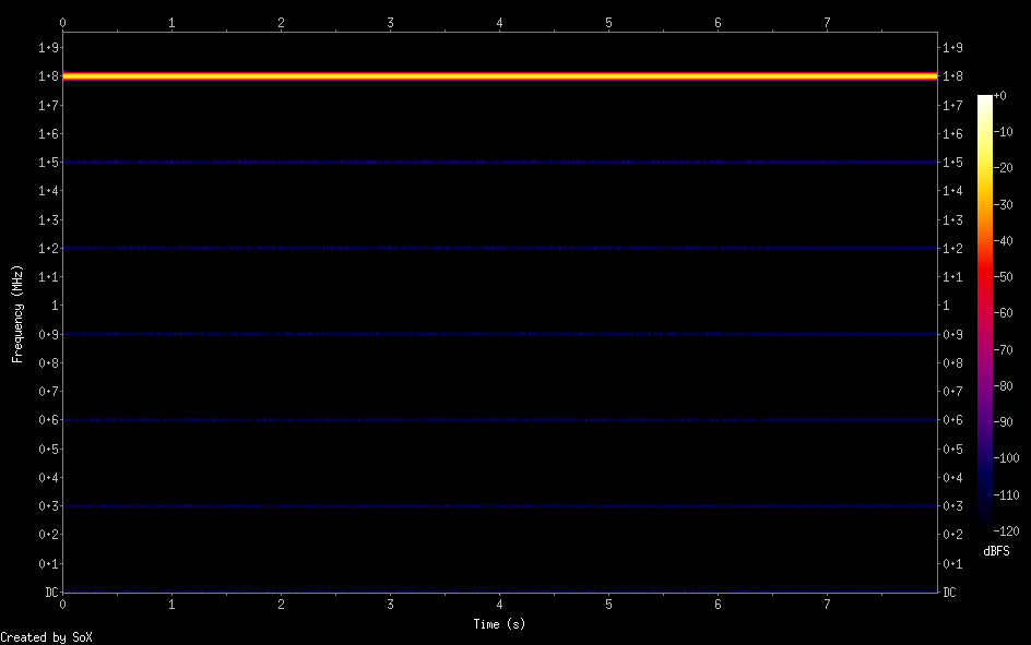

With kind help of Minas Harutyunyan from Synopsys (authors of the USB host-gadget IP dwc2 in the Broadcom SoC) I am now running both directions/duplex 64kHz/32bit/32channels bitperfect and no xruns between RPi4 and my linux workstation. The gadget sends/receives 1024 bytes of data every USB highspeed frame 125us (8MB/s in each direction) which is USB audio v.2 maximum achievable rate (1024bytes max packet size for one isochronous endpoint).
