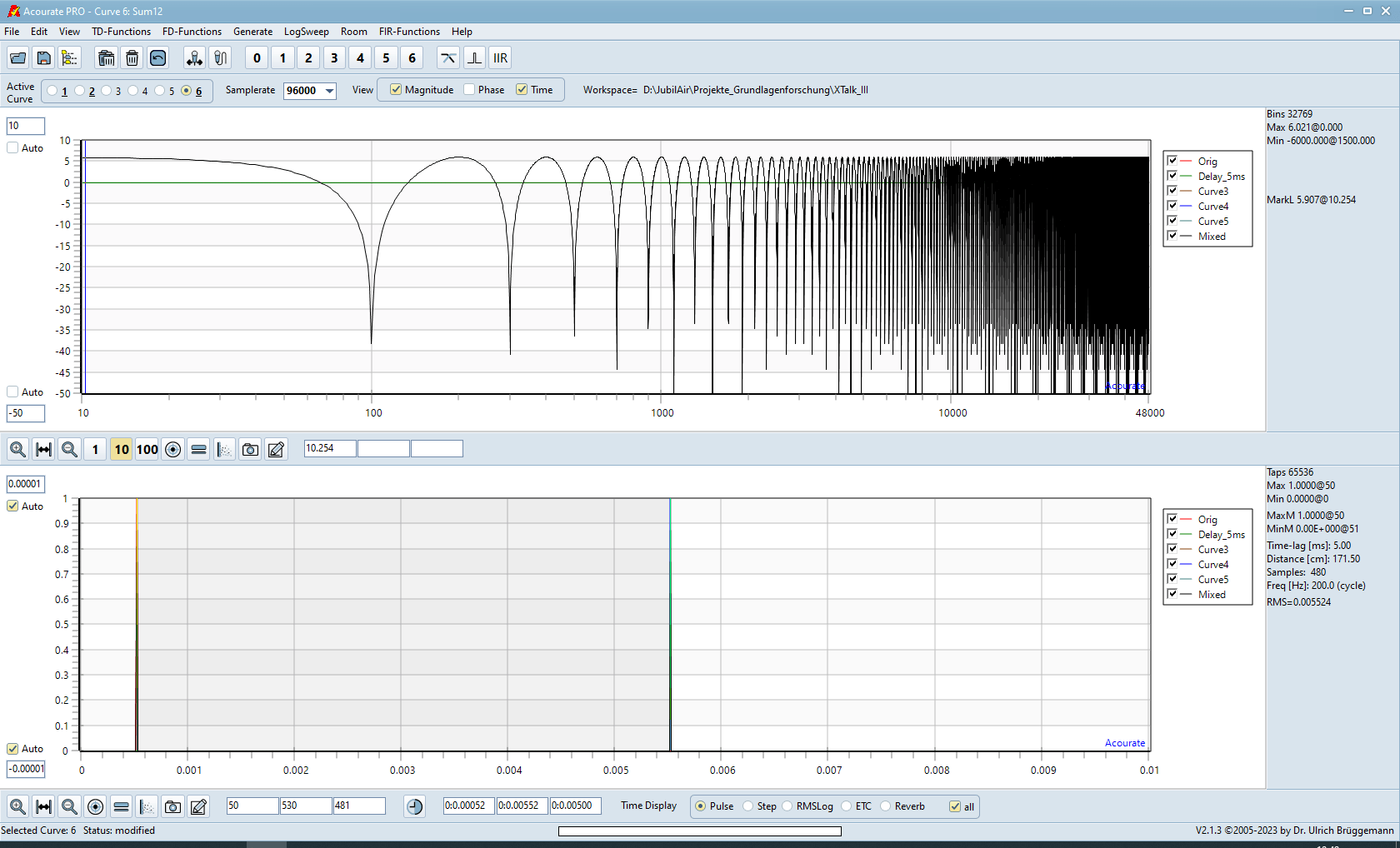

Already been done with clicks and timers. For two successive clicks I could discern 10ms, but not 5. For using delays when mixing music, short delays make the music sound comb-filtered. That perceptual effect starts to sound more like a distinct delay instead of a comb filter at around 20ms or longer. Delaying clicks is a different effect from delaying a mix of continuous frequencies. When someone is performing music, either type of effect may occur depending on the musical content.
This is a strong point when using an USB gadget as a dedicated dsp processor for feedback into a mixing host: You will get comb filtering.
