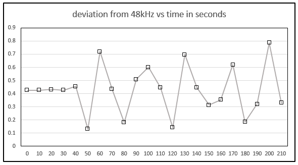

The first step accomplished. Hacked alsa-lib generates 10s averages of current throughput measured against system clock (nanosecs) in both directions, both for RW and MMAP access modes. In the end it was quite simple, hooking just in corresponding methods of the HW plugin alsa-lib/pcm_hw.c at master * alsa-project/alsa-lib * GitHub .
Values clearly hold for both directions (single clock), each soundcard is slightly different:
PCI Infrasonic Quartet - playback
PCI Infrasonic Quartet - capture
Intel HDA - playback
Intel HDA - capture
Clock difference is about 1.5 sample every second. This shows how reclocking using plain buffer is a technically incorrect solution - e.g. a 500ms buffer filled to half at the beginning would over/underflow in 4.5 hours.
Code:
MMAP: time: 7464.31, card = 3, device = 0, averaged samplerate: 48000.425255
MMAP: time: 7474.36, card = 3, device = 0, averaged samplerate: 48000.426115
MMAP: time: 7484.41, card = 3, device = 0, averaged samplerate: 48000.431125
MMAP: time: 7494.46, card = 3, device = 0, averaged samplerate: 48000.426516
MMAP: time: 7504.51, card = 3, device = 0, averaged samplerate: 48000.454509
MMAP: time: 7514.56, card = 3, device = 0, averaged samplerate: 48000.129543
MMAP: time: 7524.61, card = 3, device = 0, averaged samplerate: 48000.719691
MMAP: time: 7534.66, card = 3, device = 0, averaged samplerate: 48000.434230
MMAP: time: 7544.71, card = 3, device = 0, averaged samplerate: 48000.179946
MMAP: time: 7554.76, card = 3, device = 0, averaged samplerate: 48000.507986
MMAP: time: 7564.81, card = 3, device = 0, averaged samplerate: 48000.601536
MMAP: time: 7574.86, card = 3, device = 0, averaged samplerate: 48000.445306
MMAP: time: 7584.91, card = 3, device = 0, averaged samplerate: 48000.141746
MMAP: time: 7594.96, card = 3, device = 0, averaged samplerate: 48000.697811
MMAP: time: 7605.01, card = 3, device = 0, averaged samplerate: 48000.445344
MMAP: time: 7615.06, card = 3, device = 0, averaged samplerate: 48000.312700
MMAP: time: 7625.11, card = 3, device = 0, averaged samplerate: 48000.353650
MMAP: time: 7635.16, card = 3, device = 0, averaged samplerate: 48000.619305
MMAP: time: 7645.21, card = 3, device = 0, averaged samplerate: 48000.183977
MMAP: time: 7655.26, card = 3, device = 0, averaged samplerate: 48000.319778
MMAP: time: 7665.31, card = 3, device = 0, averaged samplerate: 48000.786663
MMAP: time: 7675.36, card = 3, device = 0, averaged samplerate: 48000.329274

It seems to me strange that the rate is changing up and down every 10 seconds. This does not correspond to what I would expect for a clock! The rate should be very steady, but each clock will not be exactly the same as the next one. As an example I have plotted the first set of data as the deviation from 48kHz vs time (see attached figure). You can see that the long-time average is very close to 0.425, however, the value reported each 10 seconds is quite different.
Only at "startup" when the clock info must be built from scratch would info on the timescale of a few seconds be useful. You might consider starting there and then building up better estimates of the the clock rate difference that is averaged over a period of several minutes, and then not doing 100% correction on the error. This will prevent "whiplash" corrections to the rate.
There is no clock available to the OS. The precise soundcard clock is timing the DMA transfer. The soundcard/USB controller/anything doing DMA is instructed to throw an interrupt request when the reading/writing pointer reaches certain address/threshold so that the kernel -> alsa-lib -> application knows it should supply one or more periods of samples to the DMA buffer. The exact time at which this supply occurs is unimportant as long as enough data are always prepared in memory for the DMA reading/writing pointer to avoid xruns.

We do not need a very precise figure, the feedback loop will run continuously, trying to drive the rate difference between USB and output soundcard to zero every control cycle.
OK. I would not try to make it zero every cycle. Whether or not you have access to the clock(s) the data you presented is very noisy and you risk constantly overcorrecting. That was what I was trying to point out with my plot. Like you said, it would take a long time to create over/under runs, and that is really all you are trying to prevent. A subtle change is all that is (likely) needed.
Exactly, no intention of using these 10sec averages for exact calculation of the feedback action. They are for checking if the rate measurement actually works. Which it seems it does.
The control change will have further propagation delays. Various control algorithms (regulators) can be used - that is why I do all of this in userspace, experimenting in kernel is clumsy.
I will have to dust off the faint recollections of control systems, my masters major a few decades ago...
The alsa subsystem admin recommended asking the driver directly for current soundcard pointer and corresponding timestamp (method snd_pcm_hw_status alsa-lib/pcm_hw.c at master * alsa-project/alsa-lib * GitHub ). This method yields much lower variation in 10 sec averages:

Infrasonic Quartet:
These values are OK for further processing.
Intel HDA
Code:
time: 7110.17, card = 1, device = 0, averaged samplerate: 191995.605796
time: 7120.19, card = 1, device = 0, averaged samplerate: 191995.630191
time: 7130.22, card = 1, device = 0, averaged samplerate: 191995.736022
time: 7140.25, card = 1, device = 0, averaged samplerate: 191995.521832
time: 7150.27, card = 1, device = 0, averaged samplerate: 191995.666591
time: 7160.30, card = 1, device = 0, averaged samplerate: 191995.704428
time: 7170.33, card = 1, device = 0, averaged samplerate: 191995.512622
time: 7180.35, card = 1, device = 0, averaged samplerate: 191995.711321
time: 7190.38, card = 1, device = 0, averaged samplerate: 191995.697803
time: 7200.41, card = 1, device = 0, averaged samplerate: 191995.658741
time: 7210.44, card = 1, device = 0, averaged samplerate: 191995.403172
time: 7220.46, card = 1, device = 0, averaged samplerate: 191995.795381
time: 7230.49, card = 1, device = 0, averaged samplerate: 191995.691082
time: 7240.52, card = 1, device = 0, averaged samplerate: 191995.590803
time: 7250.54, card = 1, device = 0, averaged samplerate: 191995.688861
Infrasonic Quartet:
Code:
time: 7077.50, card = 3, device = 0, averaged samplerate: 192001.549402
time: 7087.50, card = 3, device = 0, averaged samplerate: 192001.413235
time: 7097.60, card = 3, device = 0, averaged samplerate: 192001.553629
time: 7107.60, card = 3, device = 0, averaged samplerate: 192001.383925
time: 7117.70, card = 3, device = 0, averaged samplerate: 192001.476731
time: 7127.70, card = 3, device = 0, averaged samplerate: 192001.603120
time: 7137.80, card = 3, device = 0, averaged samplerate: 192001.598430
time: 7147.79, card = 3, device = 0, averaged samplerate: 192001.716339
time: 7157.90, card = 3, device = 0, averaged samplerate: 192001.446606
time: 7167.90, card = 3, device = 0, averaged samplerate: 192001.477986
time: 7177.99, card = 3, device = 0, averaged samplerate: 192001.509265
time: 7187.99, card = 3, device = 0, averaged samplerate: 192001.524726
time: 7198.09, card = 3, device = 0, averaged samplerate: 192001.621344
time: 7208.09, card = 3, device = 0, averaged samplerate: 192001.662404
time: 7218.09, card = 3, device = 0, averaged samplerate: 192001.721233
time: 7228.19, card = 3, device = 0, averaged samplerate: 192001.310009
time: 7238.19, card = 3, device = 0, averaged samplerate: 192001.436610
time: 7248.29, card = 3, device = 0, averaged samplerate: 192001.639014
time: 7258.29, card = 3, device = 0, averaged samplerate: 192001.644186
