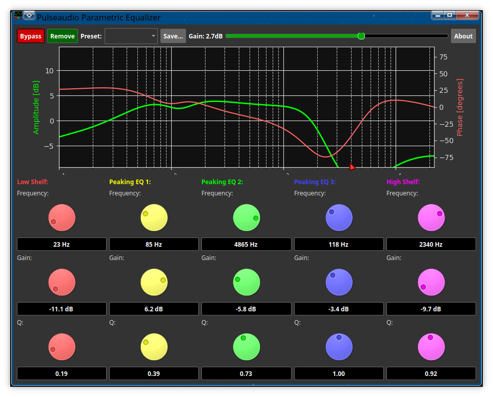

Recent editions include fixing the Pulse Audio EQ system to work again that hasn't worked since 14.04.
I have installed at this time the Pulse Audio Parametric EQ and it works fantastic it can be found here should you want to give it a try.
Pulseaudio Parametric Equalizer :: T5! DIY Audio Software & Hardware
I had the Pulse Audio Crossover app found in these threads installed once but never used it.
