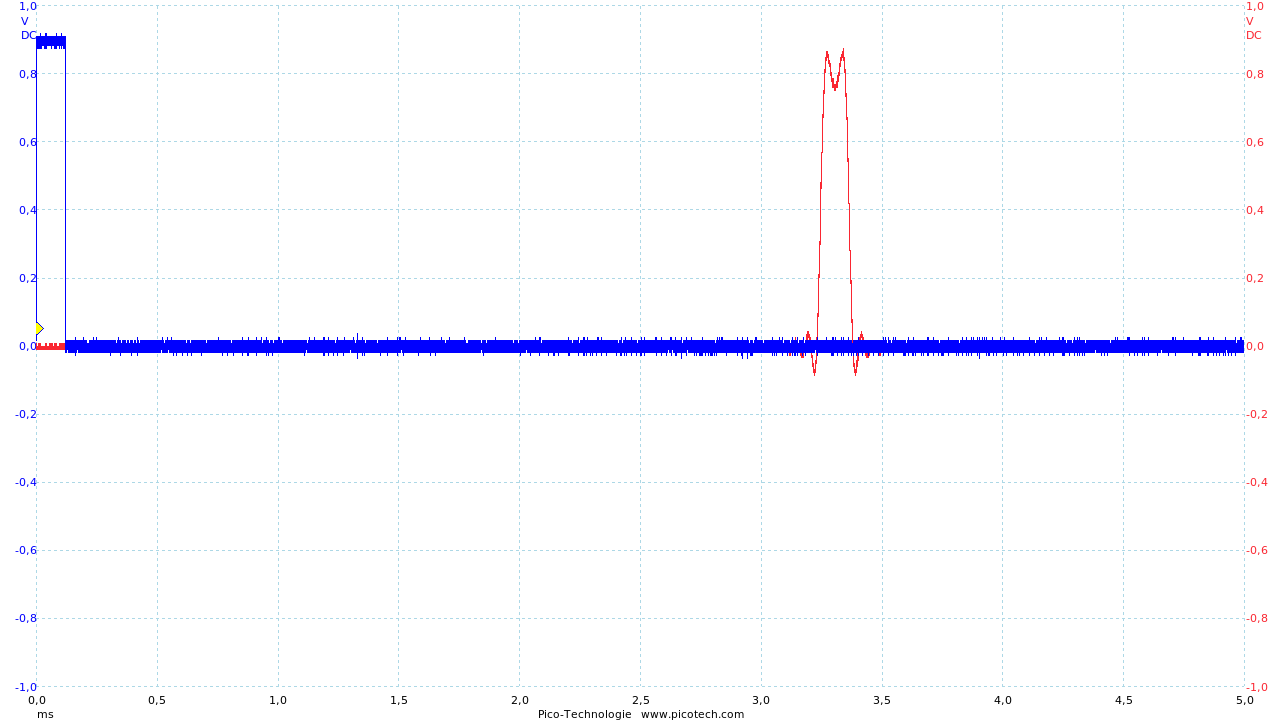

If we talk about low latency, we refer to round trip time when feeding analog in and immediately returning it to the output at the smallest buffer size possible. Of course that time would vary by adapting buffer sizes needed by whatever filters / audio apps one would create with this. For us the application as a "real-time" multi-channel audio efx box was interesting or a synth app, which has low enough latency to be played by a musician. 10ms are probably good enough for that. Attached a graph of the roundtrip experiment with the smallest possible buffer size of 34 frames at <4ms, we were able to achieve.
