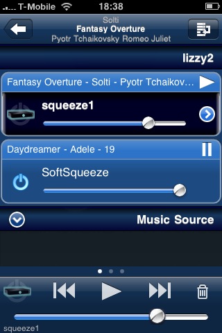

Hi folks.
I figured out a new thing. "squeezeslave" a virtual squeezeclient.
That one lets your PC run as virtual squeezebox receiver (great for FitPc headless) and overall audio control of your (audio)-PCs
SqueezeSlave - SqueezeboxWiki
( Linux build instructions are OK)
Start command - example:
Code:
./squeezeslave -k20 -esoftsqueeze3 -M"/var/log/squeeze.log" -o0 192.XXX.0.XXX
Type ./squeezeslave -L to find out the alsa-interface value for the -o option.
See attached picture which shows the two clients ( on SBR and one squeezeslave) on iPeng.
