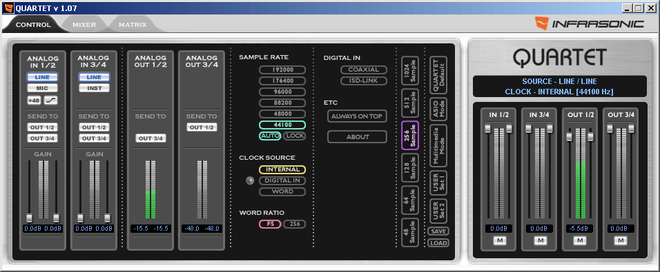

That is what I'm pursuing. On the computer part, I'm using an Infrasonic Quartet (not modded yet), which is excellent and most important, has a wordclock input.
I was going to ask in this thread if there are already linux drivers, IIRC they were working on them.
Infrasonic Quartet is a nice card indeed. Since the card's manufacturer SIMS Corp. is interested in full linux support, they helpfully provided me with a sample and some key information. I am working on the alsa driver, it will take a few days though :) And good to have someone around to test the result :)

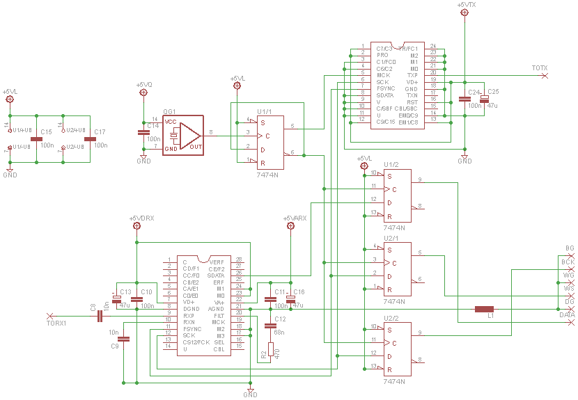

Just about any decent (full-duplex) card which have at least one S/PDIF input (including my Juli@, of course... ) can be synchronized to it. All you need to do is to embed your DAC local clock into a dummy s/pdif stream and sent that back to the sound card input. You lock the card to it and bingo!, your output stream is locked to the local clock on your DAC. Just open up the connection between the s/pdif receiver reconstructed clock and your DAC (connect it directly to the local clock) and you're done. In principle it's trivial...
it's what i did with my TerraTec Aureon 7.1 Space (Envy24HT based) and the attached circuit. I build a prototype of this circuit on perfoboard using 78l05 for any +5V* point in the schematic and toslink input output. The cs8402 (in mode 0) generate a blank spdif signal to sync the audio board and the right FSYNC and SCK to feed the cs8414 (slave in mode 3). The cs8414 receive the spdif signal from the audio board and output i2s. This i2s is then reclocked from the same clock that control the cs8402.
From alsamixer i choose IEC958 Input as the source for the 'Multi Track Internal Clock'.
It works.
Ciao
Andrea

Just about any decent (full-duplex) card which have at least one S/PDIF input (including my Juli@, of course... :cannotbe: ) can be synchronized to it. All you need to do is to embed your DAC local clock into a dummy s/pdif stream and sent that back to the sound card input. You lock the card to it and bingo!, your output stream is locked to the local clock on your DAC. Just open up the connection between the s/pdif receiver reconstructed clock and your DAC (connect it directly to the local clock) and you're done.
Yes, you are correct of course.
But since the Quartet costs the same as the Juli@ (in Italy) and I like simple things... ;)
Also, I dunno how simple is in the DAC to have a spdif out. I will get the wordclock out from the master clock.
PS: I'm talking about a DAC without without spdif altogether :D

How does these drivers look? ;)
