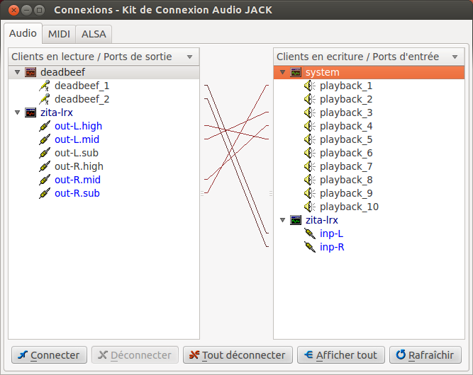

Just received my 1010LT card last week and i've done few tests, results seems promissing. I'm using zita-lrx to cross my sub at 90hz in a 2.1 configuration. Just to get an idea of the product see below the jack connection from example1.zlr file configuration wich is part of the module.
