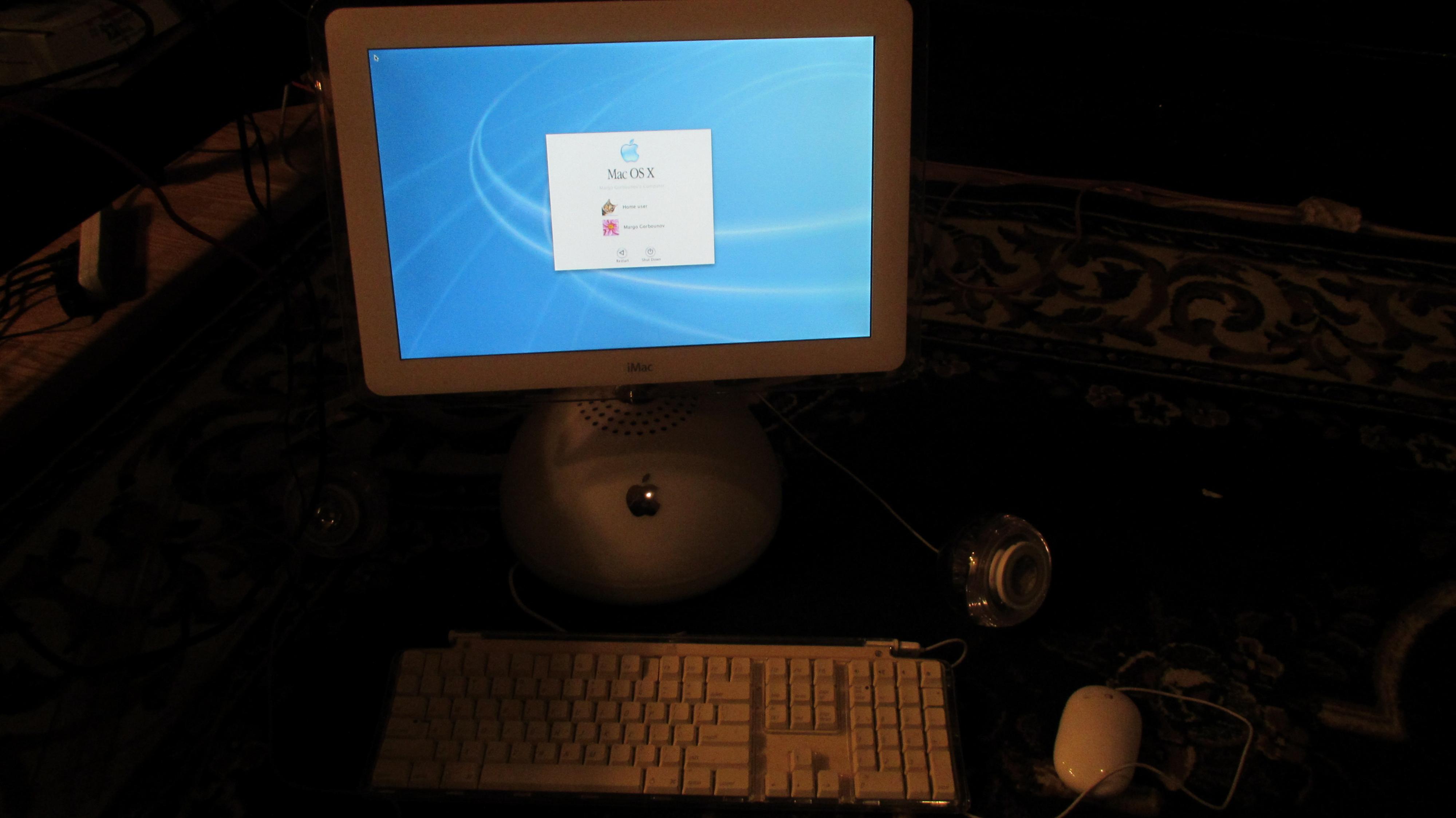

Thanks, I read it already. The problem is, when I power it on and hold C key it ignores it and boots into the Mac OS X.
What if to replace the hard drive, so it can't find OS? Will it boot from CD then?
Are you holding down the C key when you hit the power button or after you hit the power button?
This link suggests holding down the C key before hitting the power button.
Also, have you updated your iMac to the latest firmware?
