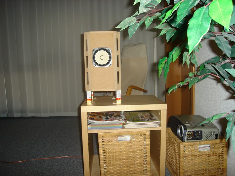

I take a total differnt aproach when it comes to silent PC.
I bought a Thermaltake Sonic Tower cooler that cooles my 6300 core2duo.
Instead of trying to sounddeaden the case I leave it open. My grafic card is also passively cooled. In the power supply I put a Papst fan that is sonically not detectable from 2 feet away. The case is a horizotal one and i put it in an IKEA Roll-container that is in front and back open and has a divider board that can be adjusted in the hight.
I adjust the computer in the hight so that it has 4 inches to the top to breath. Underneth I can put the rest of my audio equipment. I can roll it around to different locations and the neat thing is, if I have to do anything on the Computer I slide it back a bit and it lies bare before me. In an audio computer you want as less metal as possible to not reflect RFI. Especialy if you have a modded internal soundcard as I do. And that is the bigger motivation for me to go fanless if possible because fans are RFI generators. My camear broke the other day, so I can't show you the Roll-container with the computer in it, but you can see it as a speaker stand in the pic I attached.
Greets,
KLaus
