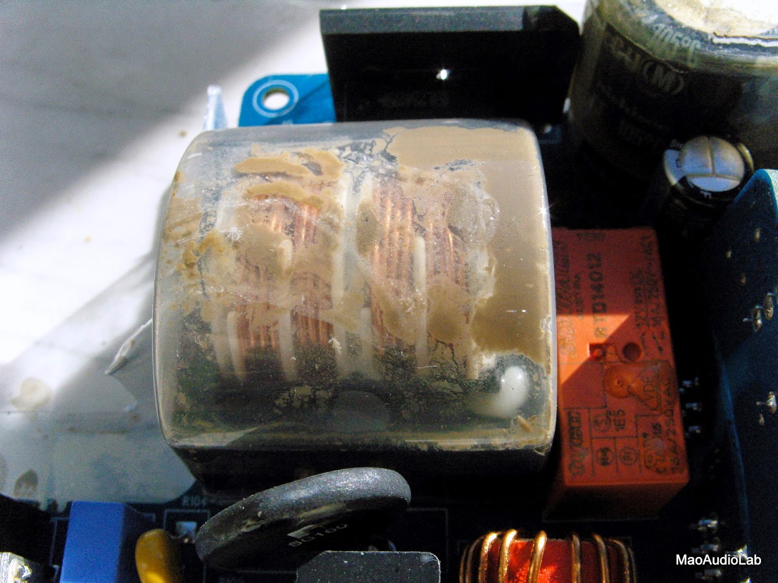

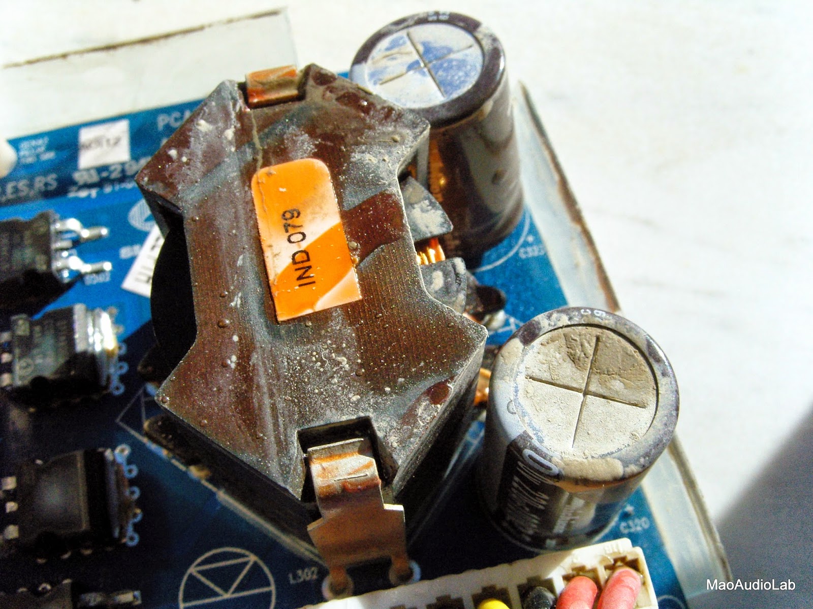

The main deficiencies are thermal stress and/or inferior parts (mainly bad caps, both in leaded and SMD version).

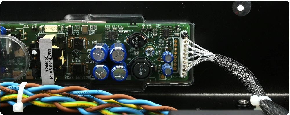

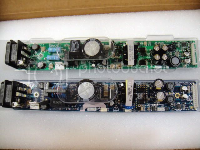

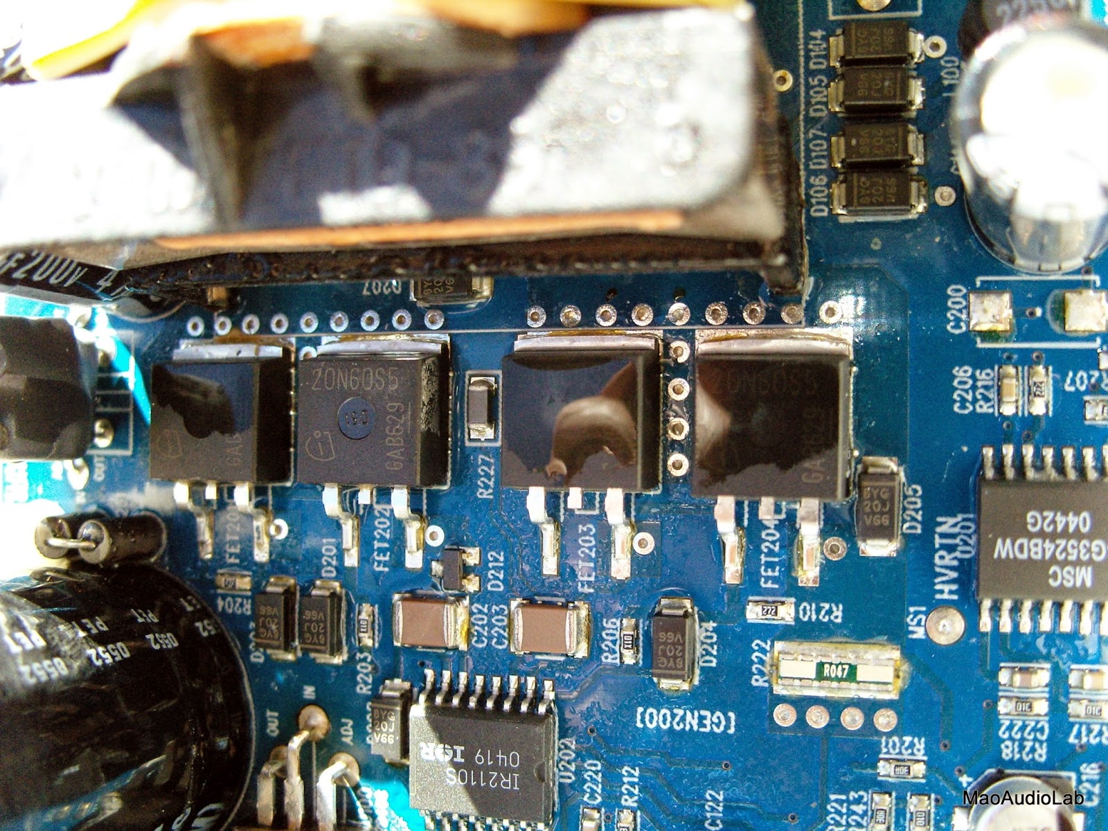

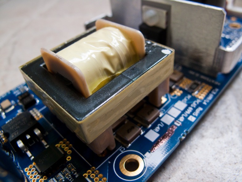

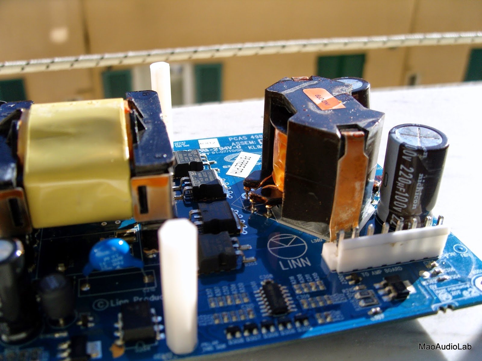

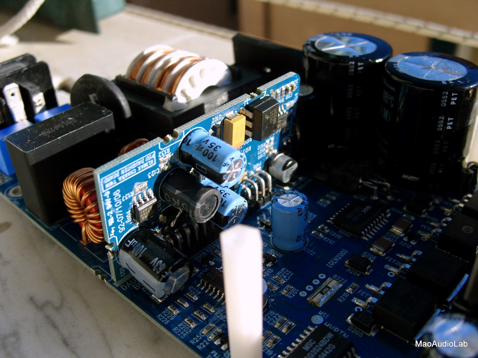

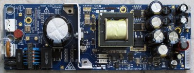

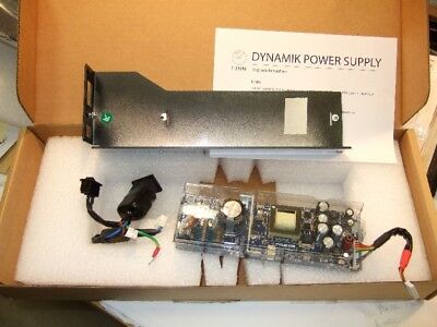

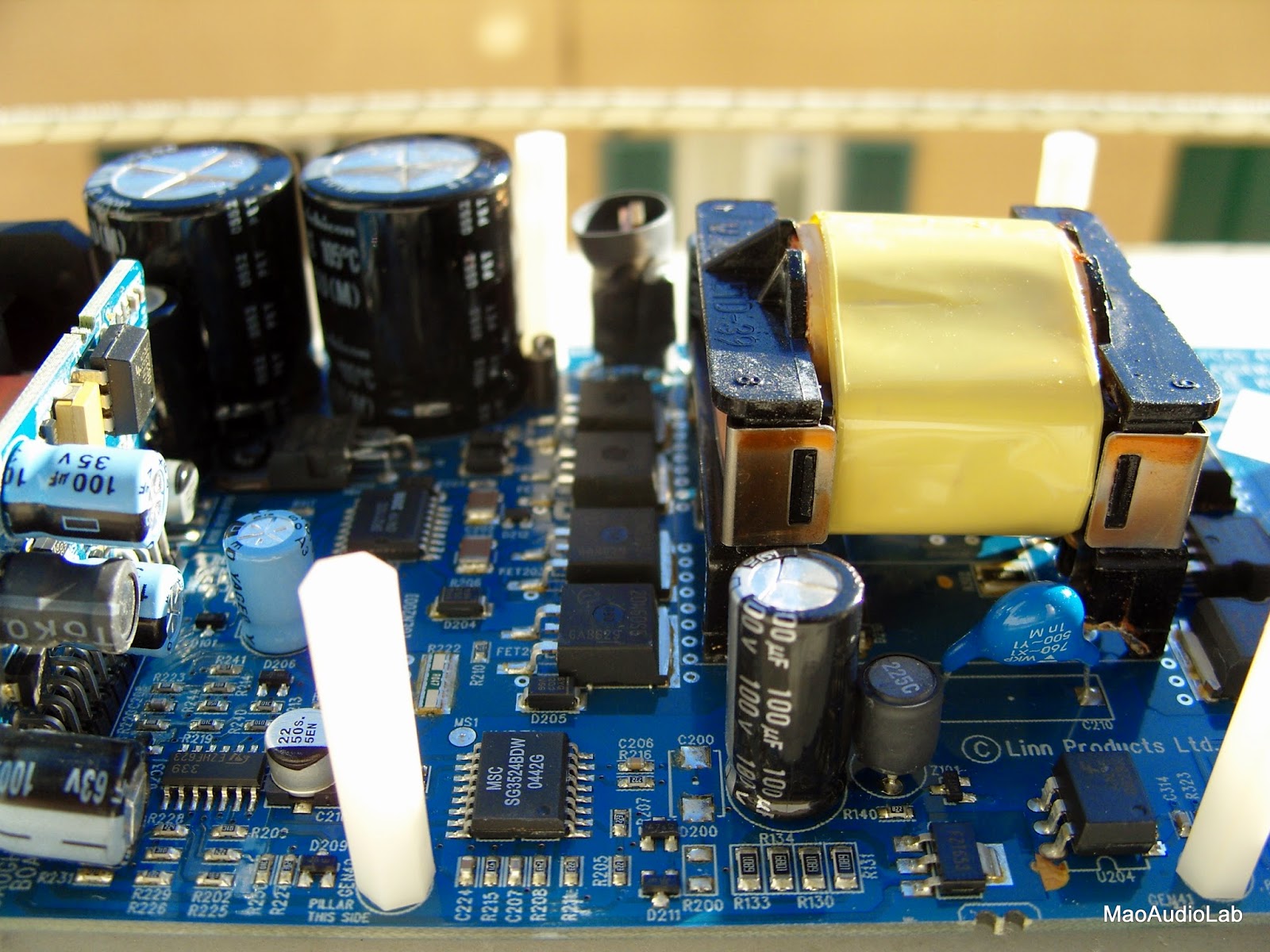

some images of various examples

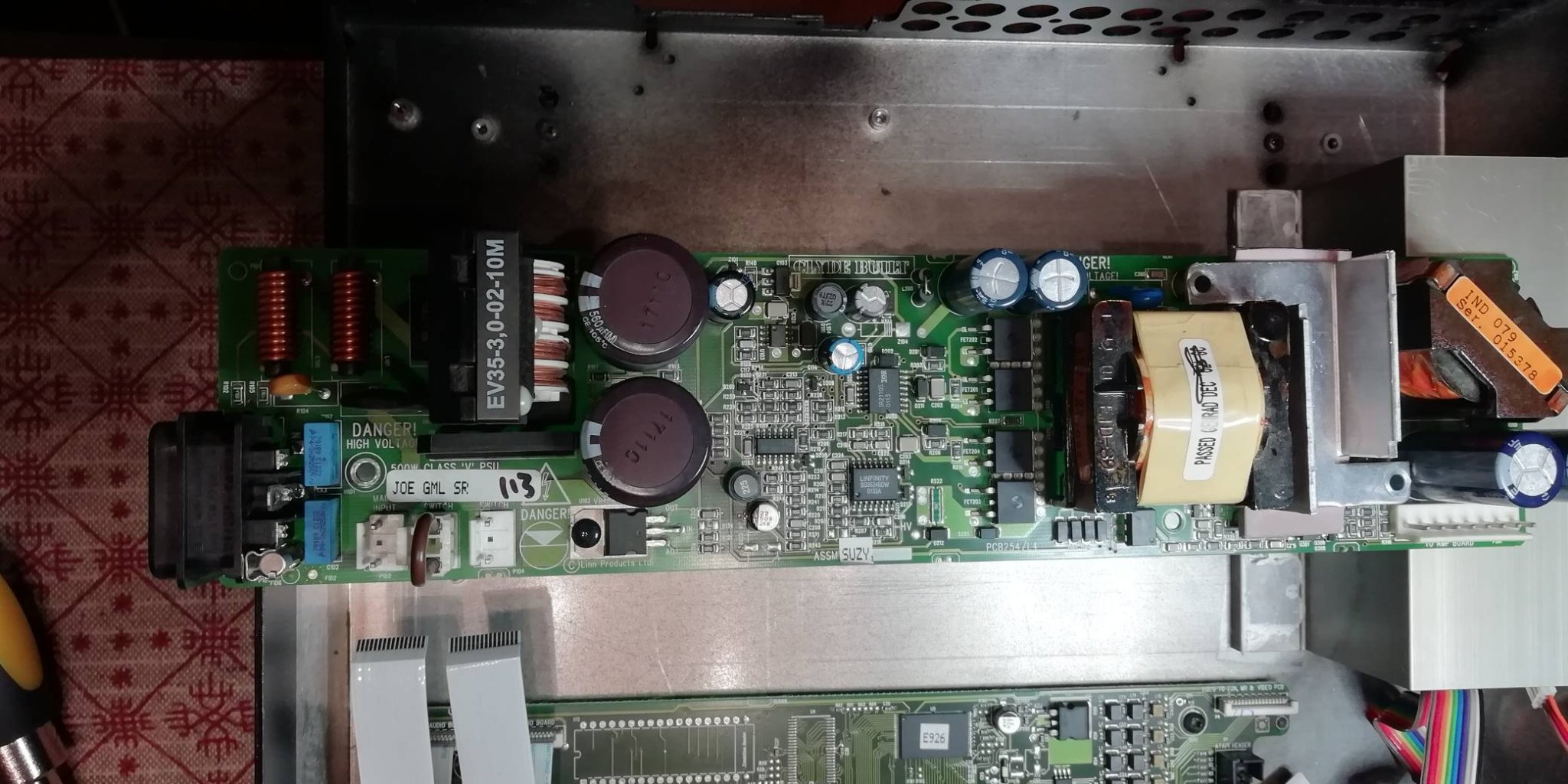

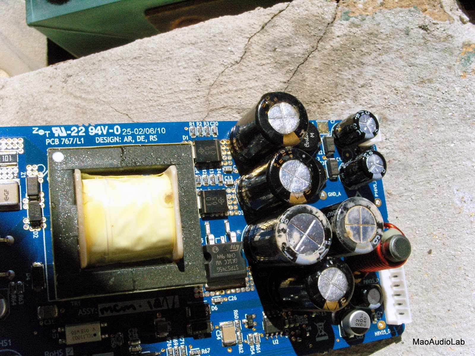

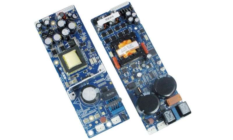

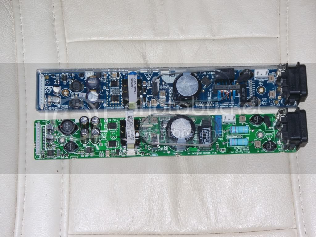

more pics

Most seem like flybacks the long board with the mains connector is likely TOP278 based.
No need to reverse engineer those, the circuit is likely straight out of the datasheet.
First post shows IR2121? high/low side mosfet driver so thats a push/pull SMPS
