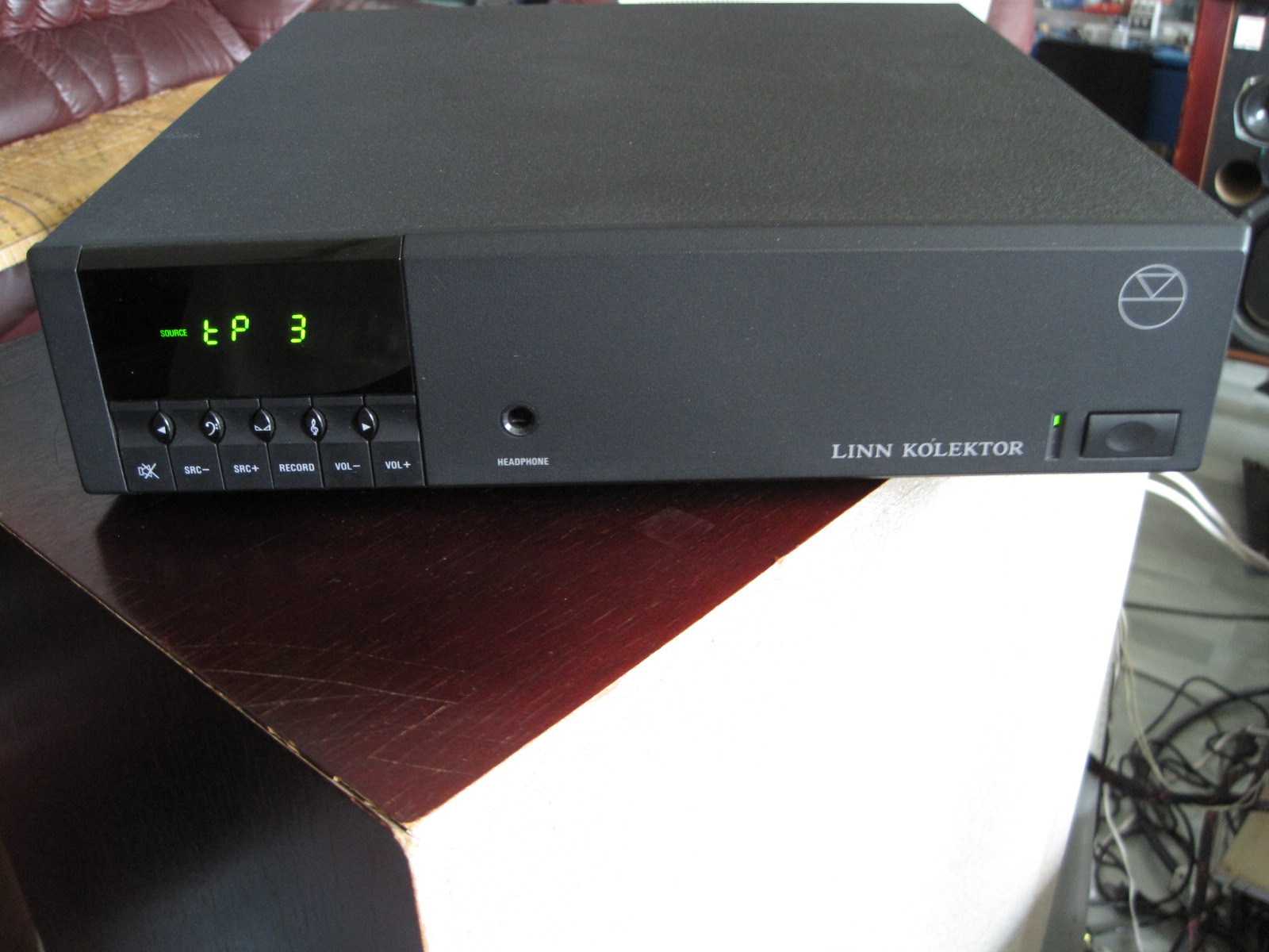

Linn Preamp Model "Kolektor" - Display shows "Err4" after Switch-ON: What means this?
On the web there are not many information concerning this preamp.
Even in the attached PDF files there are no advices.
A reset according the instructions provides not the wanted results.
Who can post advices ? - thank you.

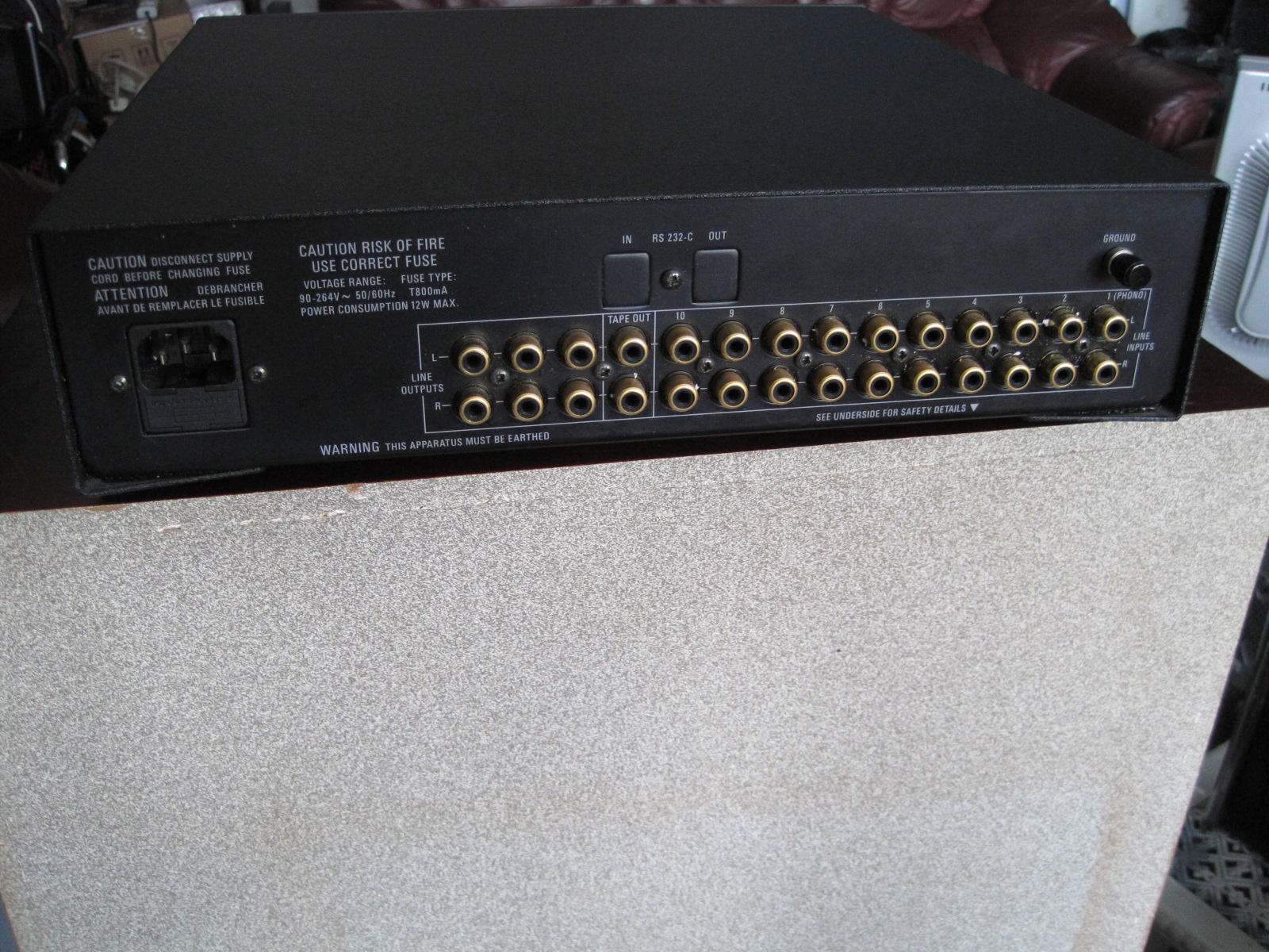

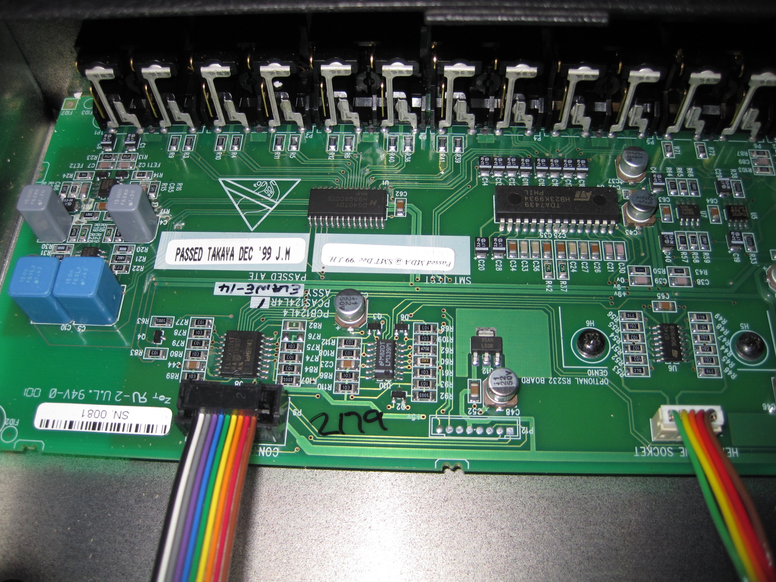

more pictures.

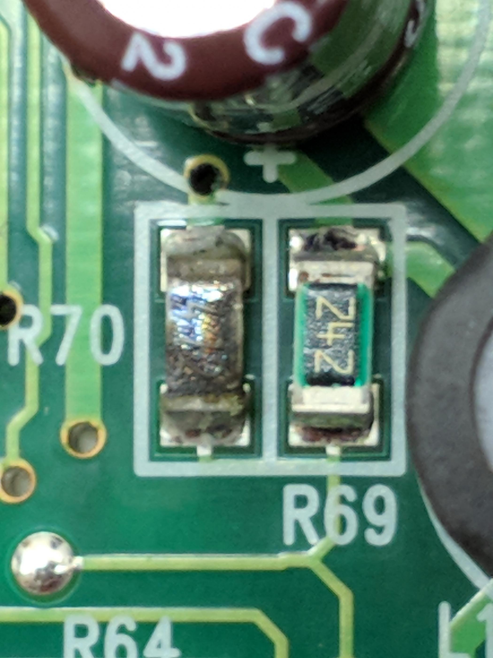

The burned R70 must actually be the main reason for the displayed message "Err4"
What is R70's job?

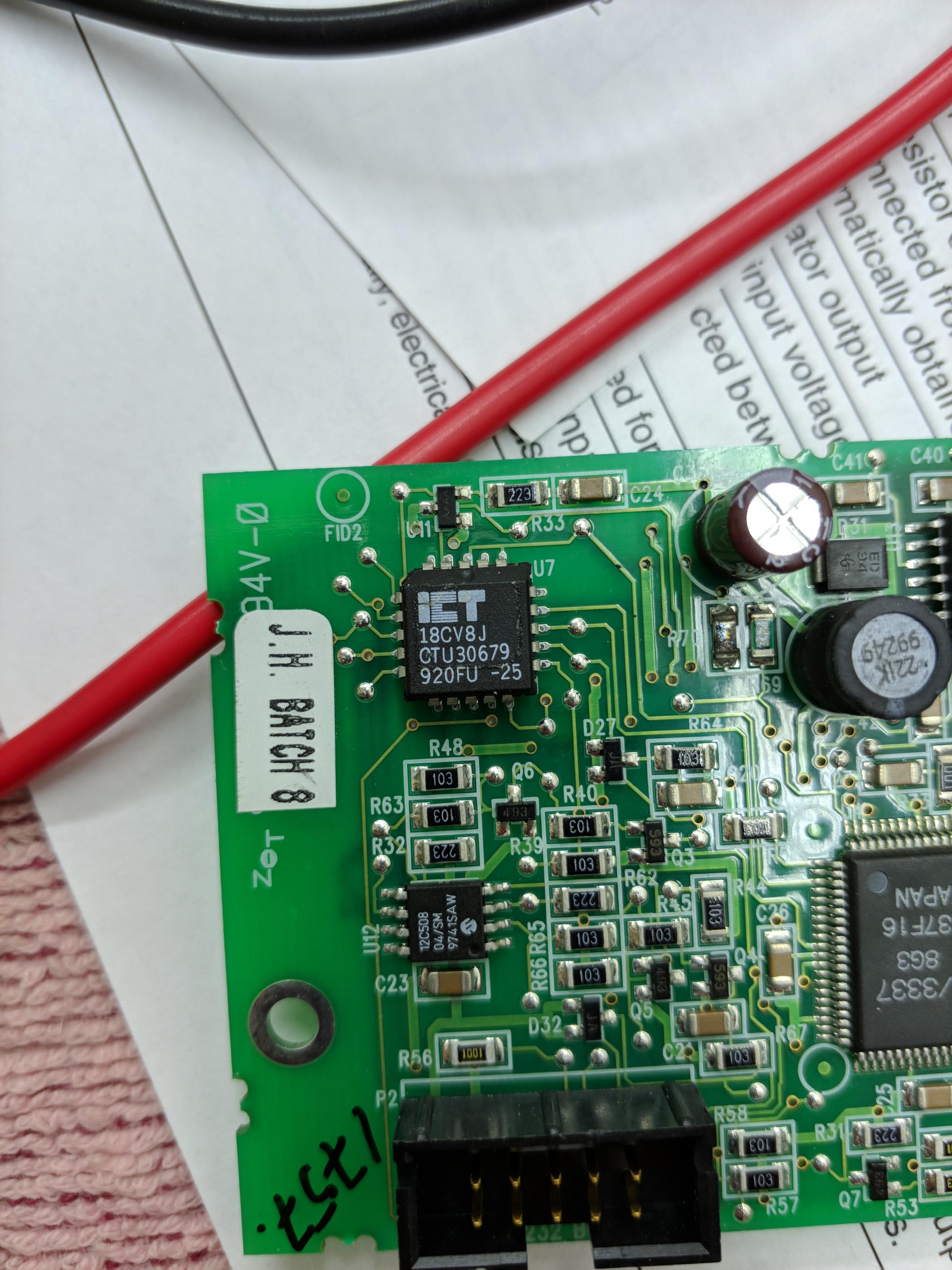

Maybe the "18CV8" (CMOS Programmable Electrically Erasable Logic Device) is damaged.

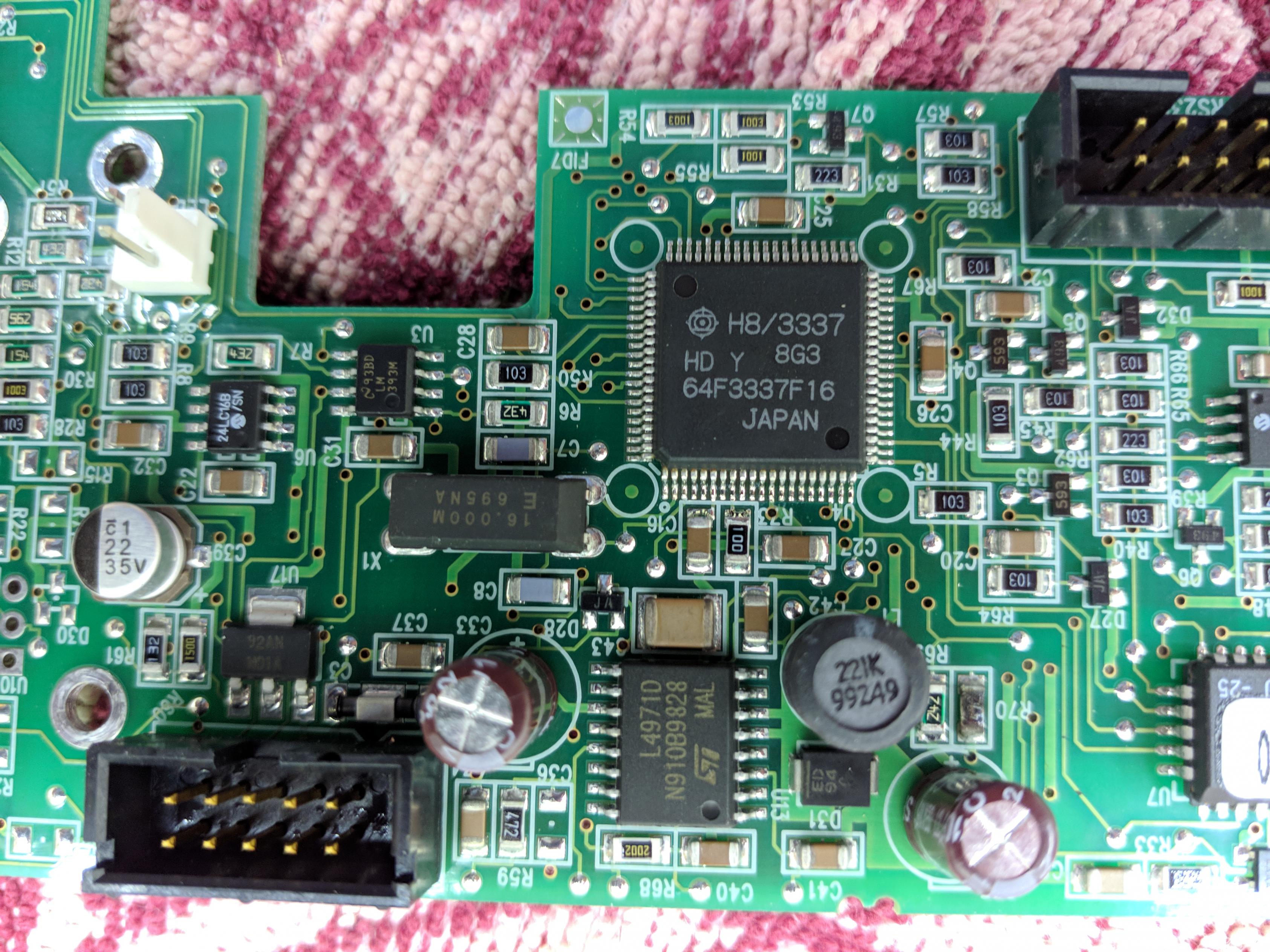

I solder a new L4971D: i now have a correct 5v in the H8/3337. But Error 3/4 is still here.
After some investigation, I see I have 9v on both SDA/SCL: it's coming from the TDA7439.
After desoldering of the TDA7439, I have 0v on SDA/SCL and the Kolektor boots without error and then 5 sec after, Error 7.
The TDA7439 is dead...
