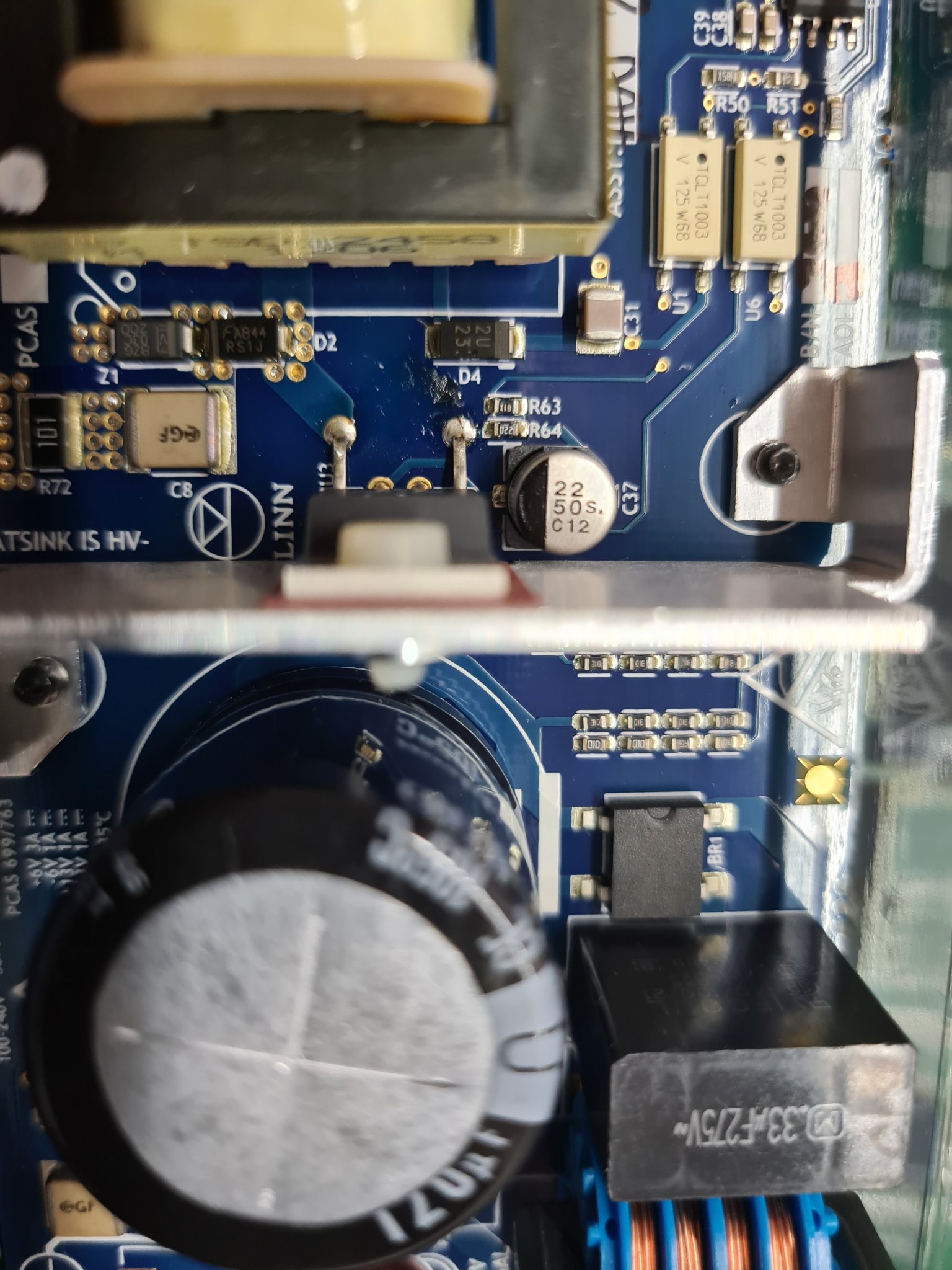

I have a Linn Majik DS with Dynamic PSU which was suddenly dead last Sunday. It produced only a low volume sparking noise when repowering but the display remained dark.
I found on the Internet that a cap in the power supply causes this error, see here.

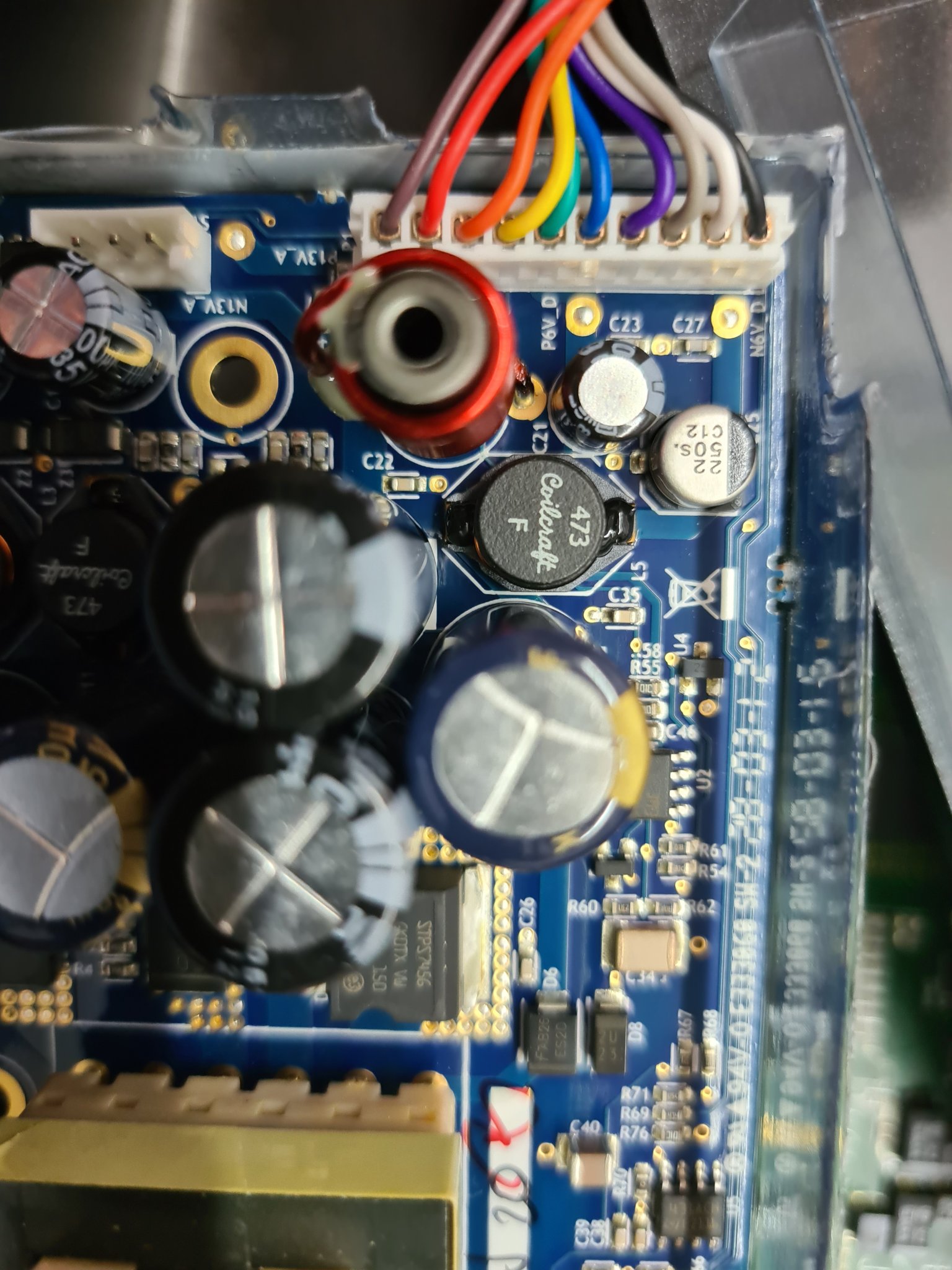

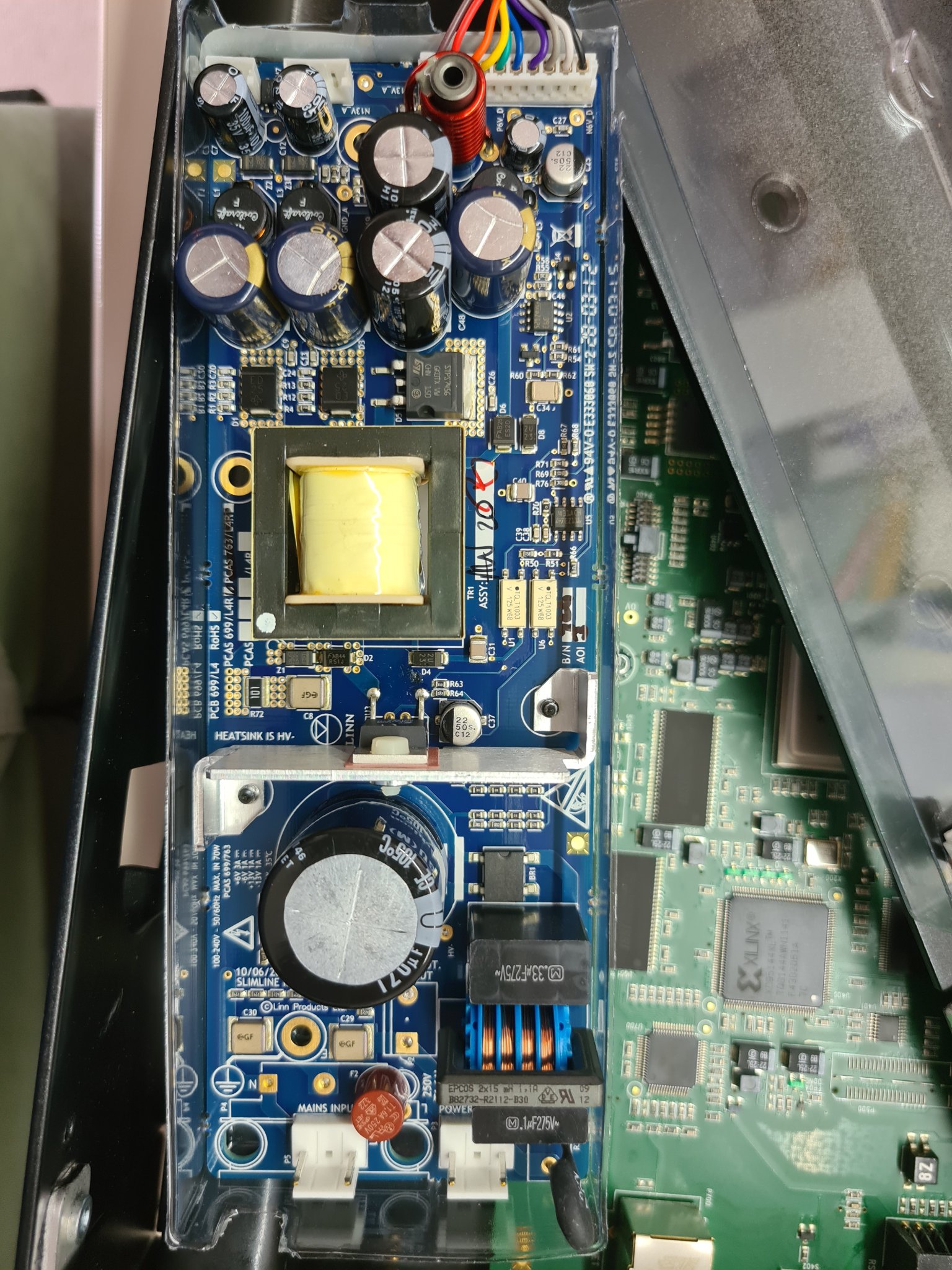

I opened my unit but unfortunately, I have a different PSU as seen below.
It has two of these suspicious caps but no obviously faulty element on the PCB.
Anyone out here knowing this problem and what component to replace?

After having the device disassembled for making the pictures posted the unit started as normal.
After a while (some days to weeks) it was dead again.
I disconnected from mains, waited a day or two and switched it on again - it is running as normal.
Guess it will be difficult to track down the fault. Any ideas?
I see you posted an additional pic of the area near D4. It looks like the power MOSFET has been ...worked on...? As the rest of the board was wave soldered and cleaned the goopy flux in that area is suspicious. I'd reflow the solder on that leg since you're already inside the unit.

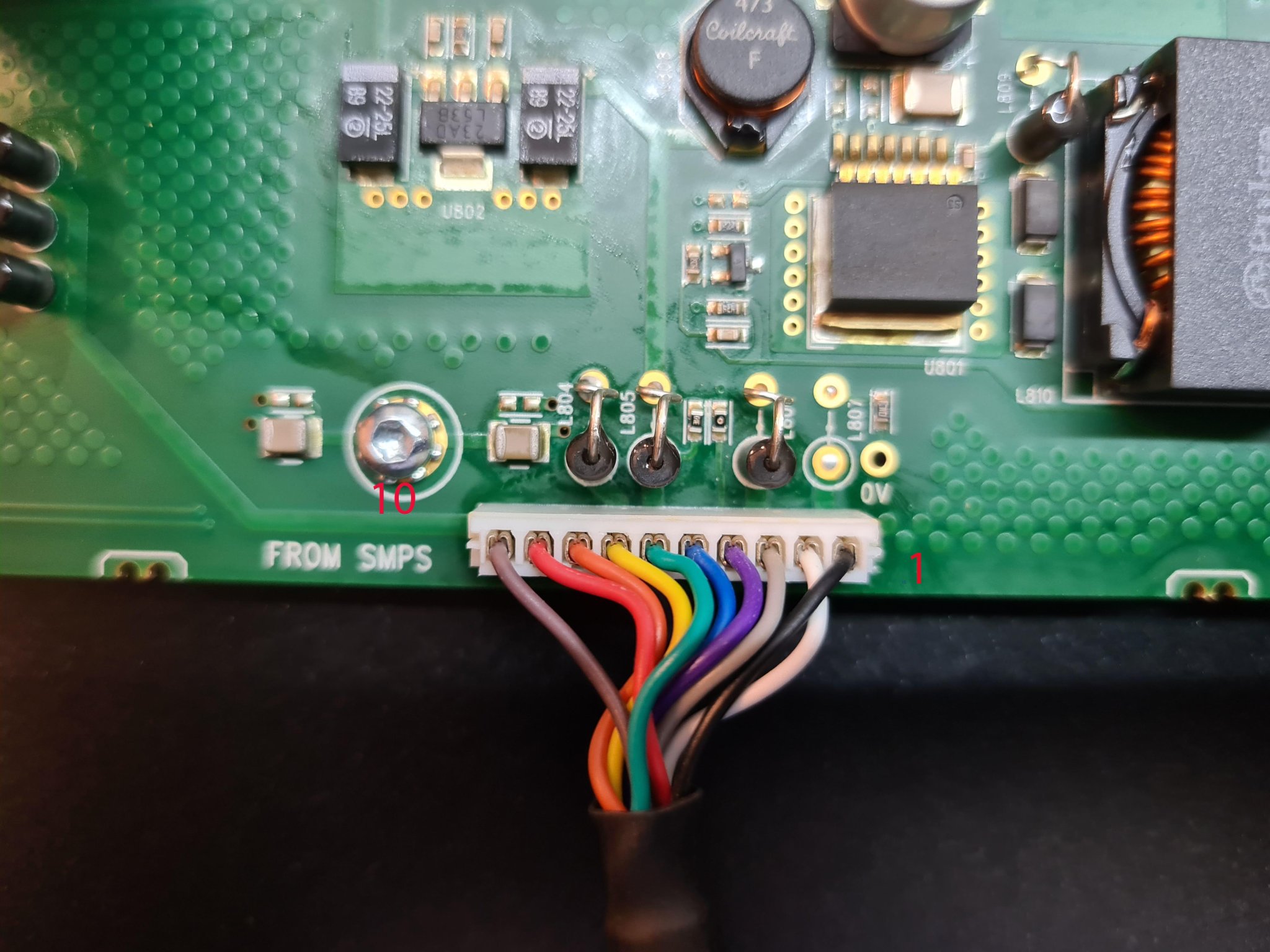

Thanks so far. I had little time over the summer and startet to track down the fault recently. As explained the unit is working fine after having been disconnected from mains for a while in working state, the output voltages are from right (1, black) to left (10, dark grey):Do you know power supply out cable colours voltages? Check output voltages, if you don't know, check out put capacitors voltages.
Be careful, primary power supply has high voltage capacitors and is conected to mains.
1: -11,2
2: 0
3: 0
4: -0,02
5: +6,38
6: +6,38
7: +0,06
8: -16,72
9: 0
10: +15,09
after some days on mains, the unit is dead. Voltages are
1: +9,88
2: 0
3: 0
4: 0
5: -0,02
6: -0,02
7: -0,01
8: +0,18
9: 0
10: -0,11
All voltages are measured against 0V close to pin 1 (black) of the connector. Hope this helps.
Yes, after having again a more thorough look onto the board, I noticed some debris close to D4, i.e. at the pins of the TOP246. It looks like a hard, transparent coating about 0,2 - 0,3 mm thick. On the bottom side is some debris as well, again at the pins of the TOP246.I see you posted an additional pic of the area near D4. It looks like the power MOSFET has been ...worked on...? As the rest of the board was wave soldered and cleaned the goopy flux in that area is suspicious. I'd reflow the solder on that leg since you're already inside the unit.
I got this unit pre-owned 8 years ago and do not know about earlier repairs.
If there are no better ideas, I will start replacing the 22/50 (C37/C27) + the 5 Nichicon caps and reflow the pins of the TOP246 with fresh solder.
