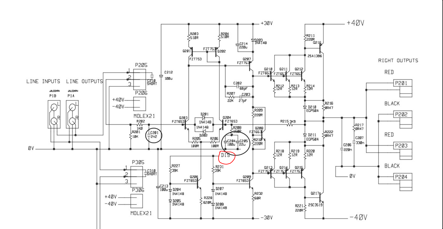

Working on a Linn lk100 and it seems to be stuck in protection..
The left channel had blown output transistors. Replaced them. Nothing else downstream seemed out of spec but yet no sound. Measuring at the DIS point shows me -30v which from what I read is the protect kicking in. I've removed the board and reflowed much of it but now I'm kinda stumped? All my rail voltages are good as well.
