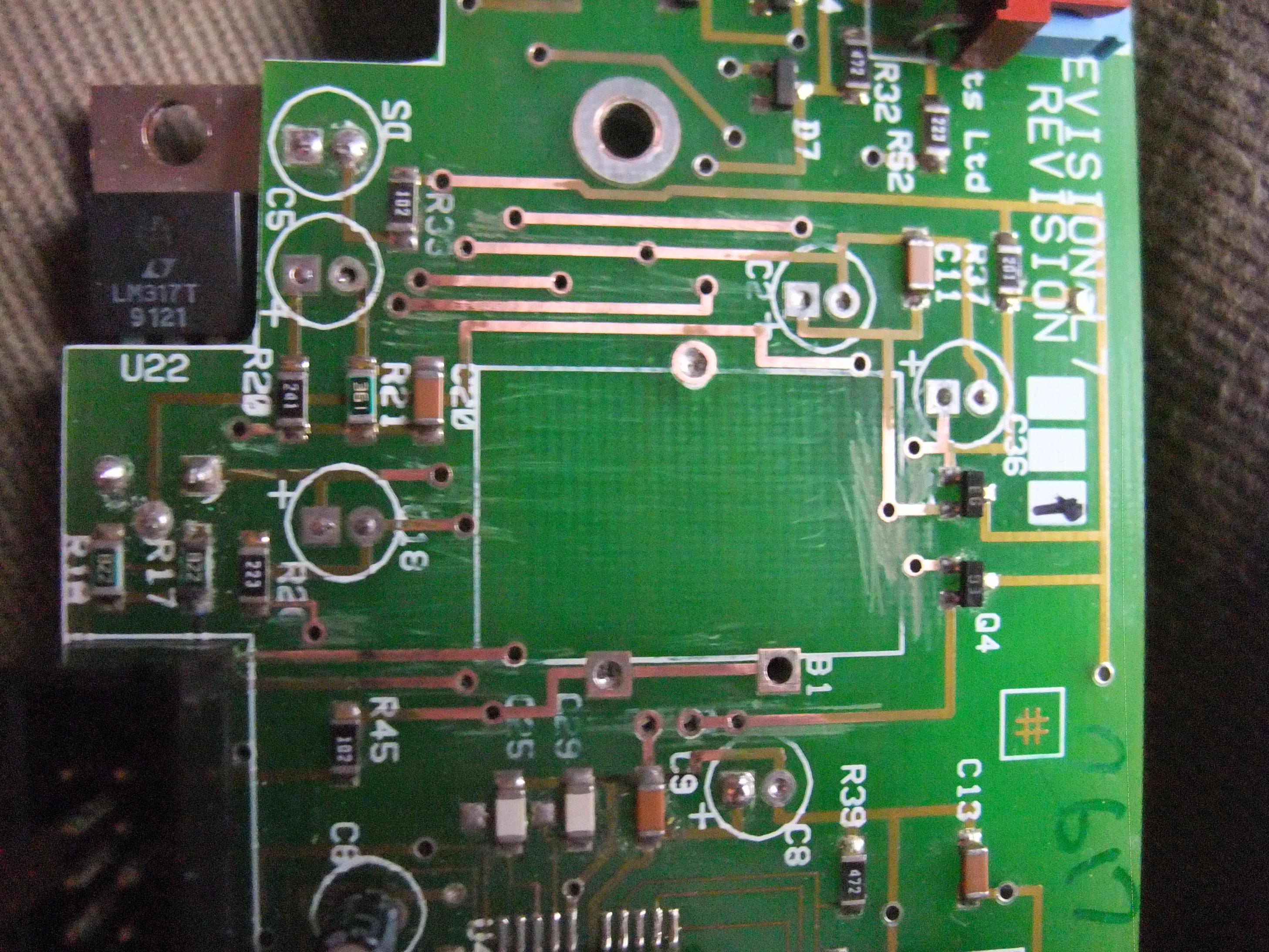

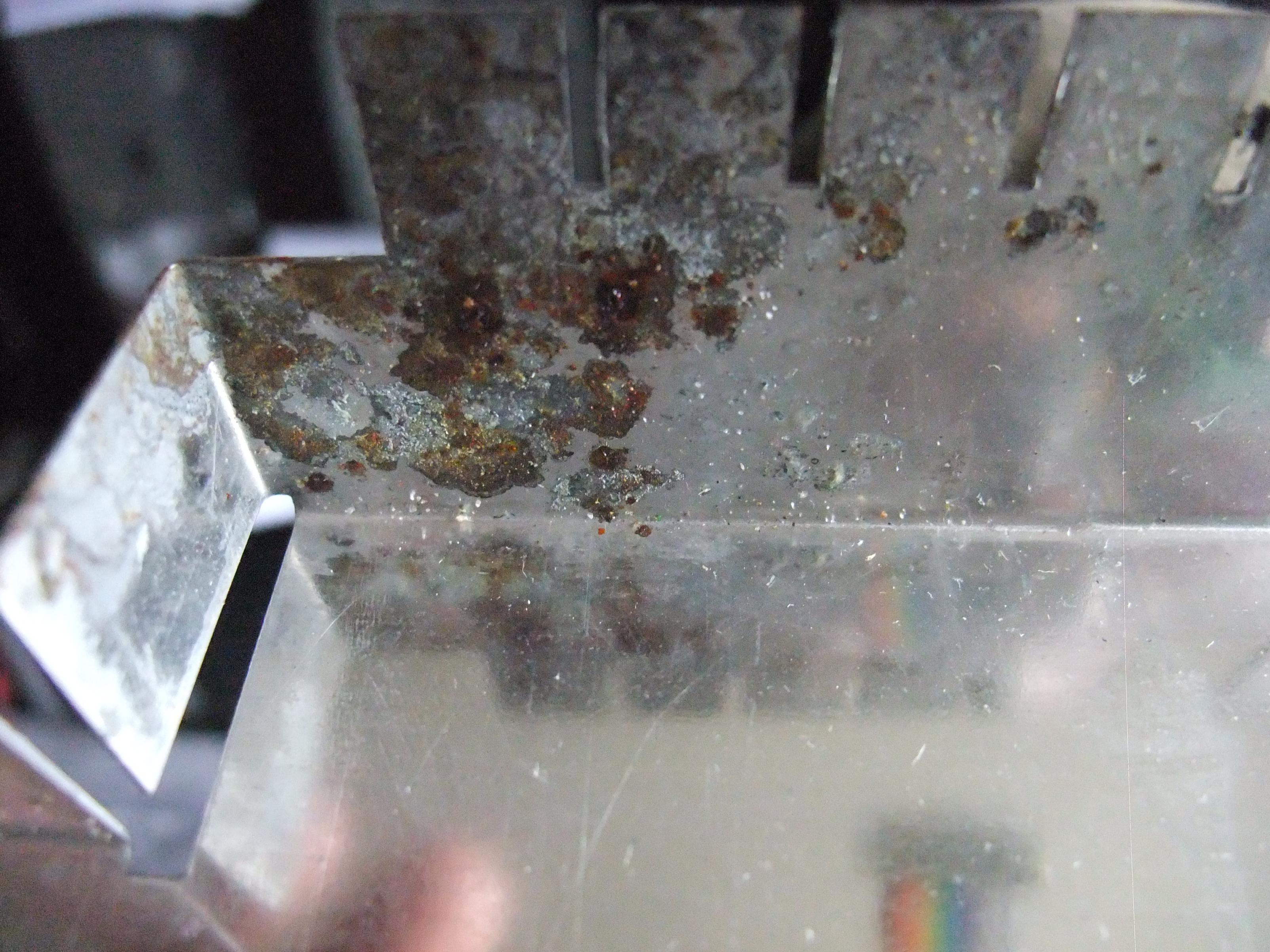

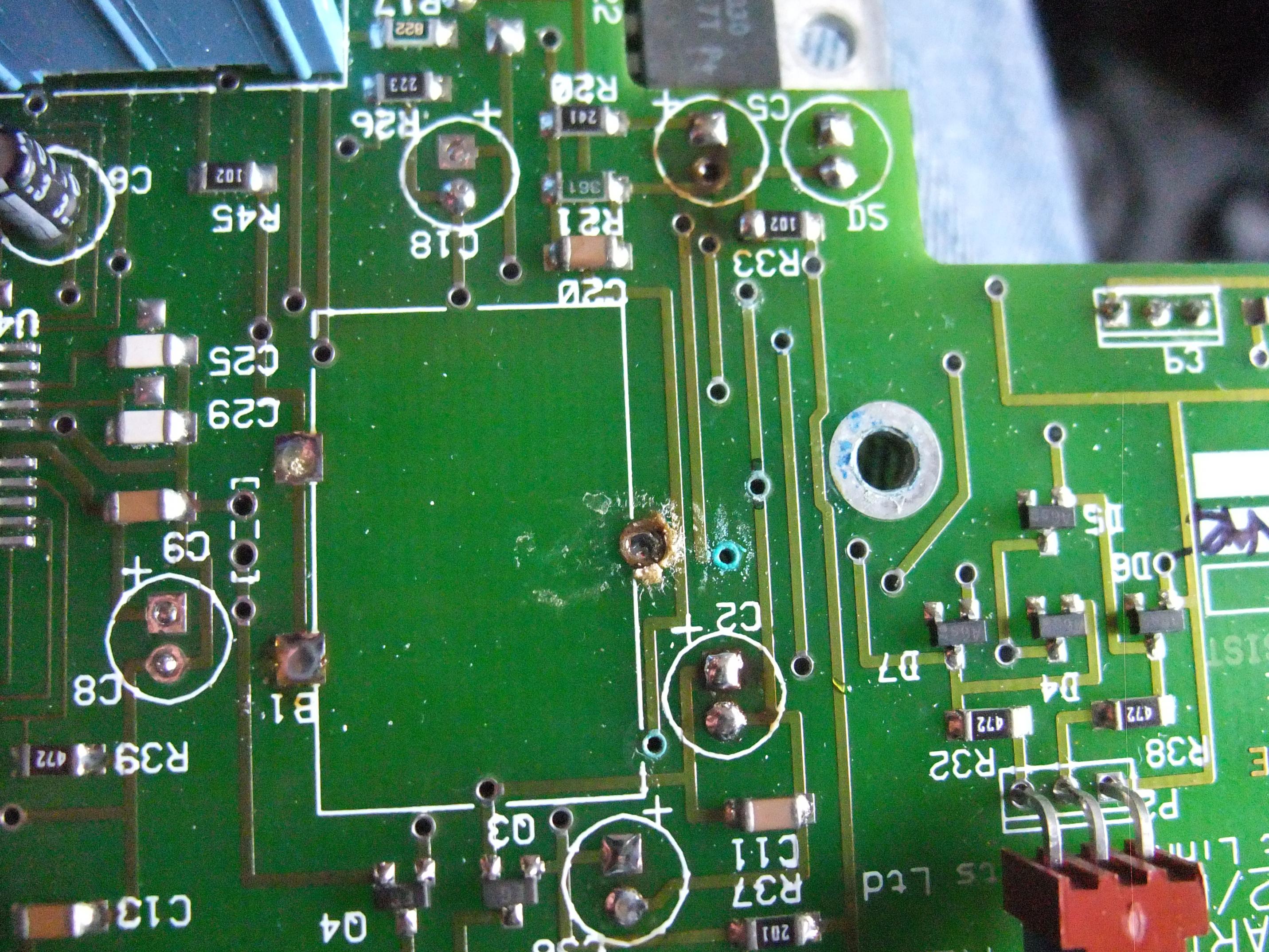

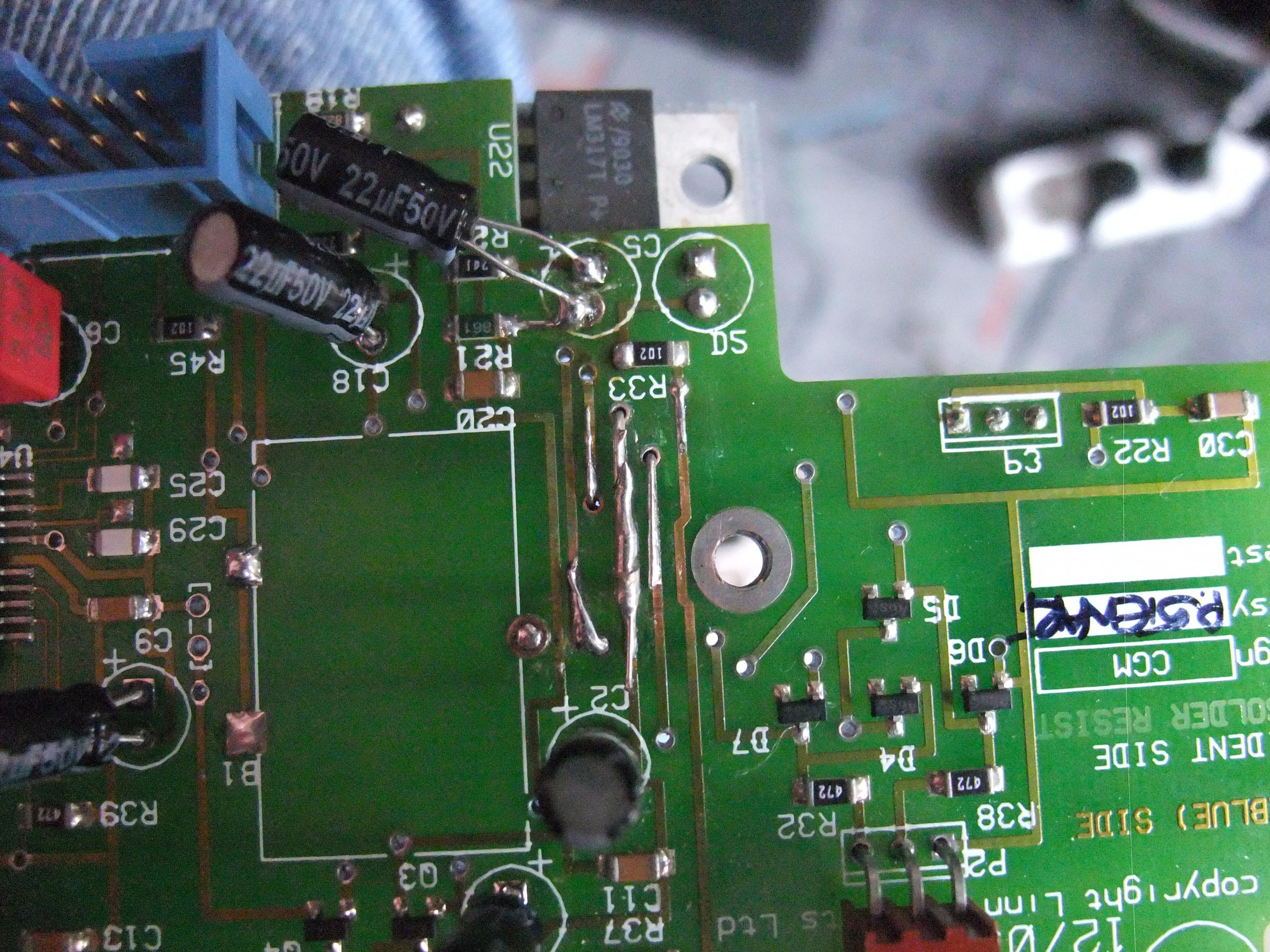

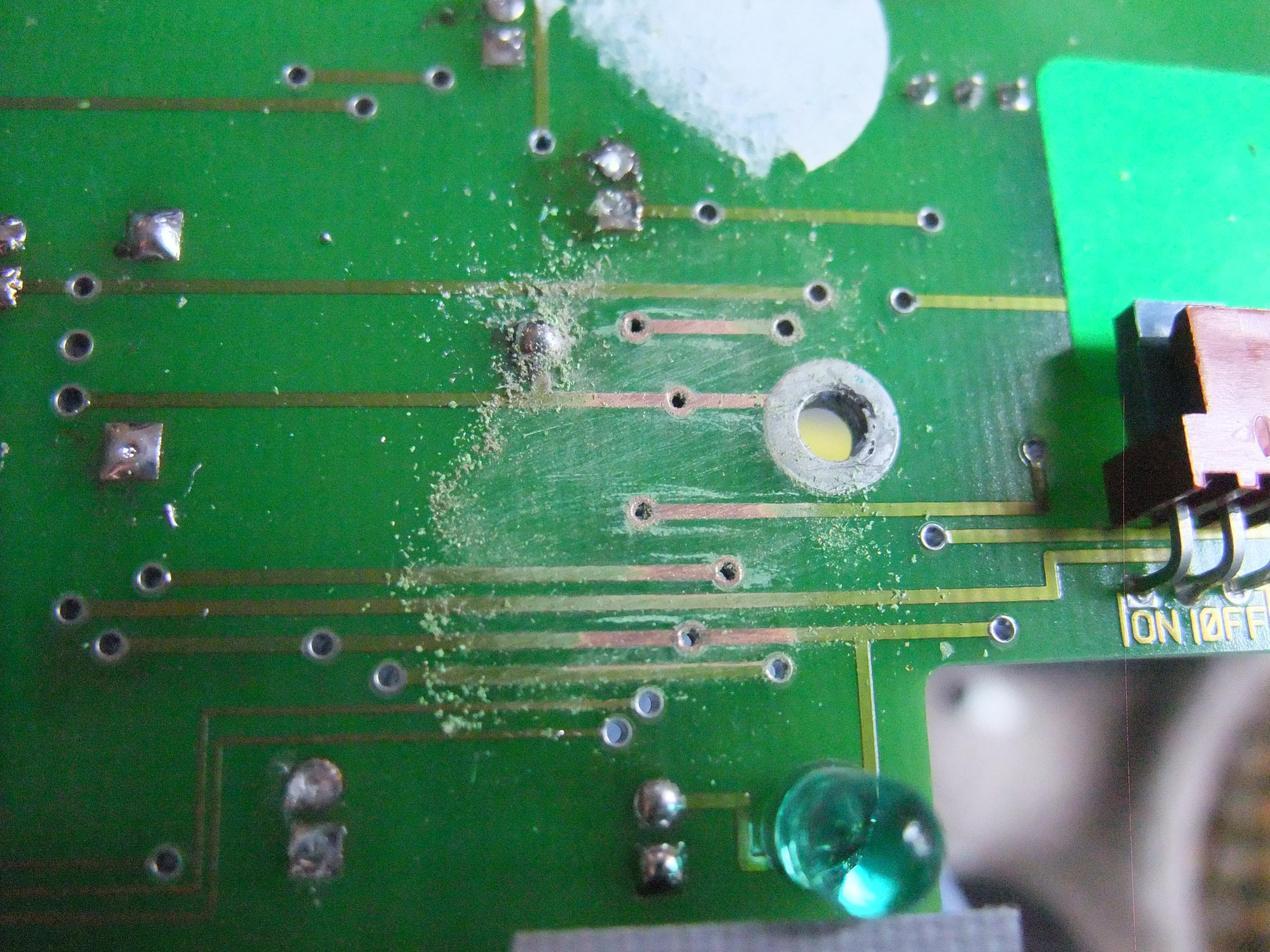

Kairn screen going blank

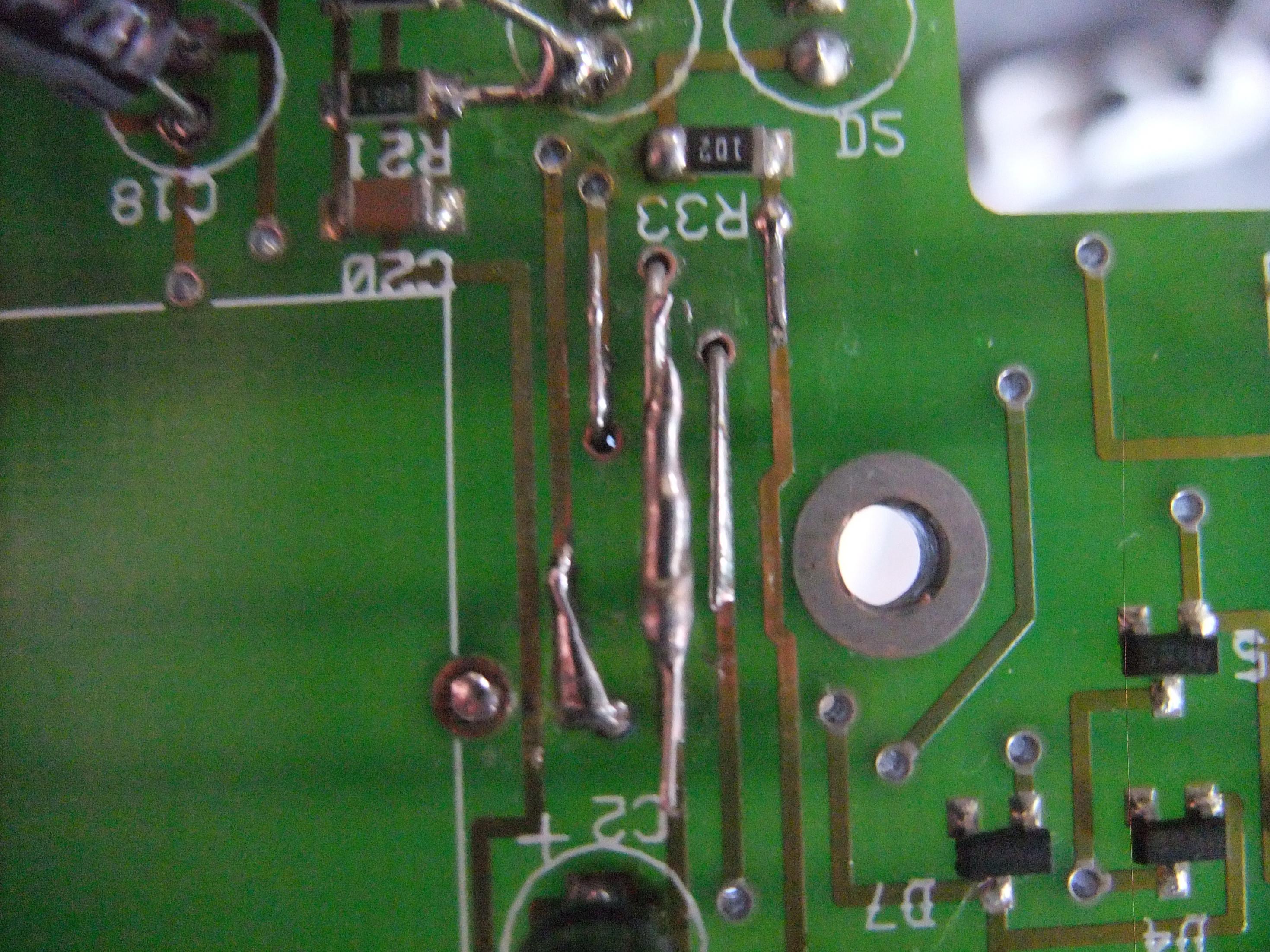

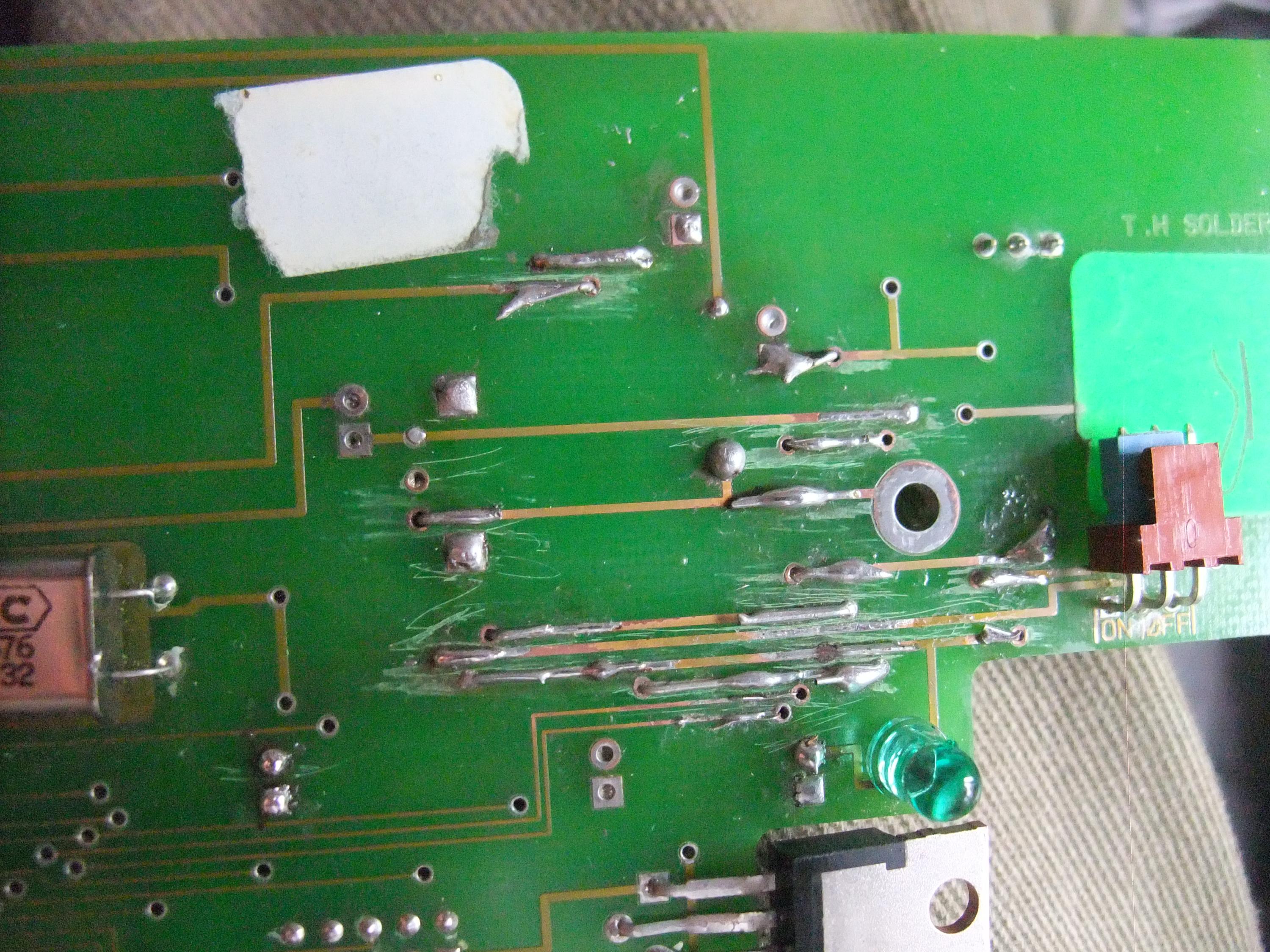

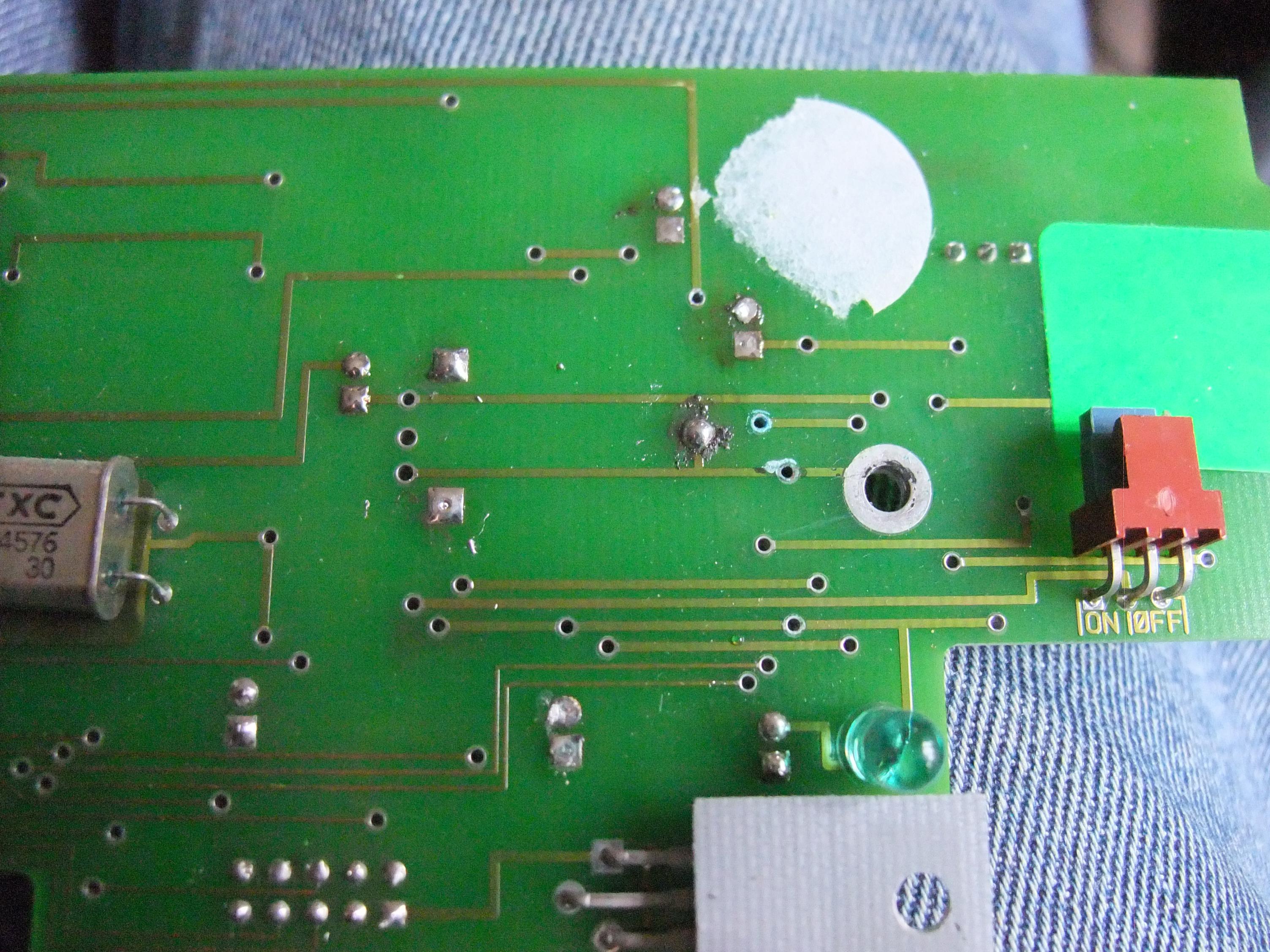

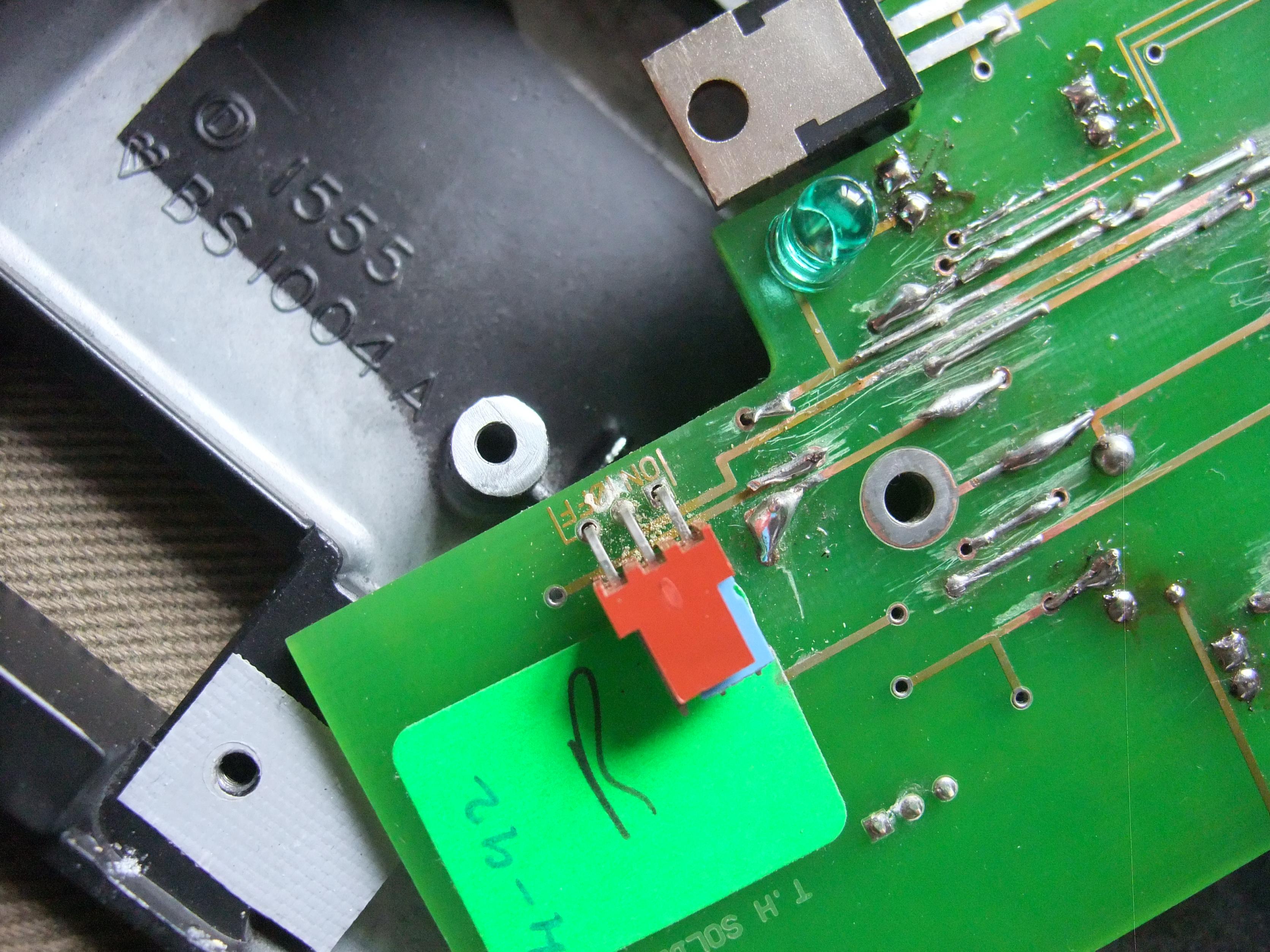

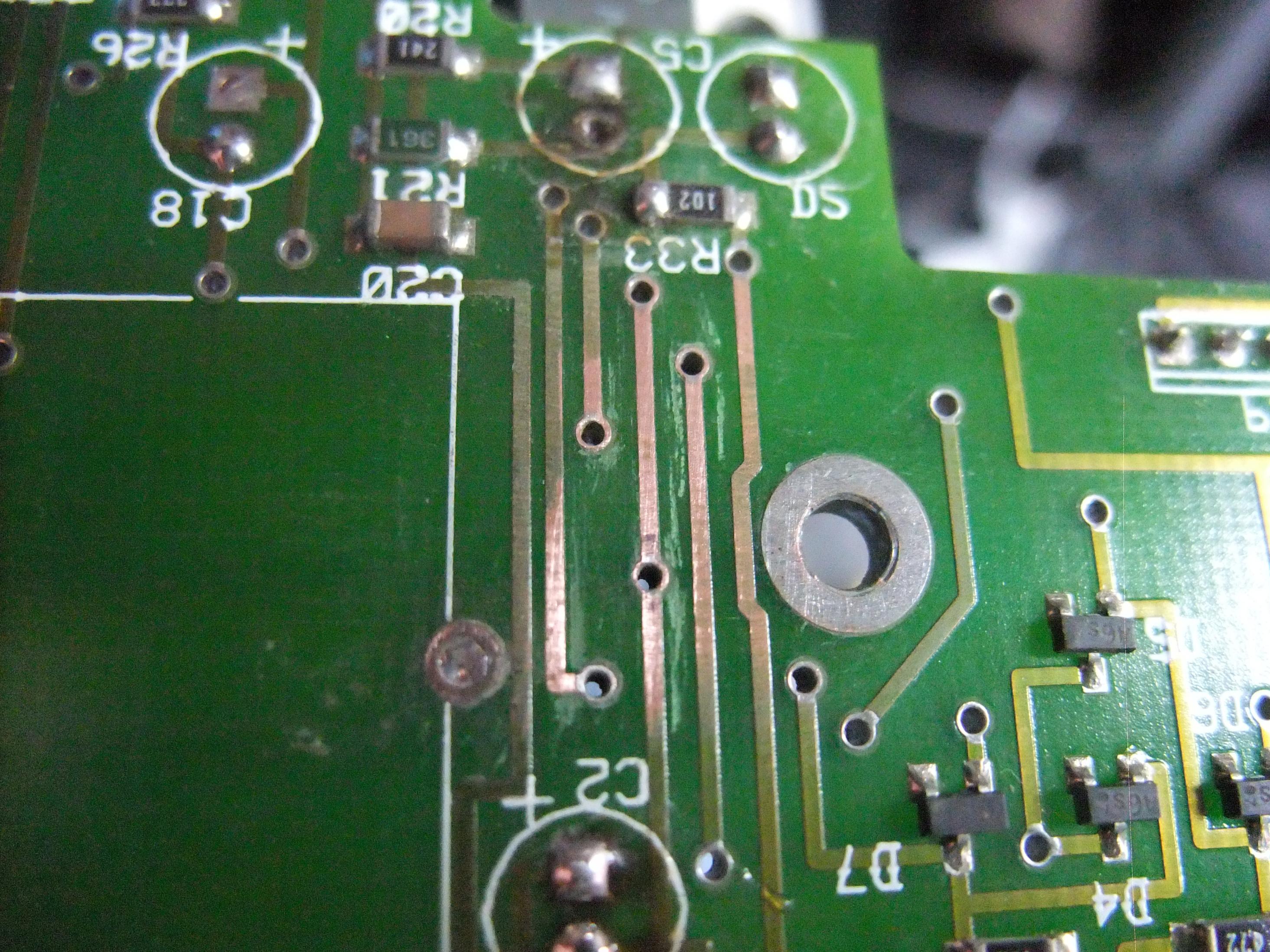

This can happen if an old NiCd-Accu is only removed too late
Check out the images below of several through corrosion-oxidized vias on the prozessor board so as the time-intensive work to eliminate the resulting contact problems.

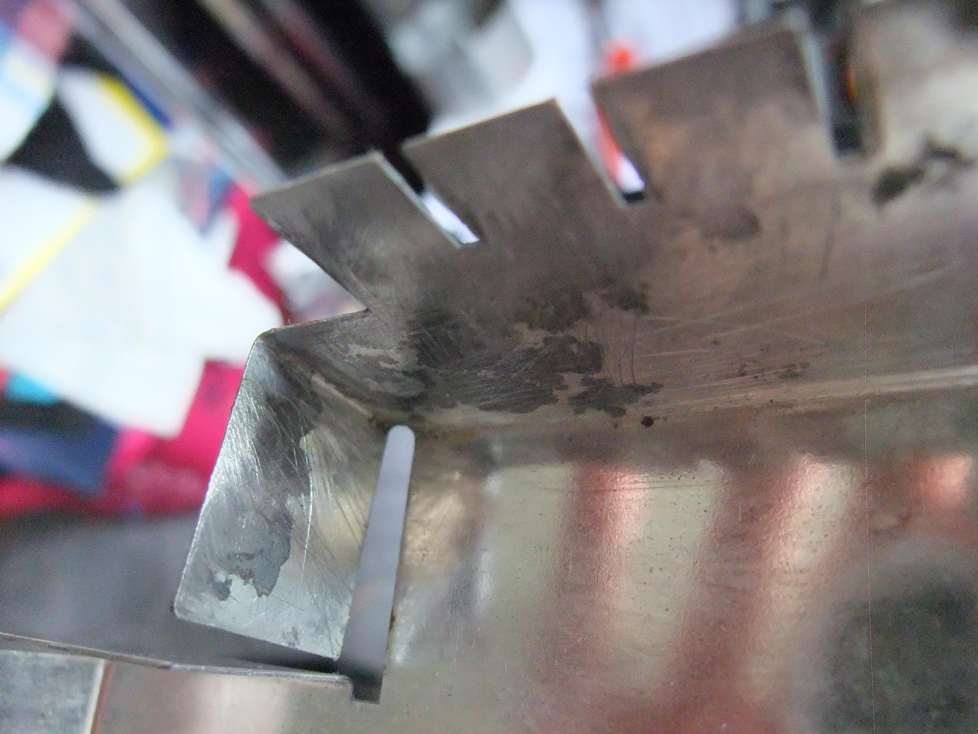

On the threaded bolt of the alu front plate paint residues must be removed for trouble-free electrical contact.
The main reason therefore are contact errors at the plug connections between mainboard and front- (operating-) PCB (at whole four connectors) and between the aluminum front panel and front PCB (GND-screw).Now I have replace the battery by a new version, but I still observe the same, as mentioned in my post #1. But all other functions are correct.

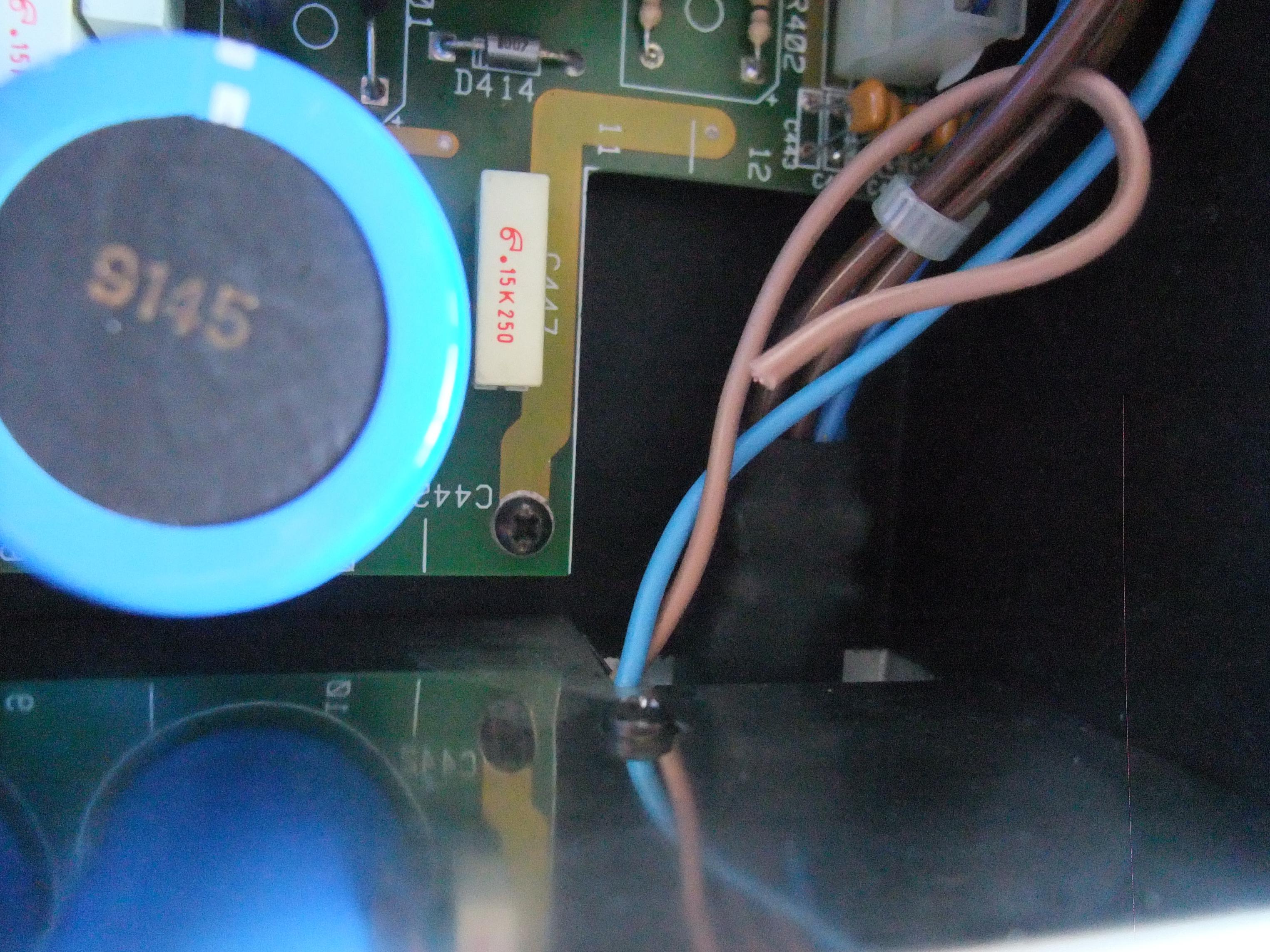

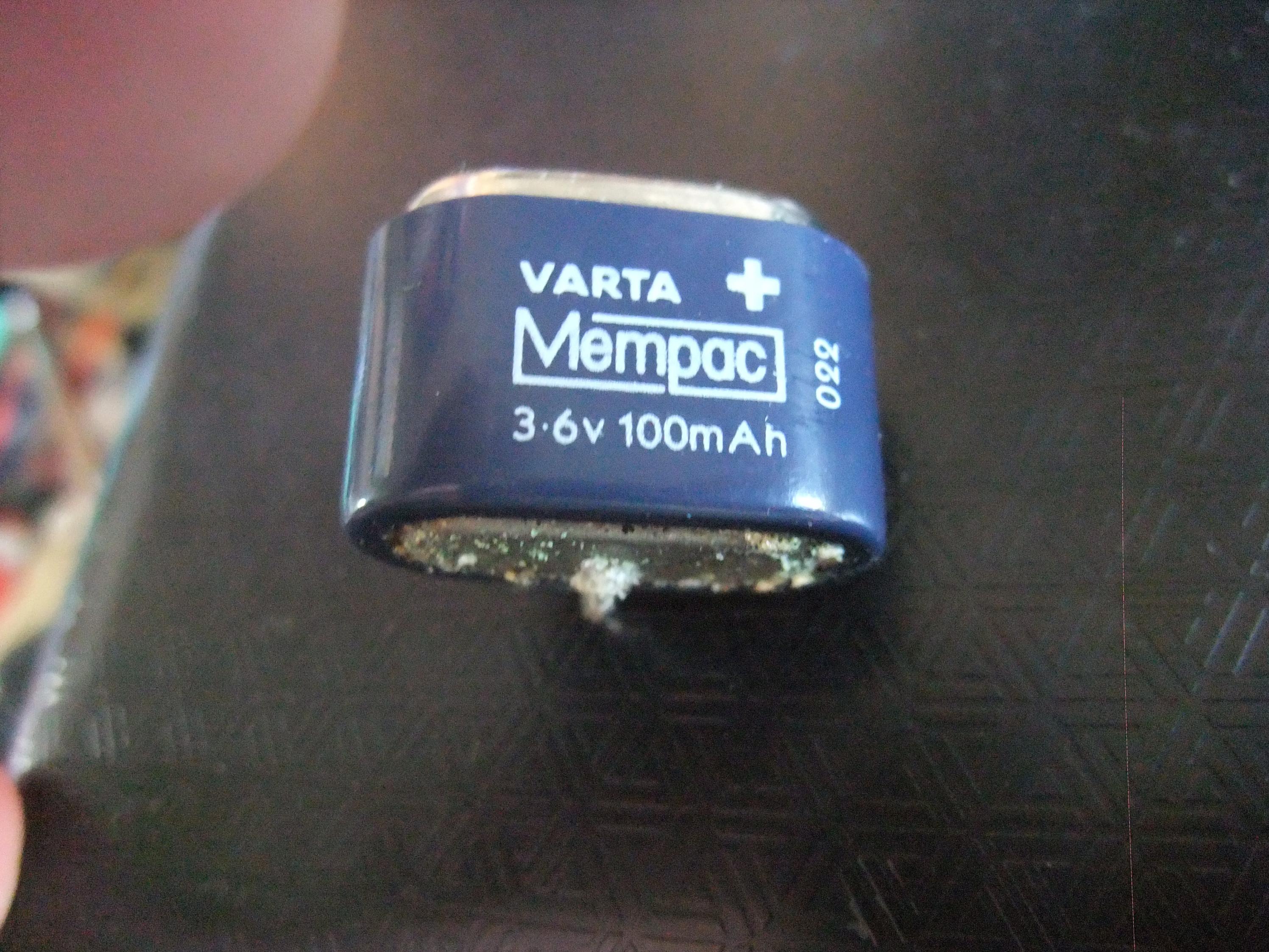

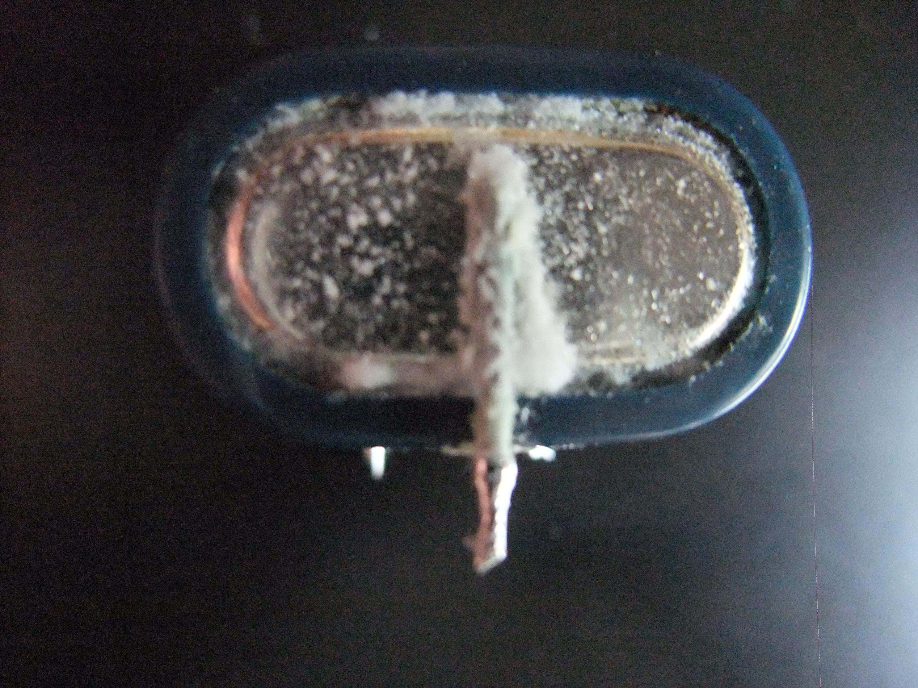

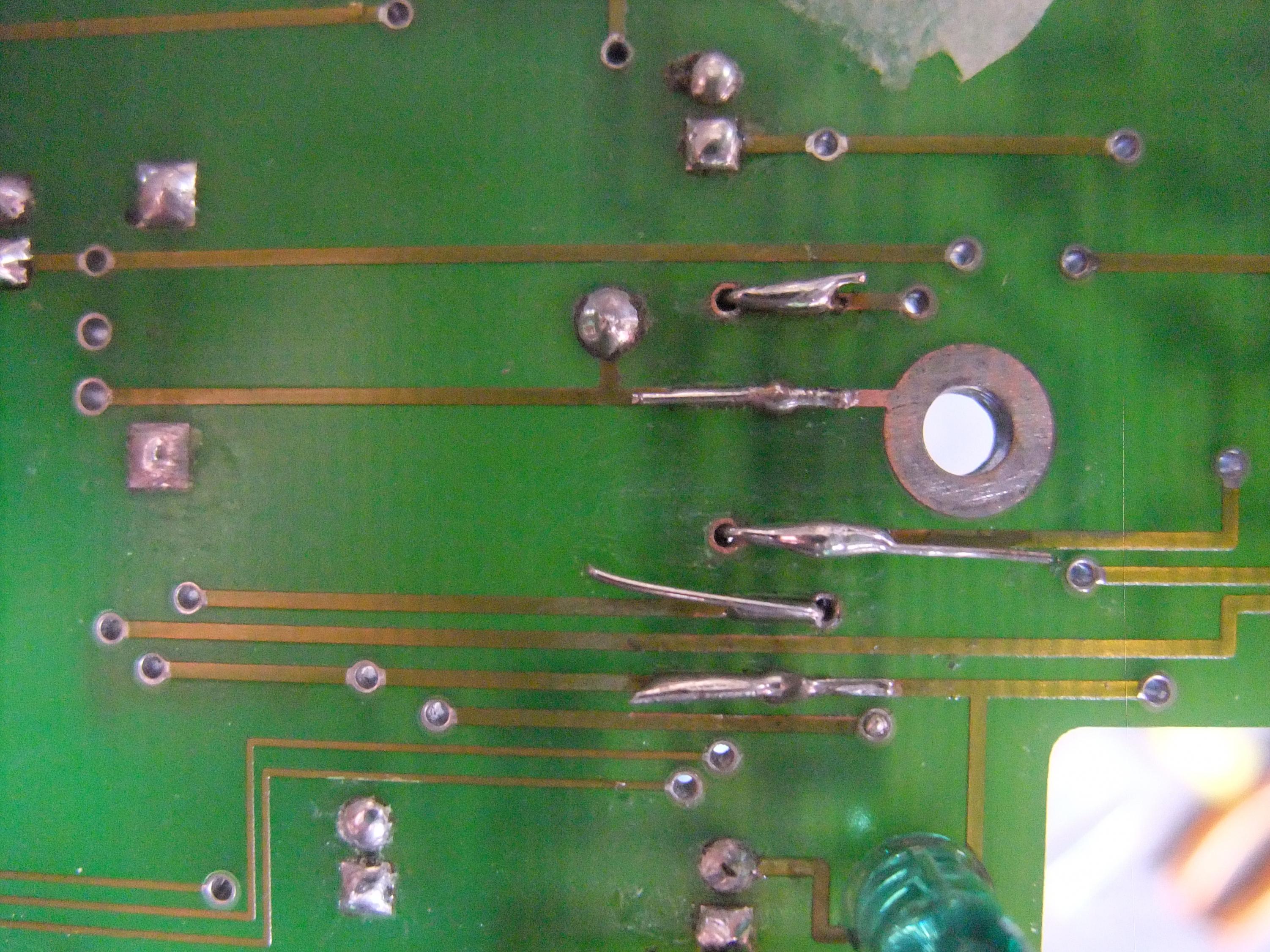

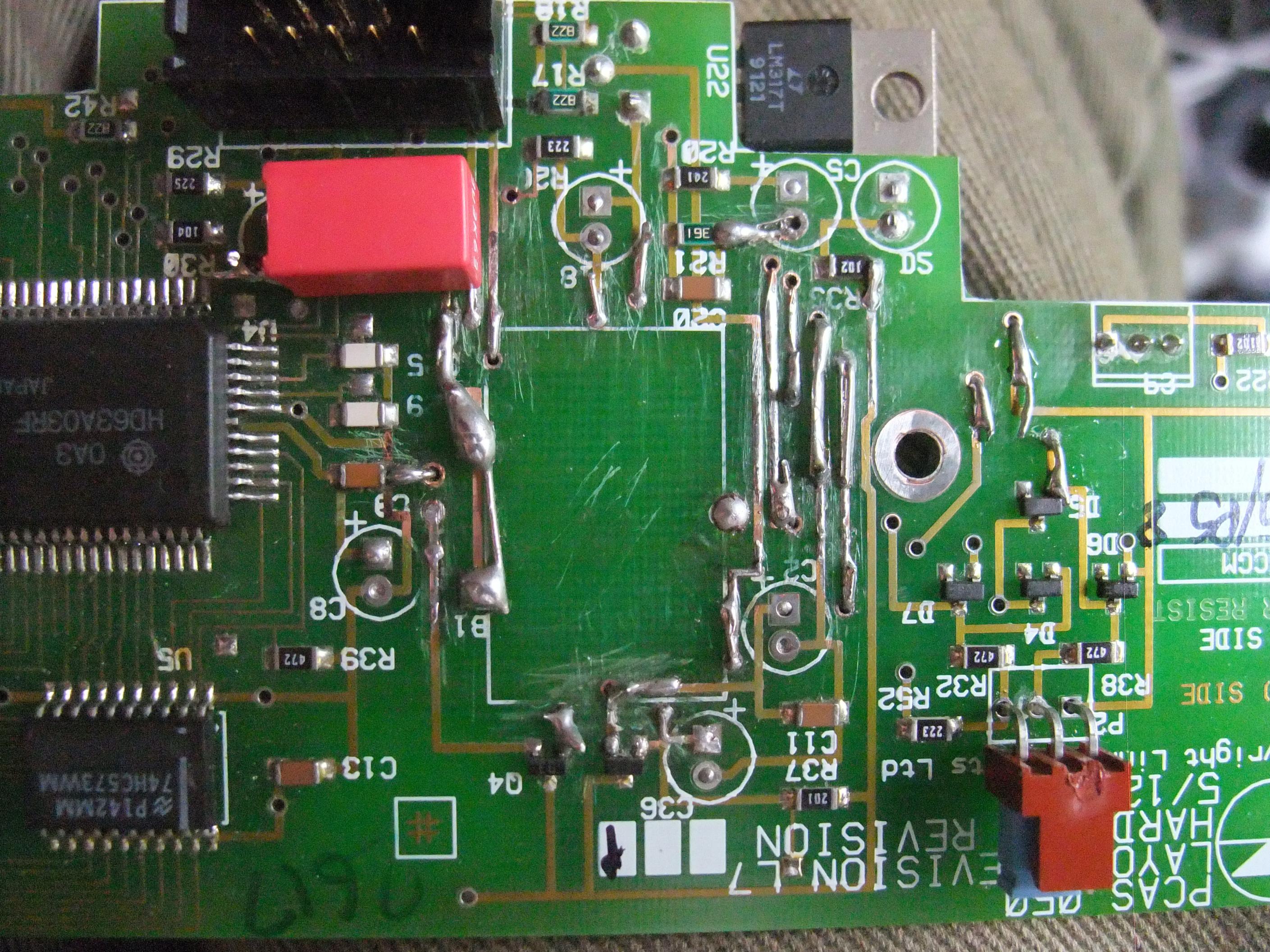

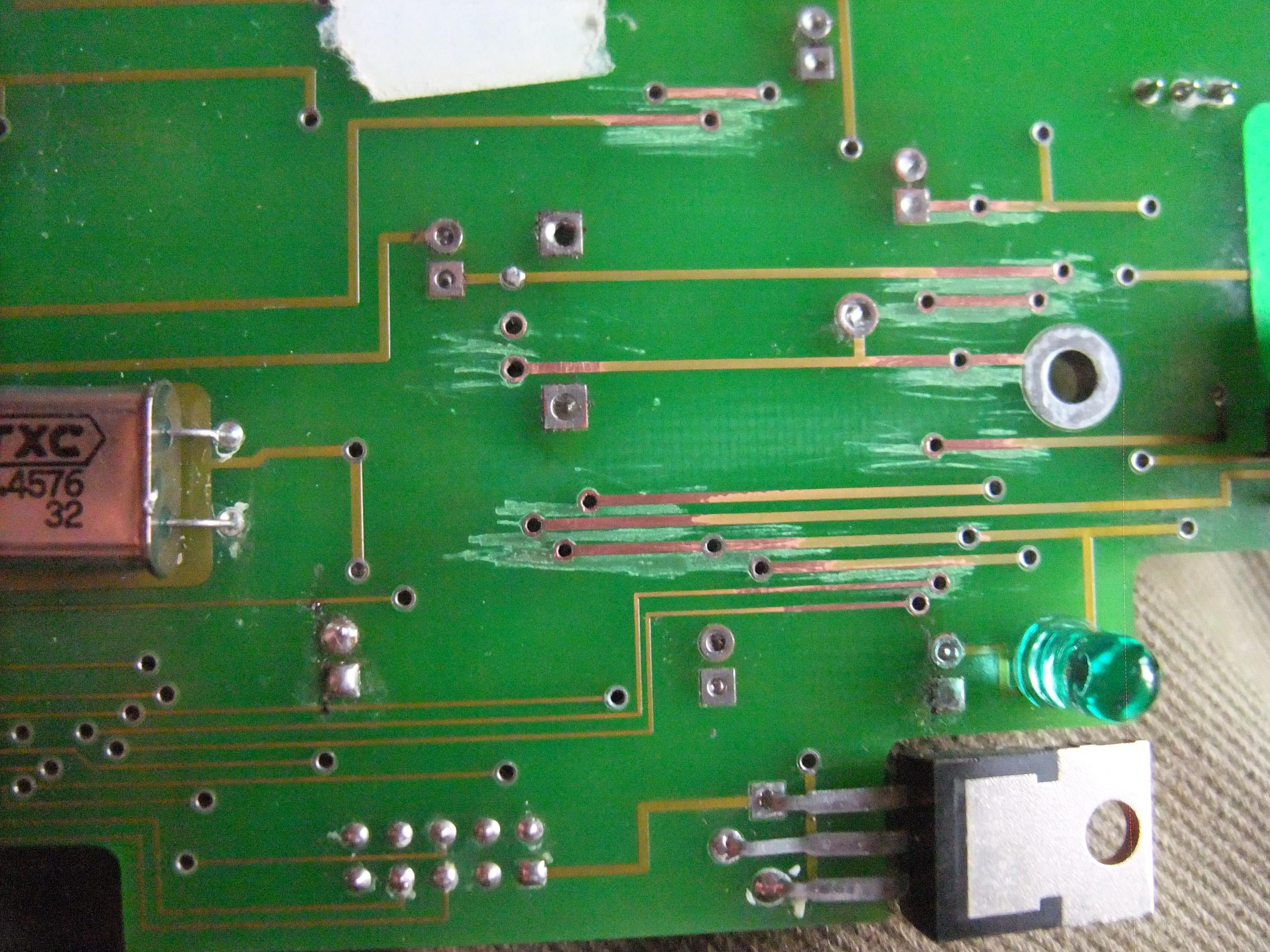

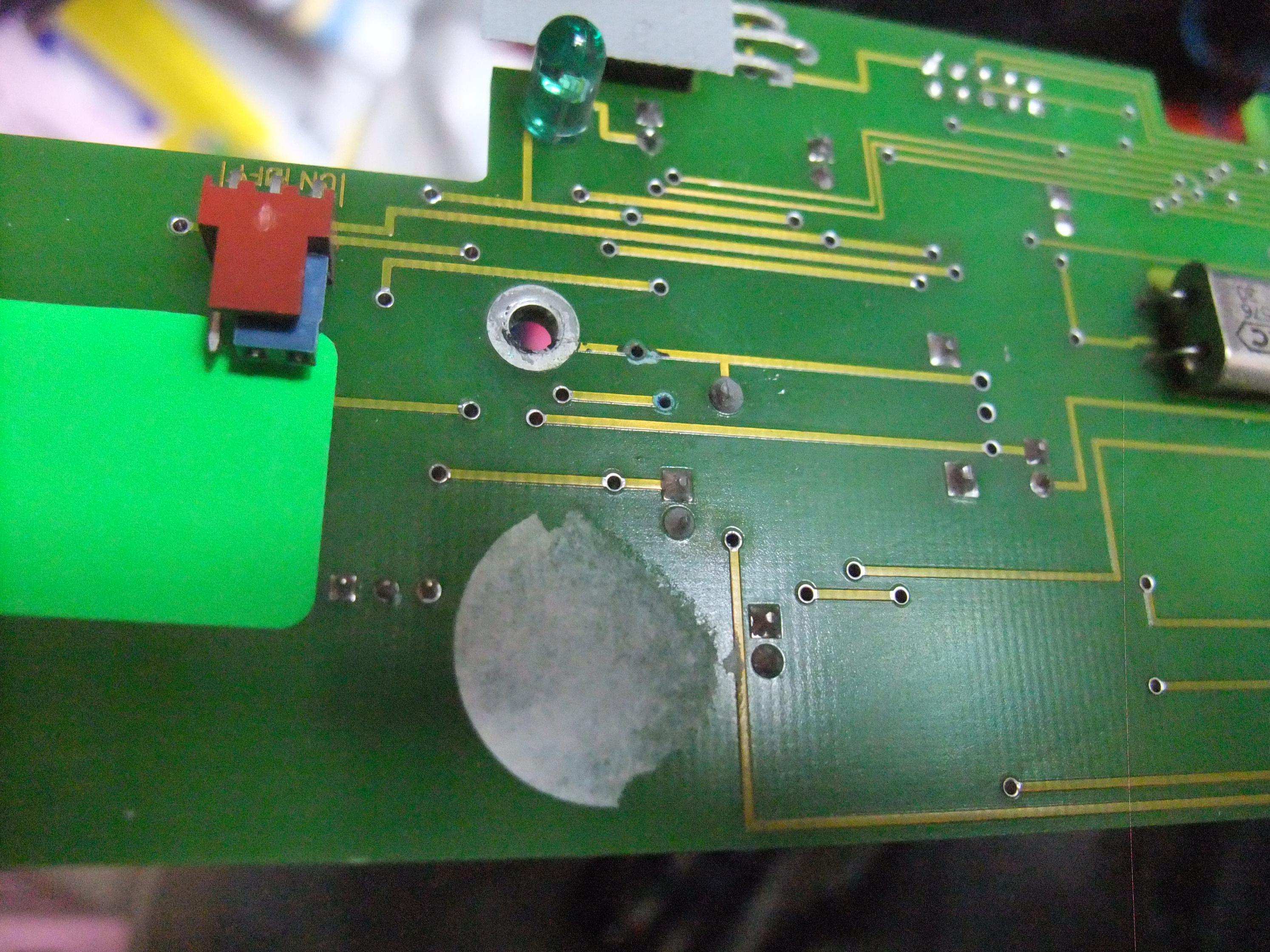

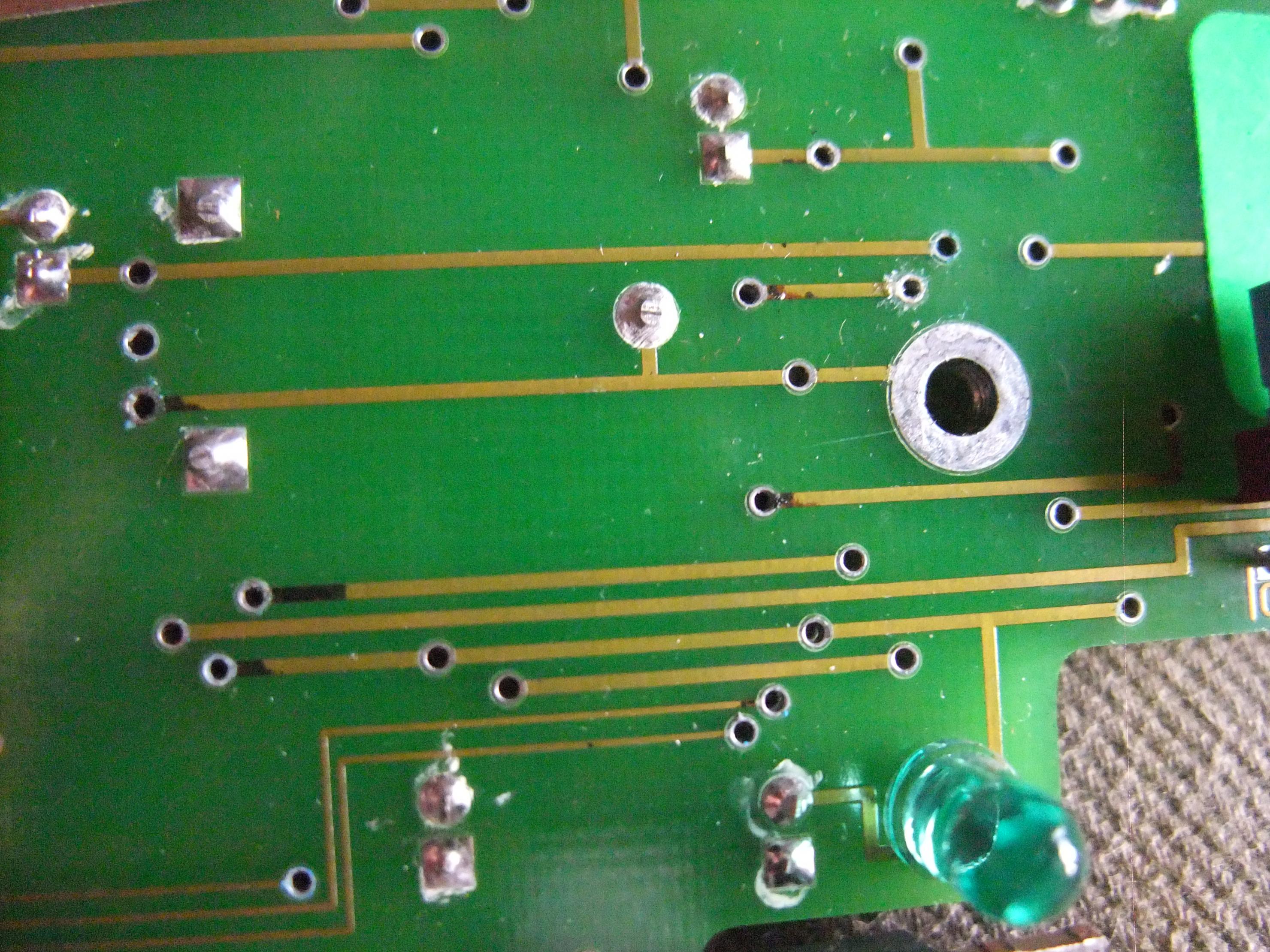

continue post #9
image description previous post
image 1 and 2:
the process of corroding PCB traces (looks black instead green) and connections from solder side to component side isalready recognizable
image 3 and 4:
PCB traces after sanding the solder resist
image 5 and 6:
Additionally silver wire inserted
image 7 and 8:
original/genuine (very old) VARTA memory pack 3V6, 1000mAh
image 9 and 10:
the process of corroding surface inside of the shielding envelope/shielding cap is already advanced (before and after sanding).
image description this post
image 1:
preparing for very low resistance between the front plate and PCB-earth resp. PCB-GND (very important)
image 2 and 3:
wires for outdoor use of any available memory accu pack

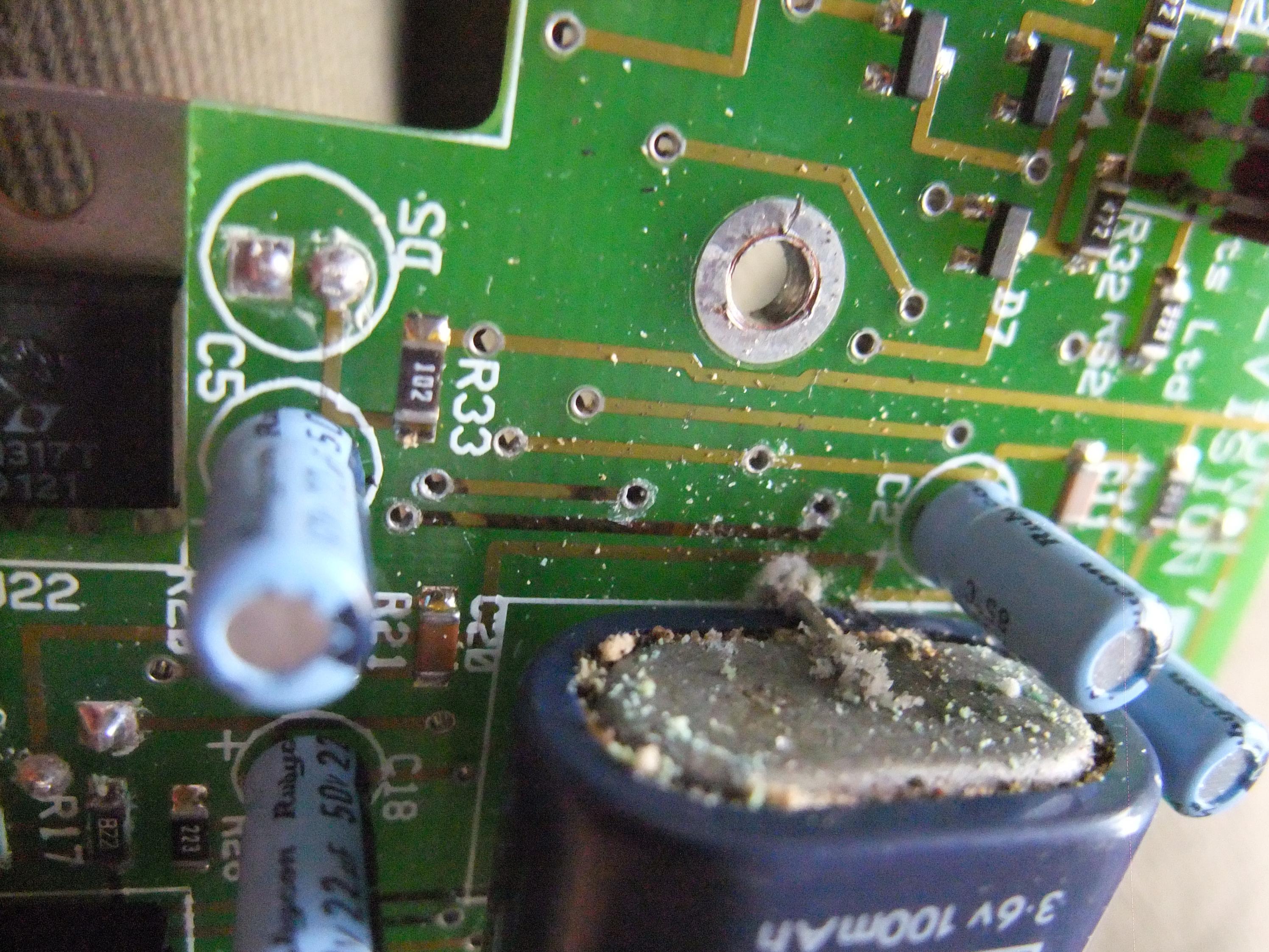

I have a Kairn that when turned on the green LED glows, dimly, but nothing is shown on the display. I don't think the amp works without the display but have not tried.
The PSU, slimline Brilliant, seems OK as it works inside a Karik.
The battery pack is leaking but on first glans I cannot seem much if any corrosion. The battery is still outputting 3.6V
Could a battery/corrosion cause the fault?
Is this the slimline Brilliant PSU?
After restoring the ROM I still had the same Problem. Green LED was ON and nothing showed up on the Display. My Slimline Brilliant SMPS brings something like +/- 20V and 10V.
After checking my restored lines on the Front-Panel (Battery damage) I found one more little cracked line. The one going from C2 to Q3 was cracked right at the hole to the opposite close to Q3.
So if I had checked all the lines before I could have saved a lot of time recaping everything... But now it should be good for the next 20+ years
