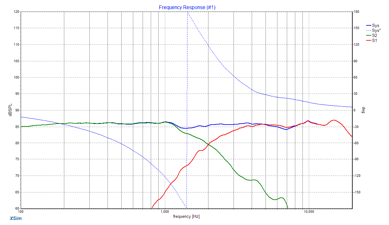

Take a look at this plot. It looks like the two responses were split using a simple filter, like an active one, but not the case. They have a different frequency and a different shape. One driver has been made more quiet, and there may also be shaping of the response. This is first part of how there is more to it than a crossover point.
You can use a computer to make plots like these, of your crossover as it is, so you can copy it into active filters.
