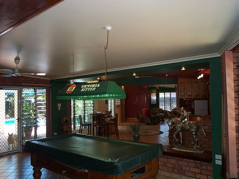

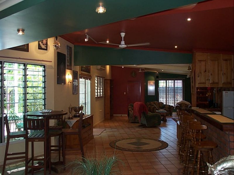

I am bringing my parents up from Melbourne to live with us, so there will be 7 poeple in the house. Living space is 301 sqm. At the auction about 60 people where inside and it was not crowded!
Its an old pre Cyclone Tracy house which was extended 4 years ago. The end of the lounge room will be sectioned off for my parents, but I will still have a room 10m long and 6m wide with a 3m bar, pool table and have room for the stereo, dining table etc.
Anyway, I still have the problem of my music not becoming thin with no body, especially the bass! I may have to start building more speakers and amps once again.
Mark
Mark
IB sub? Not sure what it is.
The floor is solid concrete and the roof line slopes with the ceiling, no room exept for the insulation, so I cannot put in an in roof or below floor sub, unfortunately.
I have to work with whats there. I do have a number of floor rugs in wool and silk, and we have a lot more furniture as well, so hopefully the room will not be too bright, but with all the windows it will be brighter than the average room.
