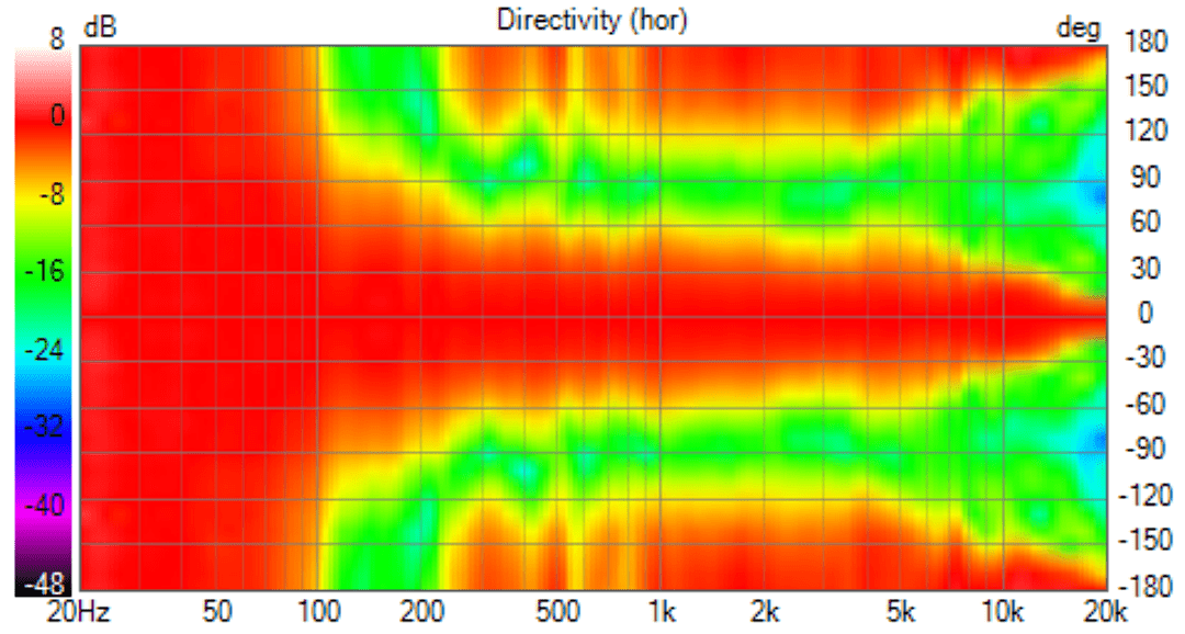

Backman's paper about mode excitation of different woofer radiation patterns is classic, but there are yher aspects to consider too. Psychoacoustics, spl requiremennt, power requirement, size restraint etc.
Using a monopole sub and OB woofer is wise compromise IMO. We have commercial and diy speakers made that way. With skill, dsp and outdoor measurements it's possible to have cardioid pattern in the very difficult (first reflectionwise) 100-300Hz range.

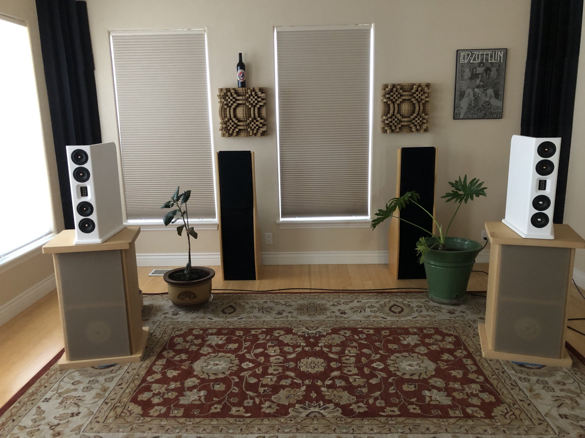

Thanks everyone for the input. Didn't realize the Orion drivers were that expensive. I looked at the LXmini's before, but these would be a hard sell re WAF, and I'm financially not that constraint. Which made me ponder another option: building the LX521 without the woofer part (and use my existing Rythmik sub for the low end). The upper baffle drivers for the LX521 are surprisingly affordable ($660 for 4 x 2 drivers) and Madisound will even sell me the flatpack cabinet without the woofer enclosure for $540. Has this been done? Does anyone have experience with this? I have toyed with the idea of getting a class D amp and a DSP anyway, so these wouldn't necessarily be extra expenses.
If you look here, there are two examples with a closed subs:
https://www.linkwitzlab.com/LX521/PhotoGallery.htm

Both those used stereo subs, at least, which is sensible given the 120 Hz crossover. And one of them wasn't very happy with the outcome. (I know, because I bought the LX521 drivers from him when he dismantled them.)
I feel, the LX521 kit (or its open baffle part only) provides a good compromise between performance, feasibility and price.
Have you looked into the LX521 kit options? You'll need the plans/license too. If you add in the cost of a miniDSP Flex 8, your getting close to $2000. That's quite a bit, when you're planning to throw a part of SL's design out the window, turning it into a 2.1 sub/sat setup,
As others have said above, there can be a place for sealed subs with open baffle. (Siegfried himself designed the Thor sealed sub for use with the Orion.) But crossing a single sub at 120 Hz to the LX521 mid/treble baffle sounds like a poor plan to me.
