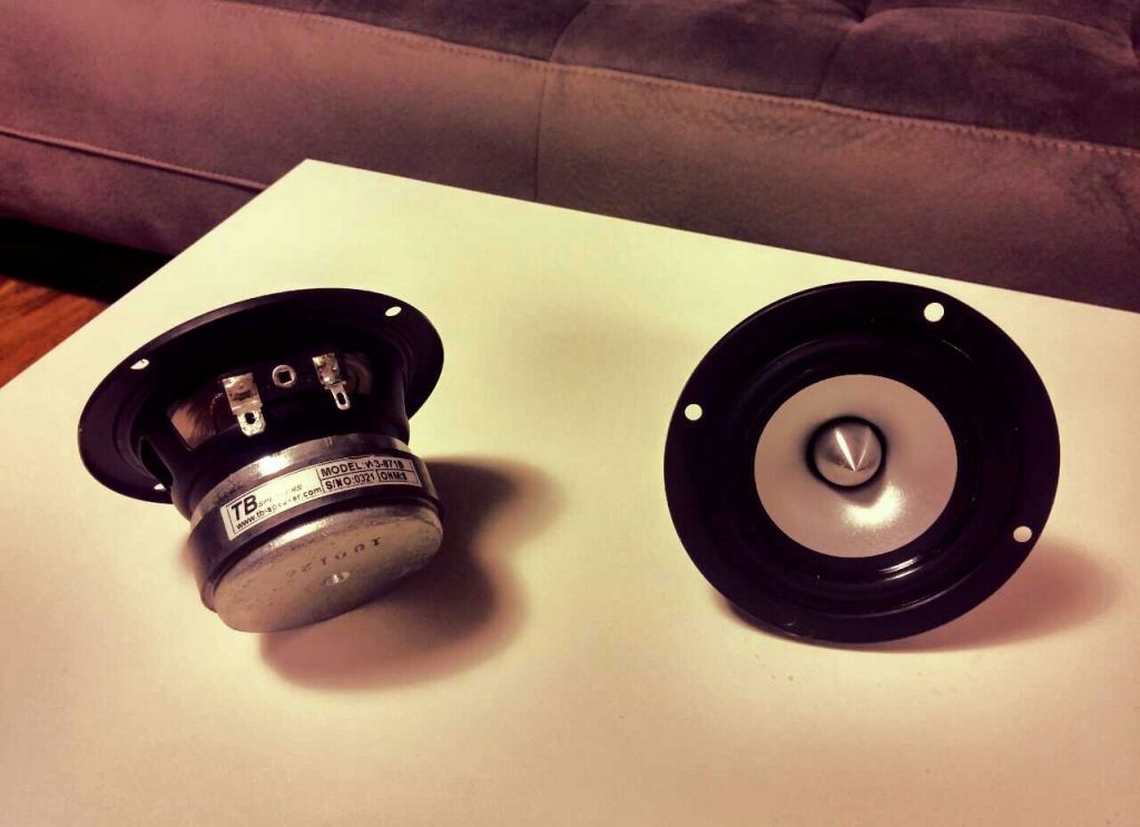

I am replicating them as I had a pair of 3 in TB's at hand.
In my case it would be fairly cheap as I purchased a pair of 7 in 88 db, 0.6 Qts, ~40-45 Hz Fs midbass drivers for $30 😀
Here is the design work so far in pictures.

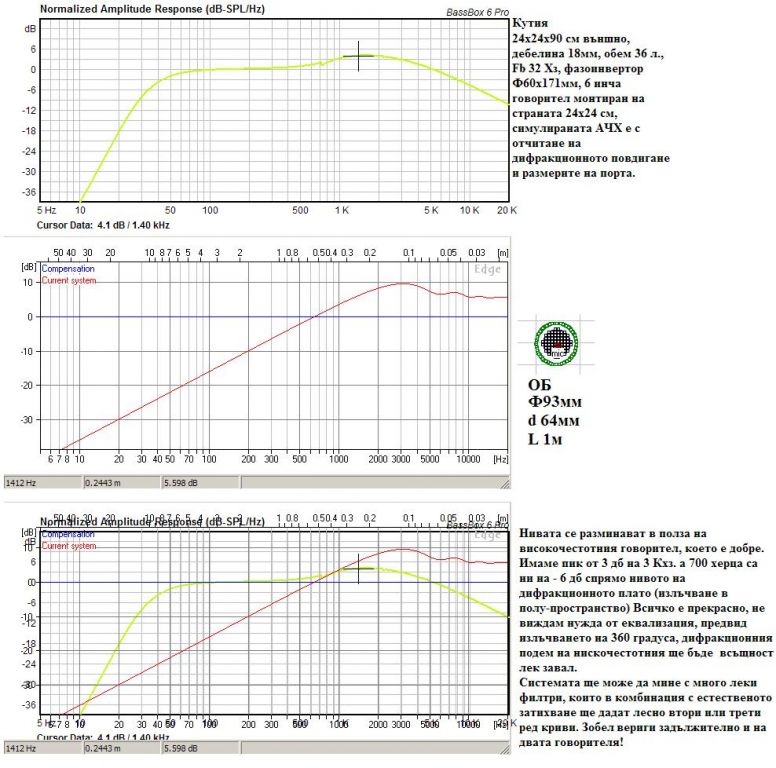

As I read the simulations, it should be possible to get away with 1-st order crossover and even no BSC.

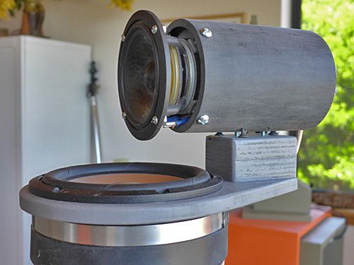

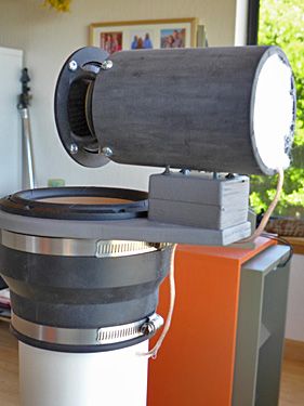

Here is the object of replication interest: LXmini Challenge an active system that is quasi omnidirectional and illuminating the space with sound in an faithful and life like manner.
As the main virtue of the system is it's acoustical constellation, the replica should be able to achieve the original's performance to a satisfactory extent without it's complexity and high price.
I had a little thought on the LX-Mini article and came to some pretty interesting conclusions.
In the description it is stated that the pipe with the fiber fill is intended for reducing the emission of high frequencies in that direction and to obtain a cardioid circle diagram which aids placing the speakers near the boundaries of the acoustic environment.
I would believe that if I wasn't sure that He addresses only the frequencies between the crossover frequency and the low cut off frequency of the baffle which in the specific case is about 2 kHz. And which are those frequencies emitted from and around the magnet? Wink, here at help comes an MJK's publication where he regards the openings in the chassis as a transmission lines and having in mind that the directivity comes with frequency, then definitely the only frequencies which have vector through the pipe are those from the first two octaves above the crossover frequency 700-1400-2800 Hertz. The rest is anyway emitted at vectors defined by the openings and the surface of the membrane, or in other words sideways.
Therefore, the drivers with non vented magnet system either way emit more and more cardioidally towards the high frequencies.
I think that uncle Siegfried Linkwitz has put the pipe there in order to reduce the size of the required baffle to the size of the chassis, but due to the fact that he measures circle diagram, he saw that the cardioidal character of the emission is underlined.
I am even ready to bet on that the wadding in the pipe in not there to absorb sound in the high frequencies, but to reduce pipe resonance in lower frequencies!
For the cardioid emission in the high frequencies it is enough that such a cylindrical body is present in that place.

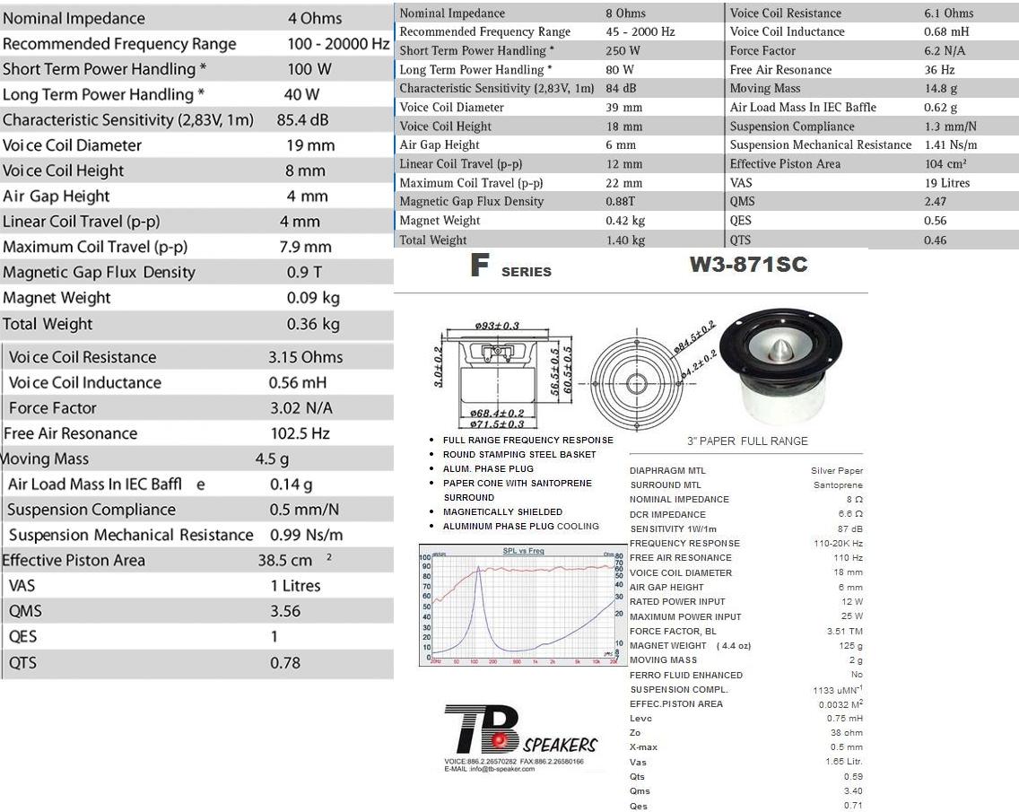

Parameters of the midbass drivers:
50W
Qms : 2,54
Qes : 0,94
Qt : 0,68
Vas : 27-45 L
Fs ~38-45 Hz
40 - 5000 Hz
88 dB

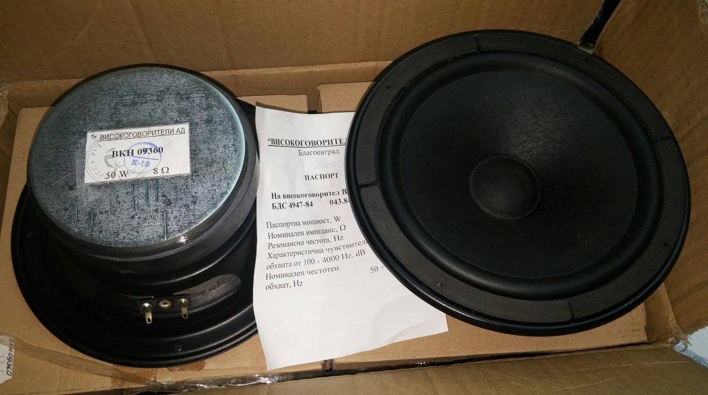

Thay are insignificant to you as they are from local manufacturer and as far as I know are not exported. The Qts of 0.5 and above gives the opportunity to tune Fb of an eventual vented system lower than the driver Fs. In the present case a not so big ~30L vented box would allow pretty decent F3@40Hz with reduced fill there would even be a bump in low the response which I find pleasant to listen to.
Now a simple for understanding pictures follow.
The Bass box simulation takes into account enclosure face plate dimensions and vent size, but does not account for beaming.
N.B. The first label in Bulgarian on the simulation picture is regarding the box which is for a local driver, thus not important;
The second is a screenshot from The Edge - self explanatory;
And the third text is that the level of the mid/HF is higher than the one of the woofer. The rising response of the woofer is not a problem even if it resides after simple crossover, because of the 360 propagation pattern thus the falling response perceived at any single point in surrounding space.

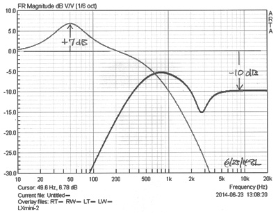

This is a graph of the DSP equalization applied.
The midbass enclosure of the original is undersized for no reason as a two-three times the volume would have comparable footprint.
So the 7db Eq is not needed in a decently sized vented cabinet with 7 in driver.
Further the full range has more sensitivity and operates in the diffraction plato -> +6 db due to 1/2 phi operation.
I think that the whole active system and EQ-ing is there just because this is SL - the king of DSP, ASP, crossovers and etc. and the drivers have to be Seas.
And the whole thing is sold to the public as a driver in a what looks like a sewer pipe, but the actual system is not cheap at all while exploiting very simple phenomenons.
Actually it is obvious that a relatively flat system exhibiting the same acoustic features can be constructed with just a first order crossover.

No, actually it's not. That's a general EQ plot for public consumption, but the actual LXmini EQ curves are quite a bit more complex......especially the tweeter driver. (Something that can only be implemented with a DSP solution.)
Dave.
I will second that. It really is substantially different to the EQ plot. This cannot be replicated with a passive crossover.
