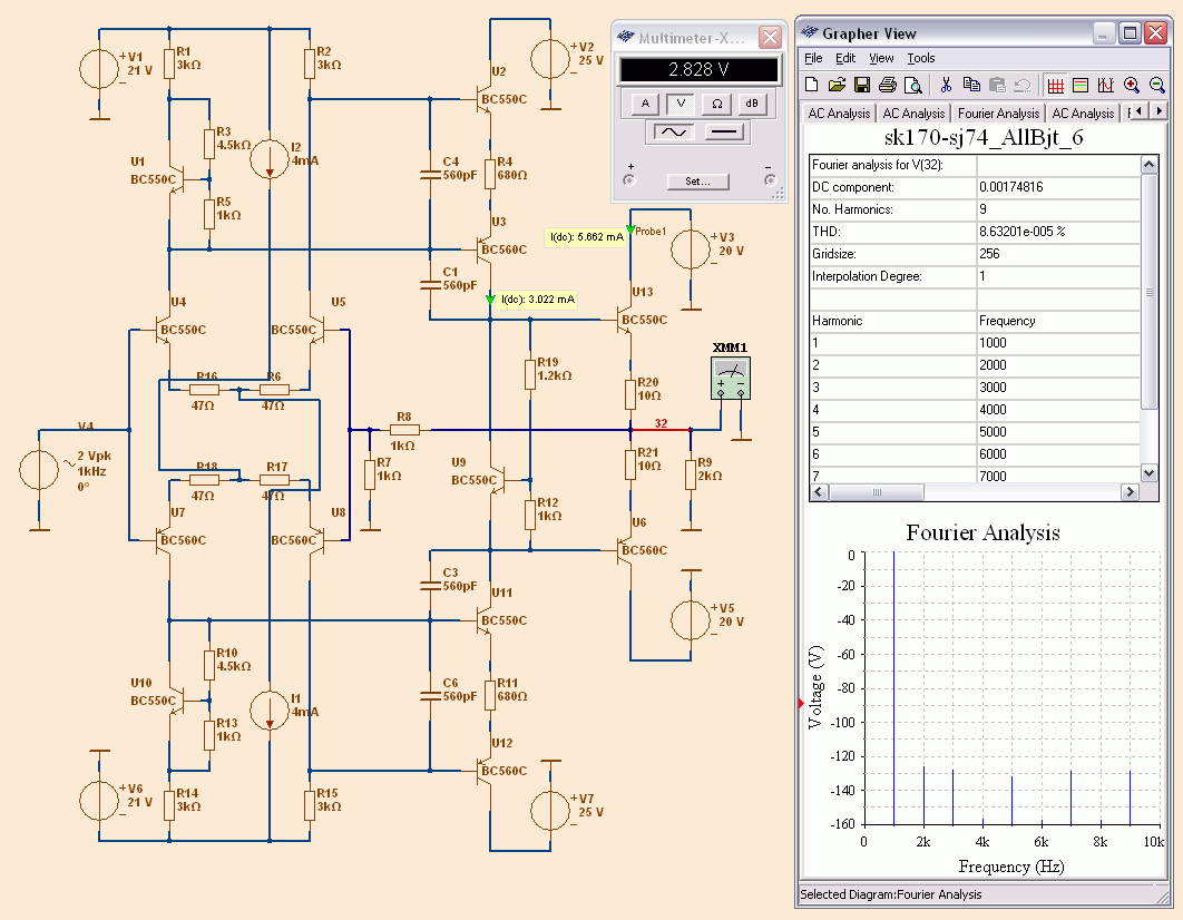

OH NO, the more loaded is the VAS the lower voltage swing will be (OLG), that's why the need of a buffer, expose the VAS to a light load and let the buffer do the brute force against the OPS. The output impedance of the buffer is determined by the EF (U1) not the CCS, you can replace the CCS by a resistor of 10K, 5K, 1K and the output impedance of the buffer will be almost the same, the only difference will be the quiescent current of the buffer, even more you can eliminate the CCS and the circuit will continue working. And yes there is a current gain with the buffer as it raises the output impedance of the VAS ... and so on backwards.

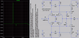

I am still i doubt, will it work with real not so perfect matched J-fets...how to keep the center from floating...??..

Yes an No, it is all about the amount of output distortion tolerable, among other factors. The more loaded VAS the more output distortion.
That's the controversy of direct VAS driving, EF2, or EF3 (depending on OPS devices), nevertheless you will need a minimum current gain (for a given load), regardless the FB loop, that is Ai>=Av(constant)*(Zi/Zo). So if you set the maximum distortion allowable, the minimum damping factor and the minimum input impedance for a fixed Av through the BW, it is very likely that a buffer stage will help the amp. performance. It is up to each concrete implementation.
Only thing I can think to randomize it more would be another JFET .model
I do have three or four slightly different .models for these same JFETs.
Offset maybe, but distortion don't look all that sensitive to mismatch...
Arturo, if you had an EF3 OPS. Why add another EF buffer to make EF4?
Are we forgetting the OPS is already a buffer? How many stages can we
tolerate to be in a loop before layout starts to affect stability?

Kenpeter :
The fewer EF's the better for stability, despite stability is a primordial concern there are other issues to take account, I understand that EFn includes de OPS as the last buffer, but it is not important to stick in a semantic issue. Including a buffer stage between VAS and OPS or not, is a trade off, what are average and peak current demands?, it's a 10W OPS or 16 device 2KW OPS?, the distortion?, stability?, BW? offset? ... etc. infinite solutions ... I am not advocating the use of more or less buffers a priori, it depends on the minimum that satisfy the rules of design, that are completely arbitrary because are 'my/your rules', if you achieve same or better results that full fills the 'rules' with no intermediate buffers, no doubt, that's a better design.

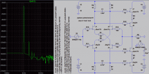

Hi
if you do the output stage with lateral mosfets you can skip the VBE multiplier and create the bias with a simple resistor as biasspreader network...
Hi
You could fix the spread across Lineup's R20+R21 bias resistors by returning
current to his VAS stage. In my oddball example you also see a 15K on the
flipside of the VAS to balance against those same bias correcting currents.
Yeah, theres a whole lot more strange going on here. But the bias is all
I really wanted to show. The rest may not be relevant to this thread.
Anyways, takes hot output devices completely out of the bias equation.
Lineup's output introduces two hot emitter drops of uncertainty after the
bias spreader. Probably not a big deal, I'm just making conversation...
At 5.6mA (.12W), nothing about Lineup's circuit is going to get especially
hot anyway...
As you beef up that output, or add EFs, it might become relevant...
For purpose of this thread, ignore my Class B Schottkys and pretend they
are Lineup's Class A resistors.
This bias scheme doesn't make a whole lot of sense at such low current.
I would not normally have needed 100R resistors. I'm just showing how
you can use cold transistors to regulate bias, and not let a hot output
device make that decision.
---oops---
Drew Q2 PNP upside down, strange the sim still worked fine that way...
I thought VBE was supposed to avalanche like a Zenier around 5V???
