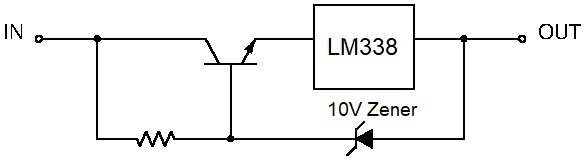

Hello All,
Looking for linear voltage regulators that have input around 55 V and output 50 V and can handle 5 amps. Also need the complementary regulator for -55/-50 V. Are there any ready components? I'm having great difficulty to find any. (Otherwise I'll have to build one myself.)

LT1084/LM338 are good regulators.
But you need additional circuit to limit input/output differential at start up.
Also if your amp is Class A and draws 5A immediately at start up, your transient dissipation is 250W~275W even with current limit.
So it depends on your application.
If your transformer has 2 secondaries, you can just make 2x positive regulated supply, and series them to give +/-50V.
Actually it is a AB amplifier, so I need to have a regulöator that can handle the negative voltage.
I think capacitance multiplier is enough and have better efficiency than voltage regulator. Usually audio amplifier do not need voltage regulator and it should work with voltage tolerance +-10%. If you need voltage regulator, usually only at VAS and input stage with several volt higher than output stage.
