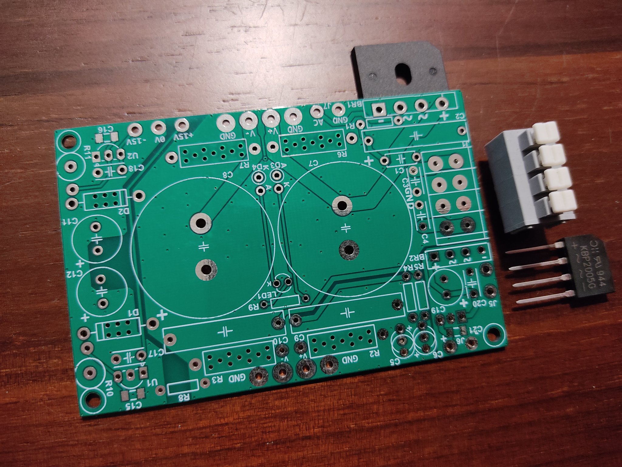

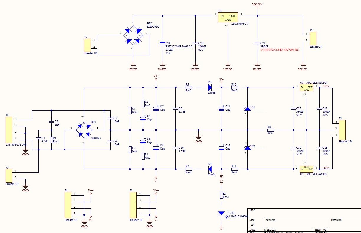

I have recently develop this power supply, mainly to be used for chipamps in terms of power
is good up to 200 watt, it does provide +15 and -15 from the main rails up to +60 -60 volts.
Also the power supply does have a low power aux supply for standby or misc electronics
I would like to know what forum users think about the design?

I develop linear power supplies for amplifiers, this one is more was more dedicated for chipamps but in under right corner of the pcb, there is an aux small supply "small bridge rectifier" which is to be suited with a 78 series regulator so it can provide 5 volt, with a 7805.
