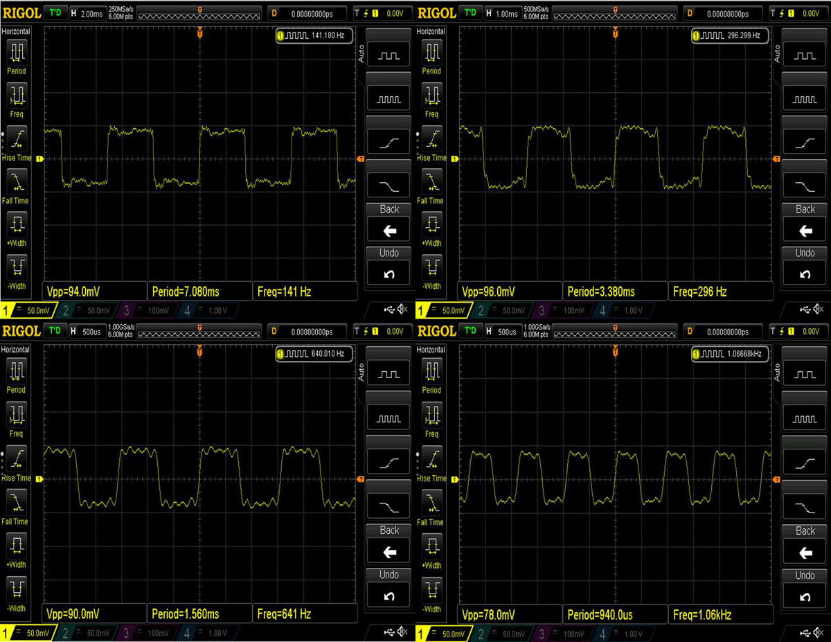

1. Can someone tell me what to look for in the measurements to identify if a speaker can be at least close to being able to produce a good square wave? My guess is that to play a square wave, the phase has to be a flat line, with NO tilt.
Yes? Or is this an oversimplification and phase does NOT have to be a flat line?
2. So if the phase response is a TILTED continuous line, like the measurements of the "Revelation Two - M4 WG", what does this say about its ability to play a square wave?
3. What does the phase tracking tell us? Let's say I want the woofer and tweeter to start and stop in sync. This is how I understand the proper square wave reproduction. The phase tracking doesn't really tell about that?
To understand, I must ask, does the "phase response" tell us BOTH: When both drivers START reproducing sound and STOP reproducing sound? And what's inbetween..
Hi, my understandings/experiences/2cents
1. Square wave reproduction needs two flat lines....
magnitude (frequency response) and phase.
Needs both, nothing more/nothing less; that simple.
2. Tilted phase (straight-line or curved) on a normal graph where frequency is plotted logarithmically will not reproduce square waves.
If frequency is plotted linearly, a straight-line tilt will reproduce square waves.
All it takes is a constant delay across all frequencies to take the tilting straight line to flat horizontal.
3. As others have said, phase is relative between frequencies.
What it means is that if every frequency were simultaneously played all from the same starting instant, that they all start together from zero amplitude and then each would peak 1/4th their respective periods later.
This is what a dirac pulse is, the summation of the first sample (and first sample only) of every frequency.
But obviously all frequencies can't end together, as they have different periods. (Unless you find the least common multiple of all frequencies' periods and make that the time duration of the test...methinks we would grow quite old waiting for the test period to end ....hey, maybe that's the end of time loL)
The greatest meaning i take from phase, is that when it's flat (and magnitude is too) all the various measurements we look at will look great too.
Whether square waves, impulse response, step response, etc.....they are all just a function of mag and phase...all saying the same thing from a different vantage. In the end all there is is frequency, and timing imho.
Ime, square waves are the hardest of those to reproduce....they have the finest resolution. here's a set from a 3-way M-T-M. They were admittedly hand picked frequencies, and also from a single measuring spot, but even with all that i believe these represent super results.
Those were done with dsp, linear phase.

There is another requirement for a speaker or system to reproduce waveforms like square waves. The phase response needs to be not just flat and horizontal, but that must also occur at 0 degrees (or 180 degrees)*. Something with a flat phase response at, say, 45 degrees will make a mess of most waveforms.
A lot of speakers can reproduce a square wave at some selected frequency and microphone location. A more honest test is to use a sweep of square waves and watch a triggered oscilloscope trace of the response. Here's a sweep like that done for a sort-of linear phase speaker from some years back -
square wave sweep 100Hz to 4kHz - YouTube
This speaker still has places in its response where it goes awry either from phase/delay and/or magnitude getting too far off. And if the microphone is moved back to where room or cabinet reflections take over, then of course it all goes to heck!
*flat, with compensation for time delay applied, that is -- adjust the effective delay for flattest response at high frequencies.
