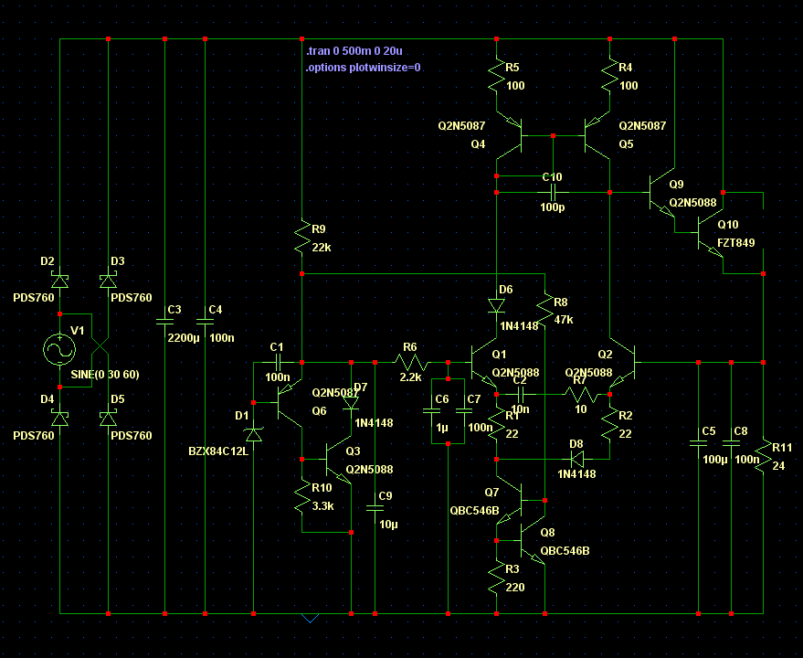

Here are the current specs as simulated:
Output voltage (Vout): 33.5V
Vout Offset from 0A-2A (DC constant-current): ~50uV
Ripple at 2A: ~200uV
Line ripple with a sine-modulated load current between 0A and 2A at 20Khz: 700uV.
Max. Current rating is over 2A, but I have not measured much that far. A current limiting circuit will be necessary, because the circuit oscillates when pushed past its limit. The way to increase the limit is to increase R1. However, I do not know exactly how this will affect performance.
Also, the problem with the voltage rising with load currents below 0.2A doesn't exist anymore.
Attached are two graphs:
The first is the output ripple vs. frequency.
The other is the output trace with a load current modulation index of 2A.

Your circuit -- I will build (lashup more like) and try it. I am only going to use a 0 to 30 volt PSU as a source and a selection of different voltage zeners for D1.
Walt Jungs circuit puts the reference in the emmiter side of the error amp, the output voltage set by the feedback network R861 and 863. It's similar- ish to yours but look how Q853 is connected (collector).

Well out of interest, here is what happened. The output is a sawtooth the amplitude of which is set by the zener. See picture, this is 12 volts peak/peak amplitude at around 125 khz. The frequency varies as the input volts is altered.
Sounds like you need a proper stabilised, fully adjustable lab PSU and (maybe 🙂 ) try something a bit less ambitious to begin with. An adjustable PSU was one of the things I made first, from a design in a mag -- many years ago now.
Providing you can get someone to check any mains wiring first, at some point you have to go for it and have the confidence that what you have done is safe and correct.
Good luck with it all
Regards Karl

What components did you use? It looks to me like R3 was disconnected. In this circuit it is important to use components with as low parasitic capacitance as possible... I am currently trying to build it. I managed to pull a 12V zener out of a computer PSU, so it will be powered by 24V out of four 6V lantern batteries.

I used TIP41A for the pass transistor and BC546 and BC307 for others. R1 initially at 82 K . With a 24 volt supply the regulation was poor under load ( I used 15 ohm as a load ) and R3 was 27 ohm. Reducing R1 down to 10 k improved the regulation greatly.
At 82 K the output fell by a volt or more when loaded with 15 ohm.
The only way to stop the oscillation ( at a basic level without adding caps etc) was to remove Q5 and connect the collector of Q7 to the emmiter of Q3.

Hmmm...
I think it is a good idea but when it gets to it the PUT pair is just to sensitive to be used in this way. I'll keep working though, and see if I can figure something out... It worked great in the sim though. 🙂

keantoken,
The "PUT pair" is really more like an SCR, because the on resistance of an SCR is much lower than a PUT.
This circuit will inherently oscillate due to the latching action of Q5 and Q7. When these transistors turn, on the base emitter junction of Q3 becomes forward biased and the emitter current of Q2 becomes Beta_Q3*(56-2.8)/R1. In addition, the base of Q1 is pulled low and the zener no longer conducts. Then the cycle repeats. C2 and the natural response time of the circuit components will determine the oscillation frequency.
In order to get this circuit to work, delete Q5 and increase the value of R3. Q3, Q4 and R2 aren't required either. I know, this looks just like any other seires pass regulator.

Keantoken,
Ops, I made a minor error. When Q5 qnd Q7 turn on, the emitter current of Q2 will be limited to Vbe3/220 or about 3 mA.
The rest of what I said is correct.

Okay, what you say makes perfect sense. I only tried to use the PUT pair in this way because I observed (on the simulator 😛) that if the base current was regulated precisely, it would not latch.

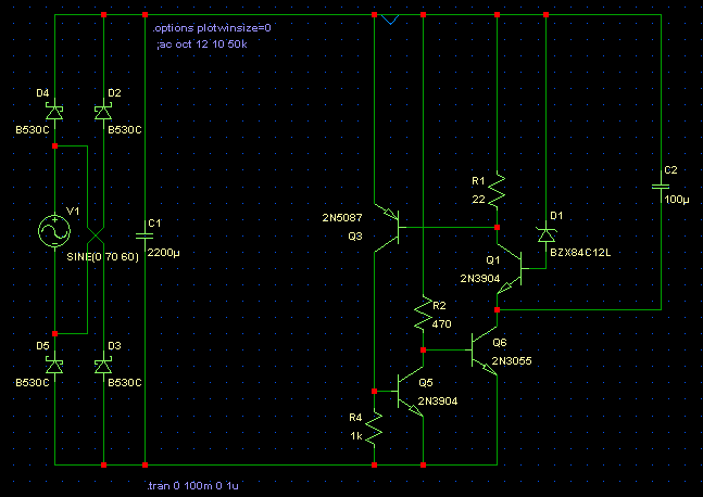

keantoken said:Hi.
I've been tweaking this design for quite a while now, and want to run it by the DIY community for feedback or suggestions. I have not built it yet, for lack of parts.
- keantoken

Hi lineup. 🙂
Hmm. I've seen regulators using an LTP as a comparator, but for some reason I didn't like the idea... I think I'll abandon my previous design. It'll stay in my archives for interest, though...
At any rate, I coughed this up shortly after reading your post. D8 is to cancel the extra voltage drop of Q8 in the voltage reference, with D6 to equalize the currents in the LTP. C10 is required to keep the circuit from oscillating. :/
This is the first thing I though of. The CCS of the LTP is powered from the voltage reference. I'm not sure if Q9 is needed, but it extends the HF response of Q10, which is why it is there.
Is my logic correct so far?
At any rate, thanks for the circuit.
- keantoken
- keantoken

will screeeew their figures.
I attach what I use, when I want some better Reality, than PMA.
A simulated REAL Power supply.
Using numbers in the transformator Inductor core,
that I have measured on one Real Trafo I have.
Lineup regars
D1, 1N4148 is the trick in my circuit. Very much Nice feature.

I know what Diode D1 does . Think about it ?? Where does the reference get its supply from
I know that, anyone who spends time on a regulator project usually does this. But I thought that there was something about the voltage drop caused by the diode or maybe its characteristics... Temperature compensation?
At any rate, I just put this together. It's actually no different than my first circuit except that it's simpler. It seems to work just as well too, at least in the sim. I've got it built and it's running on a 24V 4-pack lantern battery PSU. I'm not really sure if it's working correctly, I just know that I get some voltage when I flip it on. Probably something like 0.6V... At least it doesn't oscillate. 🙂
I actually fried everything but the 2N3055 when I first turned it on... Output is between ground and the collector of the 2N3055... Notice where ground is... I only did this so I could measure values on the sim easier.
- keantoken
It works! Output stable at 13.2V into 1.2K load...
I've yet to test very far, but it looks like Q3 has problems firing at random times...
If someone else wants to test, be my guest. Hmm. I need a variable current source for testing load... How much current can a breadboard take? That would be very useful about now...
- keantoken
