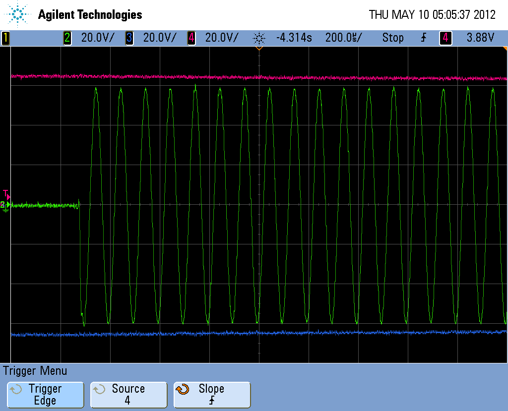

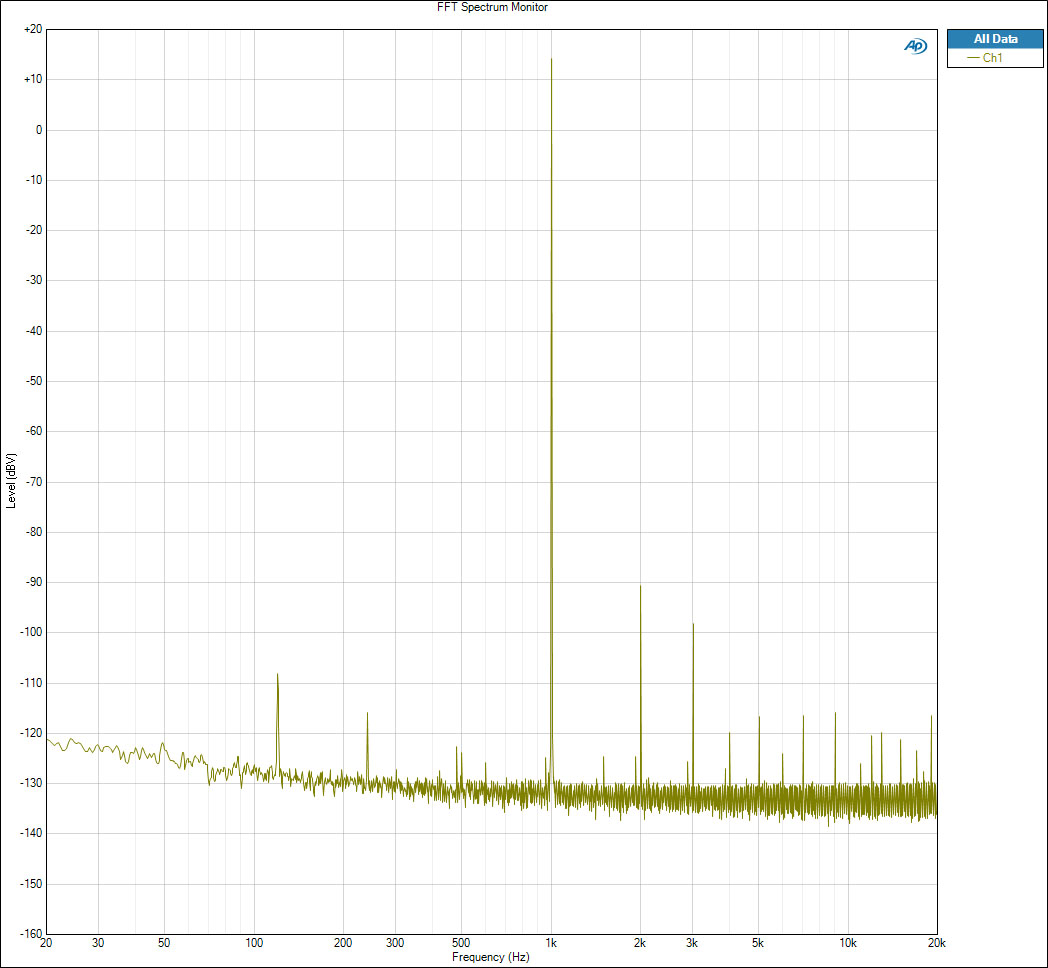

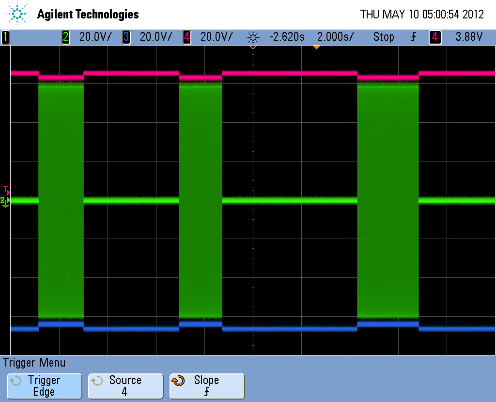

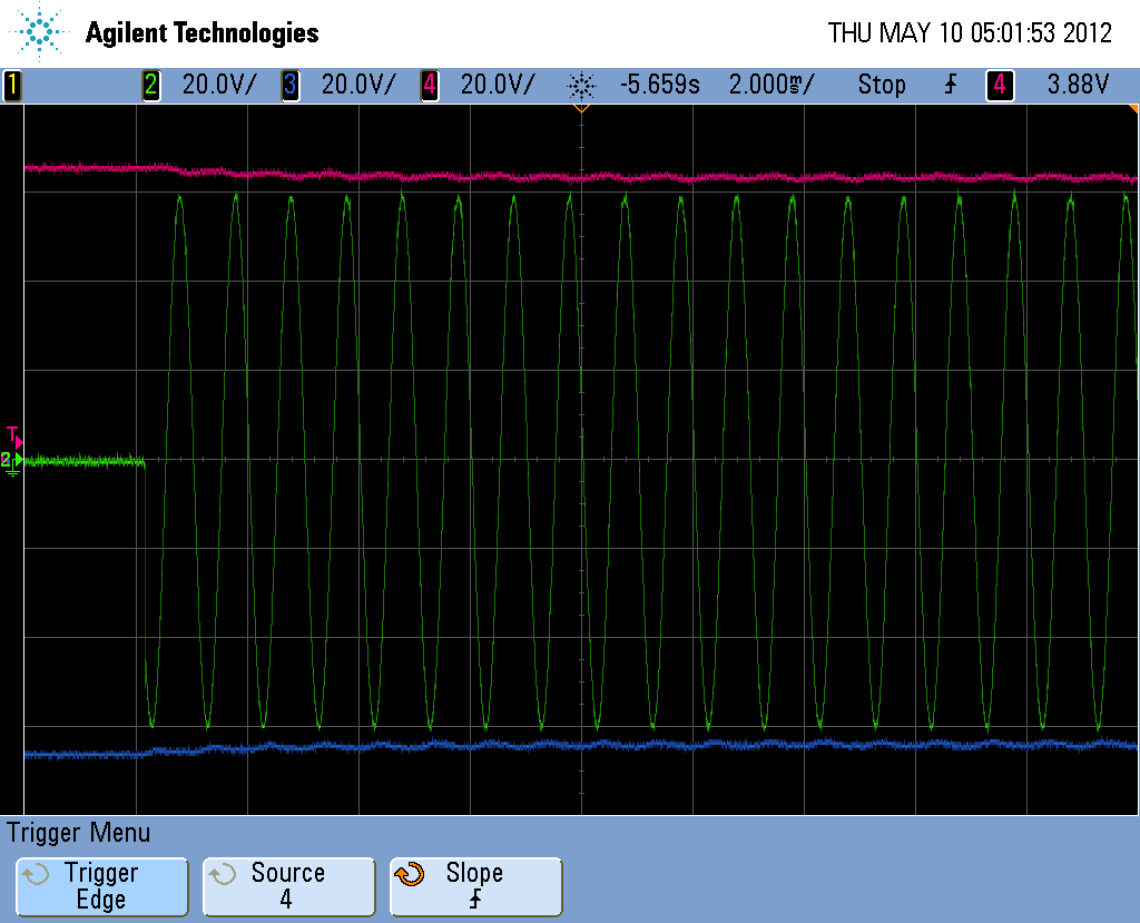

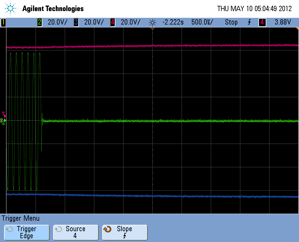

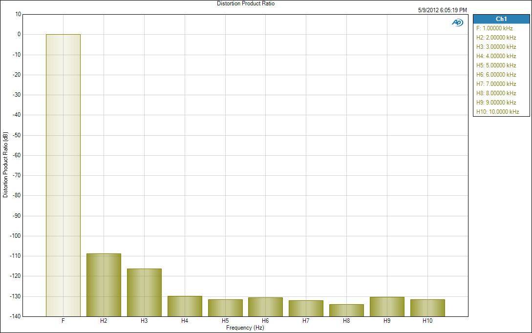

I really think you need to look at those measurements of the wire powered by DPS-600 and then tell me theres no advantage to regulated. I didnt buy them to save money, I bought them because the performance was spectacular and i'm building a multichannel amp so size matters
actually here i'll link some. show me a linear unregulated supply with that sort of performance and i'll show you something that costs more and is 5-10x the size. it would have to be an exceptionally well designed unregulated supply at any size/cost.
i'm sure it can be done, but in particular the full power (250W) pulse at 100Hz and lack of under or overshoot on the start/stop at 1kHz measures (this is of it actually powering the amp, red and blue traces are the rails) it would be a tall order. swing in this case is +/-65v, 20v divisions and noise is dB/V
