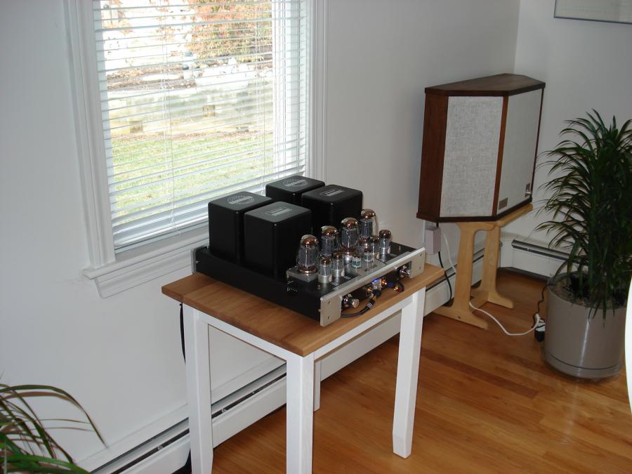

The 6SN7's sound terrific!
I ended up putting together a ( 12 volt ) bucking transformer to knock down the line voltage a little. My line voltage can run as high as 128 v and a low of 123 v which is way above the recommended 115 v.
Now with the line voltage running lower I'm curious if I can raise the KT88's bias a little bit higher than the recommended .55v to .65v? Well maybe that's getting a little greedy!😀
