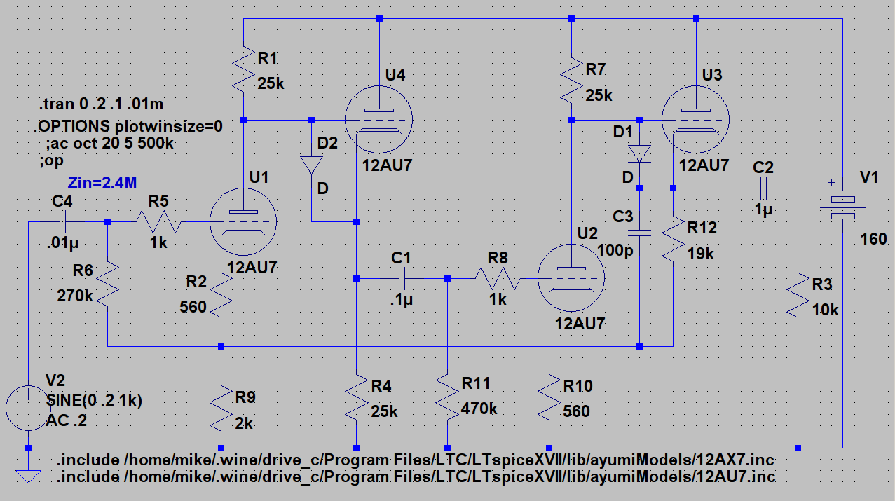

Has anyone done a two stage with dissimilar triodes (with or without the follower)? In certain situations might there be a use for a high mu low current first stage and a low mu higher current second stage? The first stage gets your gain early and low mu second stage has more input signal swing room. Second stage also presents less Miller to the first stage. If the subsequent circuitry has a high enough Zin the higher current second stage may be able to drive a bit more capacitance without a follower being strictly necessary.

...one weak triode running Miller capacitance of the second one plus 47 pF.
Just counting on thumbs: that first stage is 2X faster than a '741. BUT the second stage has gain near 50, so the output (where we care) is 100X faster than a '741. Say 50V/uS. By Jung's old studies, 1V/uS per Vpeak is a good minimum for audio. We are not likely to be close to 50V peak here.

1 mA/150 pF is about 6V /uS, also not quite symmetric. It was considered as fine then, but not according to my modern standards.
A stab at doing the utility preamp using CCDA principle. Note that the Ceramic/Tape switch is not shown. Also the final stage load resistors don't match but idle current does. Given the slightly different bias layout I expect that some diddling with R values will be needed at build time.
OK, accepting 6V/us at the *second grid*, then this is gained-up by the second triode about 25 times, to make 150V/uS *at the output*. (Which is where we care.)
It is possible, but difficult, to make a triode amp "slew". The very heavy NFB here (~~40dB) does shift the closed-loop pole up while not helping slew rate.
In "simulation", I see ~~1MHz closed-loop bandwidth(!). Fed hard with 1Vpk 400KHz square-wave I get 20V/uS, not "slew", but simple exponential. It is bandwidth-limited, NOT slew limited.
Pushing harder, FAR beyond what a preamp should be expected to do, I do see slew (and your predicted asymmetry!) at levels 5X higher, 30V peak. 117V/us rise, exponential fall. Indeed a 30Vpk 400KHz square-wave is ugly. And also nothing I would ever want coming through a hi-fi preamp.
BTW: the two 47pFd caps and the nominal C of the tubes *appear* to be non-optimum out around 10MHz, throwing tall spikes. Making the C in the NFB loop 10pFd smooths it out. I don't trust that answer: I did not model the many layout strays or any cable on the output.
Thank you from McIntosh. Your simulation rehabilitated them. 🙂
