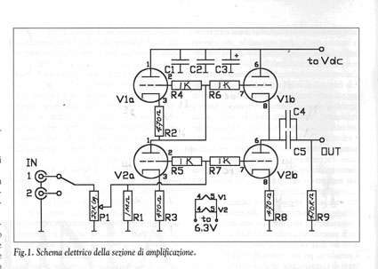

Line preamp using 2 ECC88 per channel
Line preamp using 2 ecc88 per channel
This circuit is taken from the Stereo VOL:66 march 1995 (Hi-Fi magazine published in Italy) and presented by Fulvio Chiappetta.
V DC=225V
Both tube V1 & V2 =6922 or ECC88
C1 100nf 400v
C2 2,2mf 400v
C3 1000mf 400v
C4 100nf 400v
C5 2,2mf 400v
Specifications:
Amplification factor:20dB
Input resistance:22k
Input capacitance: can be omitted
Output resistance:< 100 ohm
Distorsion in audio bandwidth@ 1 Veff: II harmonics -62dB
III harmonics -68dB, IV harmonics -75dB V harmonics -81dB
Signal and noise ratio @1 Veff out: 90dB
Max output voltage:>100Vpp
Please debate and discuss this circuit, factors that affect this
circuit in term of electrical behaviour & etc that contribute to stability and sound wise.

It's not really a line preamp at all, gain is too high, so high it could actually overspec some SS amps at 100Vpp. It's a high gain input section. Even the caption does not call it a line preamp.

better way for line stage (even if gain with 88 is on highish side) is to use two systems in one envelope in parallel,and make that line stage as anode follower if Zout is adequate;
if lower Zout is needed,than CF must be used-say-just one system of 88 for that (1 per channel 😉 )
one bottle per channel in WOT configuration is almost a killer!

It looks to me like the quoted distortion figures are a bit optimistic. For 1V input signal and 250V B+, it simulates to about 0.5% THD (-46dB). This is a factor of three lower than standard resistor-loaded common cathode stage would give you at the same bias, but the effect is almost entirely due to the negative feedback through unbypassed cathode bias resistors. The power supply noise rejection is nothing special - the usual 6dB. The output impedance is low (the output stage being cathode follower), but the bias current is only 6mA, so it will only drive 5k load at rated 100Vpp output (clipping sets in abruptly at about 4k load).

but the signal of the two drive are unequal....
Yes but they should be unequal.
It is a SEPP where the drive signal to the upper tube is taken from the SRPP stage in front.
A SEPP is unsymmetrical as the lower tube has higher gain than the upper tube and the idea here is to compensate for this difference. However the gain difference in the SEPP is not the same as the gain in the SRPP and the gain in the SEPP is dependant on the load the result is distortion even at quite low ouput levels, if the distortion level is given at 1V output level it is probably what can be expected.
There are other better circuits available that can compensate for the gain difference of the SEPP, my favorite is the inverted Futterman which also will give lower output impedance.
Regards Hans

You can see some variations of SEPP drive circuits here http://www.tubetvr.com/otl.html but I should make clear that I would never use a SEPP for a line amplifier as I don't see the need for that.
My own line amp has an output impedance of about 1 ohm without a SEPP but I rely on feedback which is not everyones "cup of tea".
However, a SEPP using inverted Futterman drive circuit is a good choice for direct driving headphones, see here http://www.tubetvr.com/headphoneamp.html
