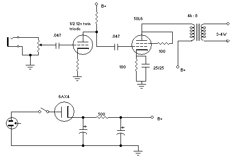

I thought this one up last night.
I don't know the values for all the stuff, and I know the 50L6 isn't very "hi-fi". Now I need some low Z tubes and I can figure out some kind of completely transformerless design....
Anyhow, I know it's evil and a deathtrap. Just thought I would share it anyways😱
Any thoughts?
edit: forgot to put the "only one channel shown" deal in there.. wont be able to run it off the wall with only one channel..

Here's a circuit by Steve Bench that avoids the "death trap" rap - http://members.aol.com/sbench/50c5.html
He uses an input transformer to isolate the circuit from the line. The grounded power cord and grounded secondary of the output transfomer make this "safe enough" that it could pass the current UL or European safety standards.
He says 3.5 Watts, but it would do more into 4 or 16 Ohms - though it might not be flat down to 20 Hz any more.

I worry about posting stuff like this without a huge warning over top of it. You'd be surprised what people will try to build.
Or post away and call it evolution in action?

hahaha.. should be ok if you use a polarized plug, and check to make sure the house is wired right.. 😀
I think I forgot to put in some grid leaks.. hmm..
yeah, i suppose so.
maybe an isolation tranny would be a good idea.

Colt45 said:maybe an isolation tranny would be a good idea.
i collect up the old CSA ground fault isolation plugs and salvage the transformer out of them. Experience says use a separate one for the heaters.

Add a second rectifier tube to make a voltage doubler rectifier. 100 / 120 Hz ripple, nicer to the mains, and twice the plate voltage. 🙂

Circlotron said:Add a second rectifier tube to make a voltage doubler rectifier. 100 / 120 Hz ripple, nicer to the mains, and twice the plate voltage. 🙂
In the 50C5, 50EH5 amps i am using these in, i use a SS bridge (gotta keep the filaments adding to 120V). These tubes were designed to run off not much more than 120V. I'm not sure about the 50L6 -- although i do have one of those in the parts pile.
dave
