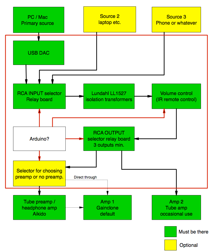

For a while now I've been thinking of building a relatively comprehensive remote controlled line level selector box with an integrated DAC. The other day I was browsing fleabay for cheap prototyping parts and I made a simple flowchart of what I'm looking for:

Can you spot any major flaws with the idea? Any similar projects here on the forum or elsewhere? This will definitely be done on a budget at first so I'm not interested in elaborately priced commercial products which I know are already out there. There will also be a speaker switch in the same box, but I didn't put that in the flow charts. My manual switch box already has that.
