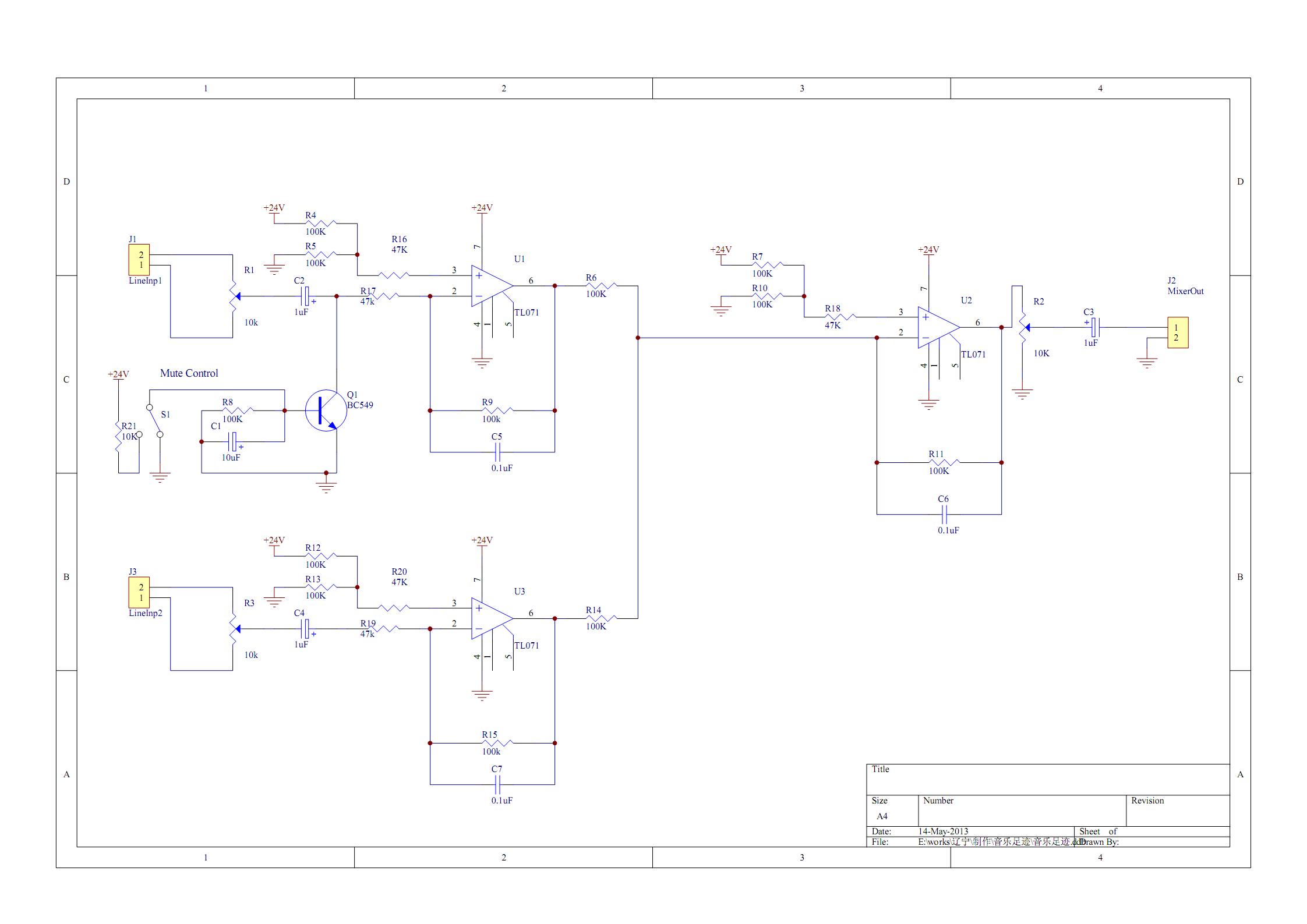

this is circuit picture.I means is when mute control switch to left,Q1 can turn-on slowly.And ,the signal on LineInp1 fade out.

I'm not so sure the transistor would fade the signal as you want. It would tend to conduct fairly quickly as the base-emitter junction come into conduction probably introducing a lot of audible distortion in the transition period. Even FET's do that to some extent.
C5 and C7 are far to big. If you need them at all then somewhere around 10 to 47pf is suitable.
Edit... and C6

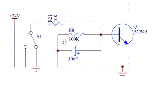

When the mute control is switched to the right, it short circuits the 10uF capacitor. The high current can cause a small arc in the switch. After many switchings, the switch contacts may be damaged.
It may be better to move the 10K resistor like this:
