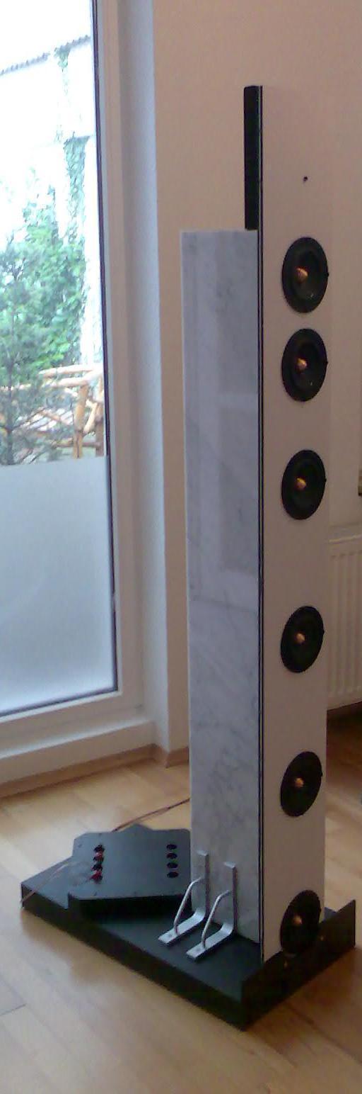

If one cannot avoid interference effects due to driver
distance
-not only center to center but also "edge to edge" since
the effective cone diameter shrinks with frequency due
to non pistonic motion, making the 80% coverage
ratio proposed by Griffin impossible to achieve even for
tightly mounted fullrangers at higher frequencies -
maybe thinking about equidistant mounting being more
a problem than a solution in full- /widerange line arrays
would help ...
Interestingly the need for crossing to a tweeter
(or an array of tweeters), arises from driver
interferences and array dispersion issues, but not
necessarily from bandwith of the wide- fullrange
units being limited.
Instead of solving the problem at its root, further
problems are introduced by going multiway.
Surely kind of "good integration" could be achieved in
some multiways ... to avoid that "integrational effort" by
design seems by far more interesting to me.
Yes i see: Multiple drivers more than a wavelength apart,
cannot work, crazy guy ...
I invite you to examine the vertical dispersion of an
"dipol 08" like design in any common simulator and
compare it against equidistant line arrays due to
"useful vertical listening angles".
Assume the real driver edge to edge distances depending
on frequency, do not assume pistonic drivers, as this is
nothing but wishful thinking.
Not to talk about comparing the horizontal dispersion to
a 2-way (and two line) line array, as horizontal dispersion
often is neglected espacially when designers are too eager
to achieve a certain kind of dispersion in the vertical plane.
With "dipol 08" as an example, please note that the lower
3 drivers are continuously rolled off above above 2Khz.
Using an active solution, even the upper 3 drivers could be
reduced to one single driver in the brillance region.
Kind Regards

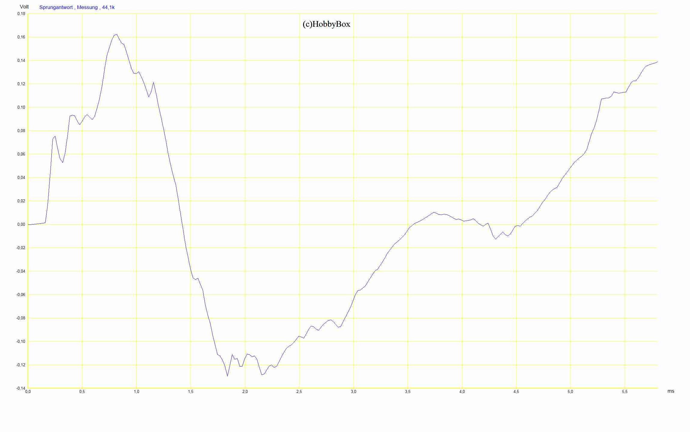

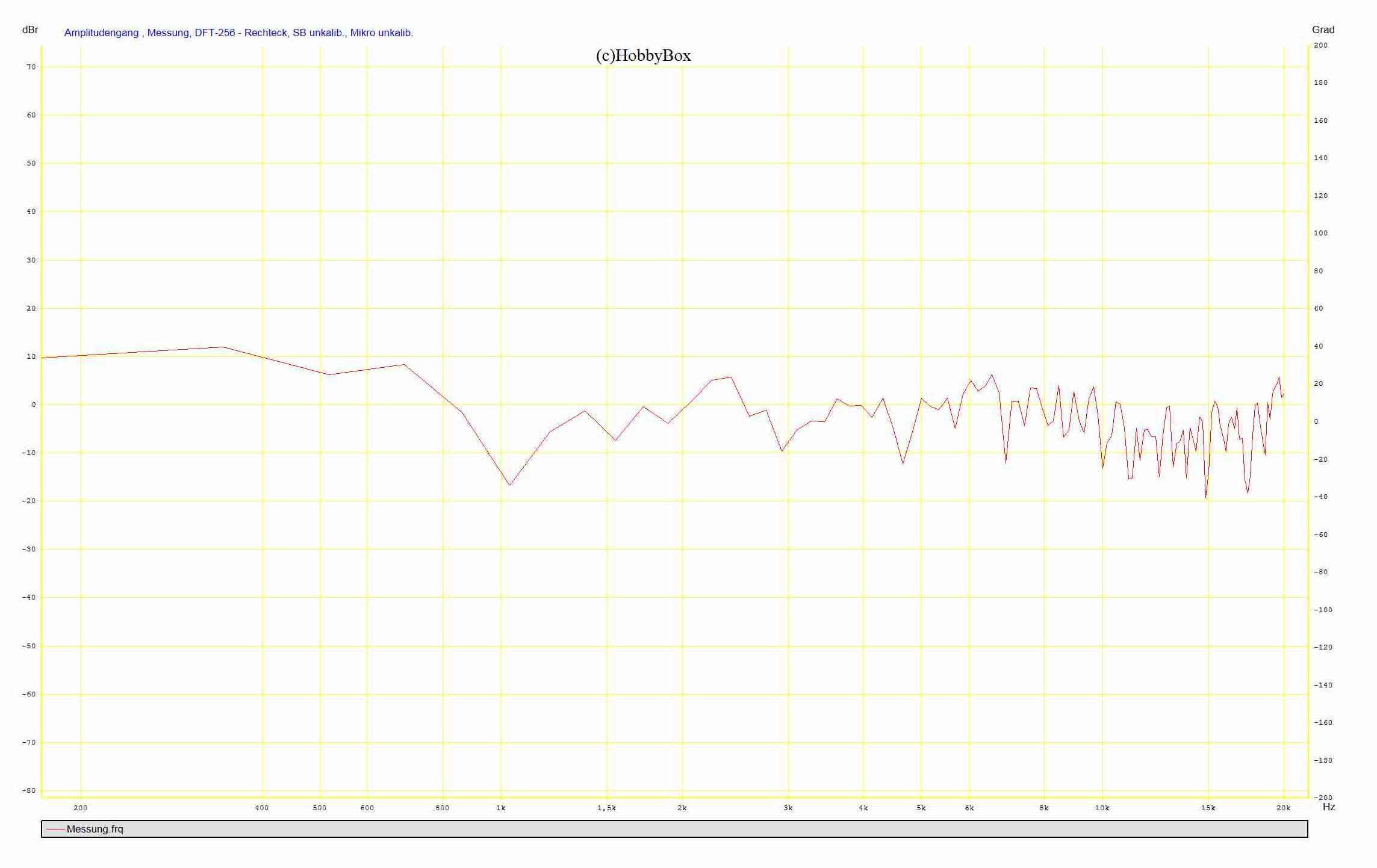

This unsmoothed FR is taken in 1.5m distance in front of
the dipol 08 array with the microphone placed on the
bottom, which is about 40 degrees off axis (below) vertically
but on axis horizontally, since the acoustic "center" can be
seen close to the second driver from above at about 1.2m
height.
It does not look beautiful surely, but i bet most would have
expected worse at that vertical angle and below the drivers
reproducing the highs, as this is the "LF side" of the array.
It is something like a "worst case FR", and this is not even
a relevant (and only hardly possible) listening position.
The corrsponding step response's long tail is due to a
fairly reverberant room (the FR is gated) but again i
have seen worse ones - even from single fullrangers
on axis ...

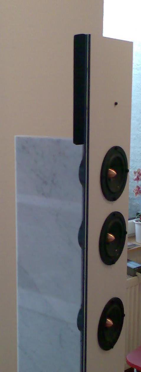

Hi darkmoebius,
seems you have made a vertically compressed version of "dipol 08" ... 🙂
It must have been in the early 80's when i first read about the golomb
rulers in the german edition of "Scientific American".
I must have been around 18 when i built a quick setup using 4 cheap
fullrangers attached on an adjustable frame. Each fullranger had its own
small cabinet and baffle.
Left and right speaker as well had 4 drivers, positioned at distances
proportionally to a golomb ruler of length 4.
The setup sounded very homogeneously in my small room, and even though
the drivers were far apart (height of the assembly must have been around
1.2 meters) there was little subjective evidence for listening to multiple
drivers, as long as if you did not listen too close.
The sound was balanced and "naturally spaceous" which was difficult in that
small room of my youth, which had about 12 sqmtrs only.
Then the idea was sleeping for about 2 decades. I built lots of speakers
meanwhile, mostly 2-Ways, and i was experimenting with self built ribbons
and line sources made from these ribbons.
I noticed with the years, that dispersion characteristics and room
interaction has more influence on the sonic result, than the "type of
transducer". The difference between an ESL and a dynamic 2-way is mostly
due to dipolar radiation and directvity ...
I wanted a speaker which sounds the same, even when placed in different
rooms. A high goal and not fully achievable, but you can try to come close.
Combining the dipole and the line array approach using fullrangers came to
my mind ... and i have not been the only one as i can see.
Fullrangers having "bass capable" size cannot be mounted "acoustically close"
for higher frequencies as their center to center distance compares to wavelengths
radiated. As i pointed out before, additionally the active cone area shrinks with
frequency. That means mounting "as close as possible" does not solve the problem
of interference and comb filtering. Also a line source with >80% of its length
covered with "pistonic" motion is not possible ... as the 80% ratio is e.g. given
as a minimum coverage of area in the paper on "Practical Nearfield Line Arrays"
by Griffin.
On the other hand for low frequencies, no close mounting is needed in a
line array. The idea was to have the drivers at distances which "grow together"
with lowering frequency, thereby inherently compensating the rolloff of a
narrow baffle, which is capable of giving horizontal dispersion free from
side lobing.
Then i started some simulations - and my old "golomb" idea came to my mind
again. As i wrote in my german text, dipol 08 is "inspired" by golomb ruler
spacing, but it IS NOT a golomb ruler spacing.
The starting point was an equidistant spacing, capable of compensating the
baffle rolloff, that would be present with a single driver.
Next step was to introduce "golombification" to the upper part of the array,
thereby it's low frequency behaviour could be largely maintained, since the
distances for the 4 lower drivers stayed untouched and the upper distances
shrink progressively. There are other configurations possible, but a decision
among a limited set of patterns had to be made and this turned out to be a
good natured one.
Next step is to introduce power tapering and roll the equidistant part of
the array off towards higher frequencies. That yields in a combination
of "power tapering" and "tapering by distance weighting". Both effects
make the array shrink in its effective size towards higher frequencies,
as the sound sources are more "dense" in the upper part.
Next step was to maintain the dipole radiation up to the highs, which is not
possible when using fullrangers only, since their rear radiation drops above
some Khz, that is what the rear tweeter panel is good for. It is a "fullranger's
rapair kit for rear radiation".
The positions and distances of the drivers were mainly tested and optimized
using "edge". Accordingly a crossover was adapted, since crossover and
distance tapering must go together.
I took some time until i decided for six drivers, but the frequency response
curves at typical listening positions were better than with 5 drivers and
7 drivers did not bring improvement. Also the "3 and 3" approach was going
together well with a passive crossover concept.
Using an active concept, the array could be reduced to just one single driver
in the highs - but the upper trio works amazingly well, even in the brilliance
region, so i would say there is no need for it
(though still room for improvement ...).
The crossover was extensively tested and modified, when the real object was
available (as this is kind of usual i guess ..).
During computational optimization, the arrays bottom mirror image has been
taken into account as an integral part, since there is significant contribution
especially for the bass performance.
Kind Regards
