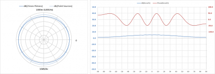

Now that we have a way of plotting out 23 element (or less) arrays with arbitrary weighting "profiles" we can look at the last section of the McIntosh paper that looked at improving the 16 element XRT24. Measurements to that point showed that floor to ceiling array were fairly invariant over a moderate standing to sitting height. But with mid length arrays (the 16 tweeter array was about 1.2 m in length) the standing to sitting variation was considerable. What height do you equalize for when the response is quite a bit different 0.5m up?
Below is the plot of both an unweighted (blue curve) vs a weighted (orange) of 16 elements. Weighting coefficients are 0.32, 0.32, 0.7, 0.7, 0.9, 0.9, 1.0, 1.0, 1.0, 1.0, 0.9, 0.9, 0.7, 0.7, 0.32, 0.32 . (Some zeros preceed and follow this to shrink my model from 23 tweets to 16.) Obviously for the blue curves the 16 coefficients are 1.0.
As you can see the weighted coefficients vertical directivity is considerably smoother and has lost the ripple. As adjacent frequencies were also smoothed the variation vs. frequency and vs. height was smoothed and the axis of EQ was less consequential.
No on axis sensitivity lost here (curves touch at 0 elevation height) but the blue curve has wider directivity, which seems odd as you would think that the weighting coefficients tend to shorten the effective length of the weighted array (from turning down outer elements).

I have something neat I came up with, inspired by this thread. A way to power taper an array passively, with a minimum of components. I'll post the article after work today.
