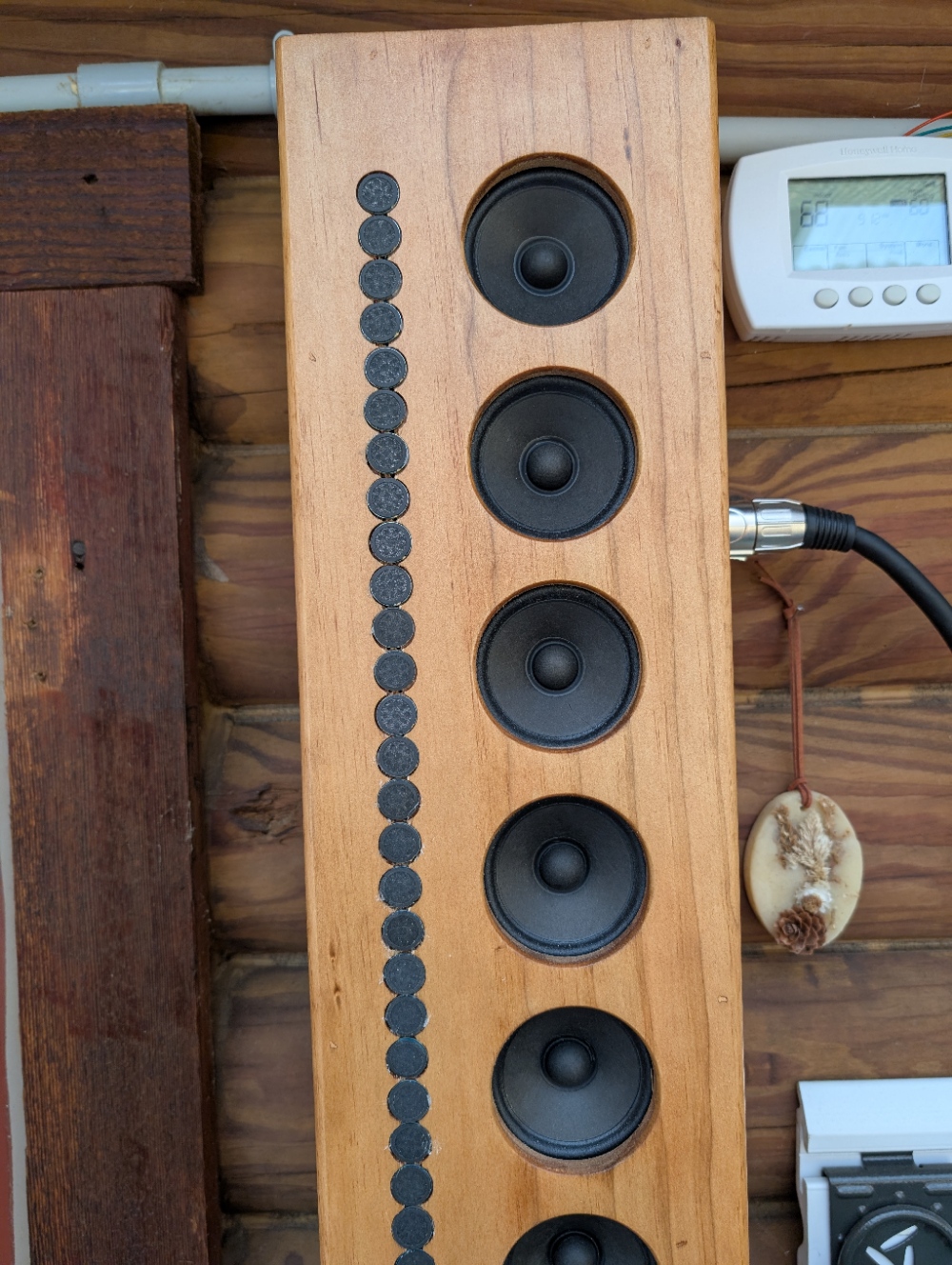

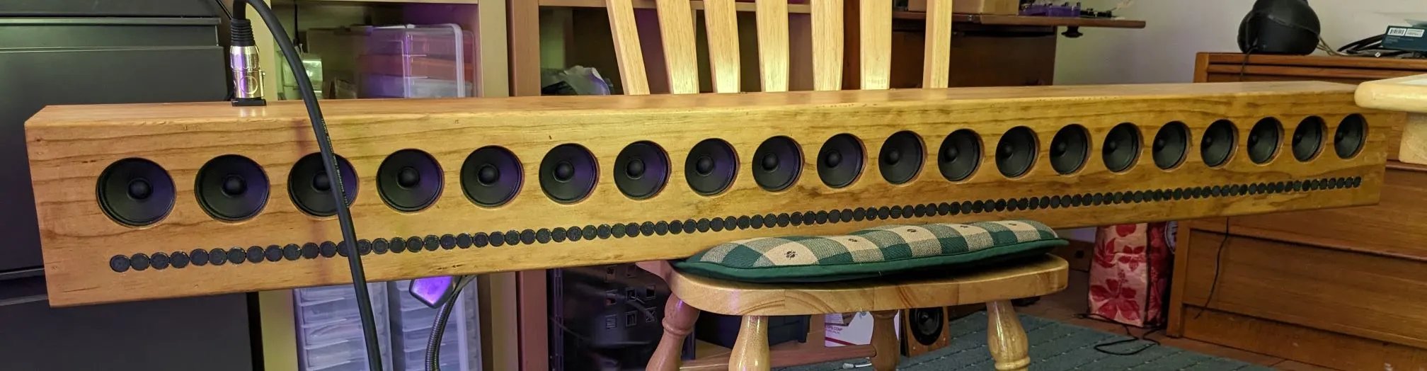

Here's another idea for consideration. I made these and put them in my wife's greenhouse without taking measurements. But damn, the high end sounds clear and there is plenty of it. They use really cheap 1/2" tweeters that you can get for less than 50 cents each in quantity. Maybe we should call this RAST technology (redundant array of sh*tty tweeters). Someday, I'll measure these, but I can say that the approach works far better than I expected. The 9/16" CTC spacing is small enough to minimize comb filtering, and there is enough total surface area to keep excursion low to minimize distortion.
Each tweeter is sitting in a small chamber filled with cotton and then hot glued in place. It takes a while to wire up 96 tweeters (192 for stereo).

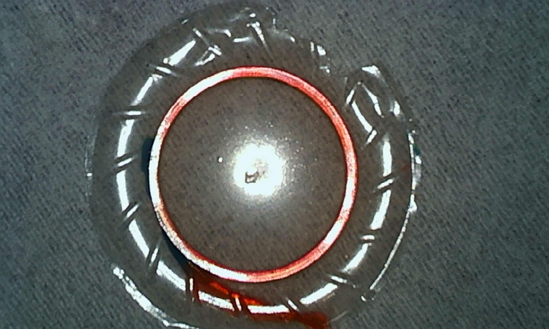

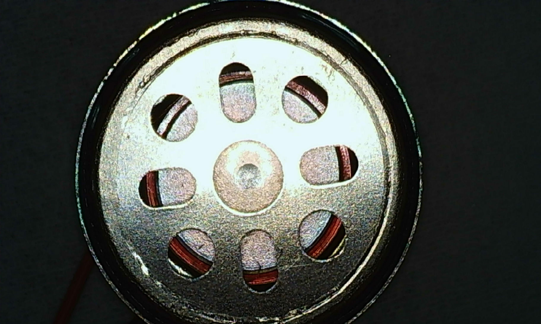

Huh? That SZ-2T looks like the "ribbon" tweeter that Apexjr sold for a while (https://t-linespeakers.org/drivers/ribbon.html). It is 1-1/2" in diameter, and the response is very rough.
The "tweeters" I used were Parts Express #289-2036, but they are no longer available at PE. They were sold as "1/2" Mylar Full-Range" speakers for less than 35 cents each in bags of 100. These are still available, and they might work as well: https://www.parts-express.com/1-2-x-1-Speaker-Pair-50R-A14002-0401-65-289-2032
The ones I used look similar to these at aliexpress: https://www.aliexpress.us/item/3256805913525080.html The 13mm versions are 21 cents apiece. Next time I place an order at aliexpress I'll get some of those and take them apart to see if they are similar.

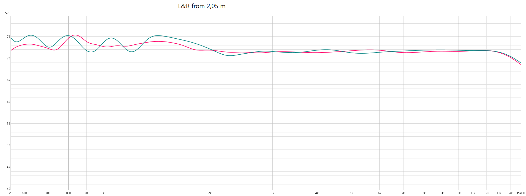

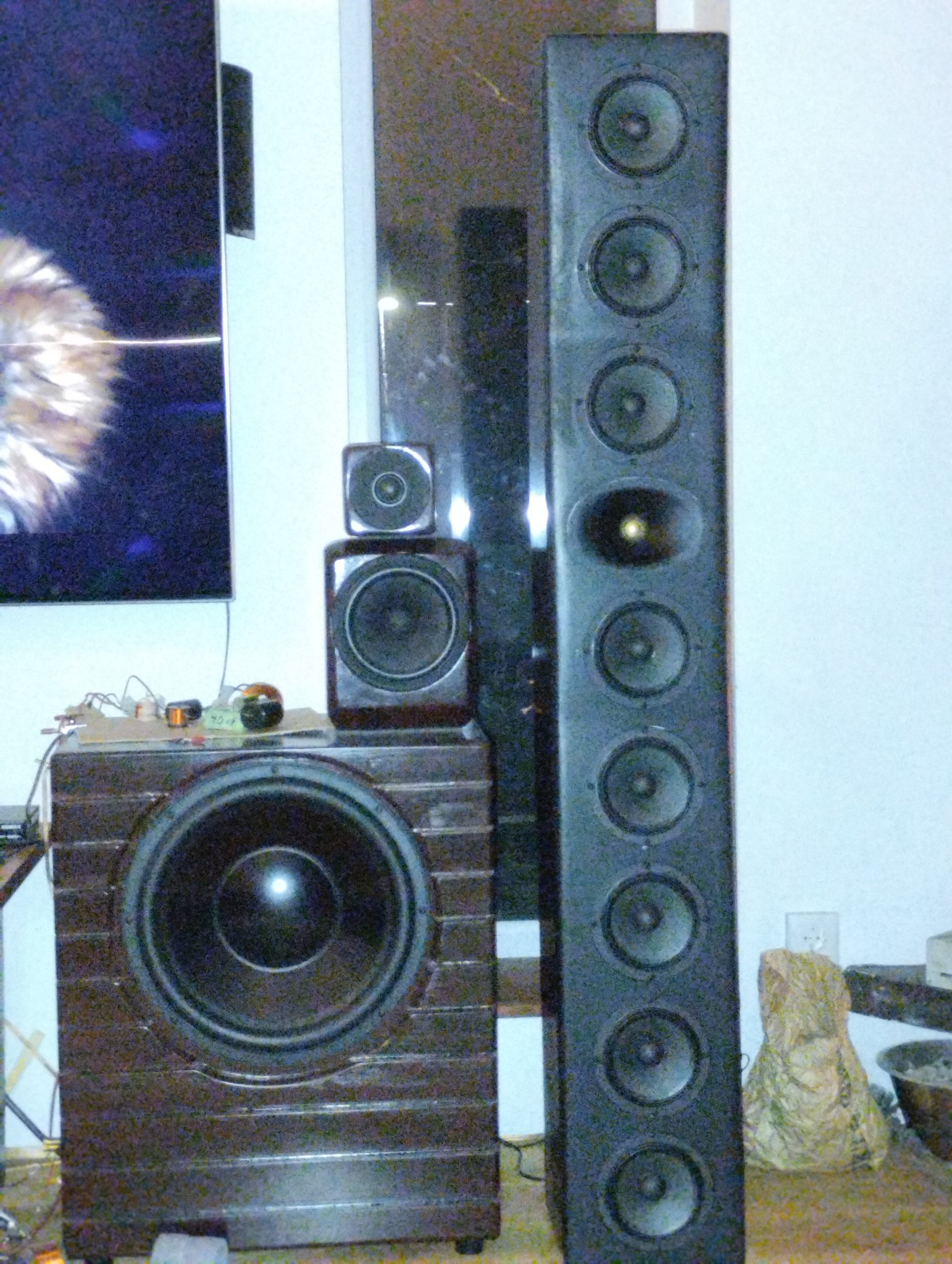

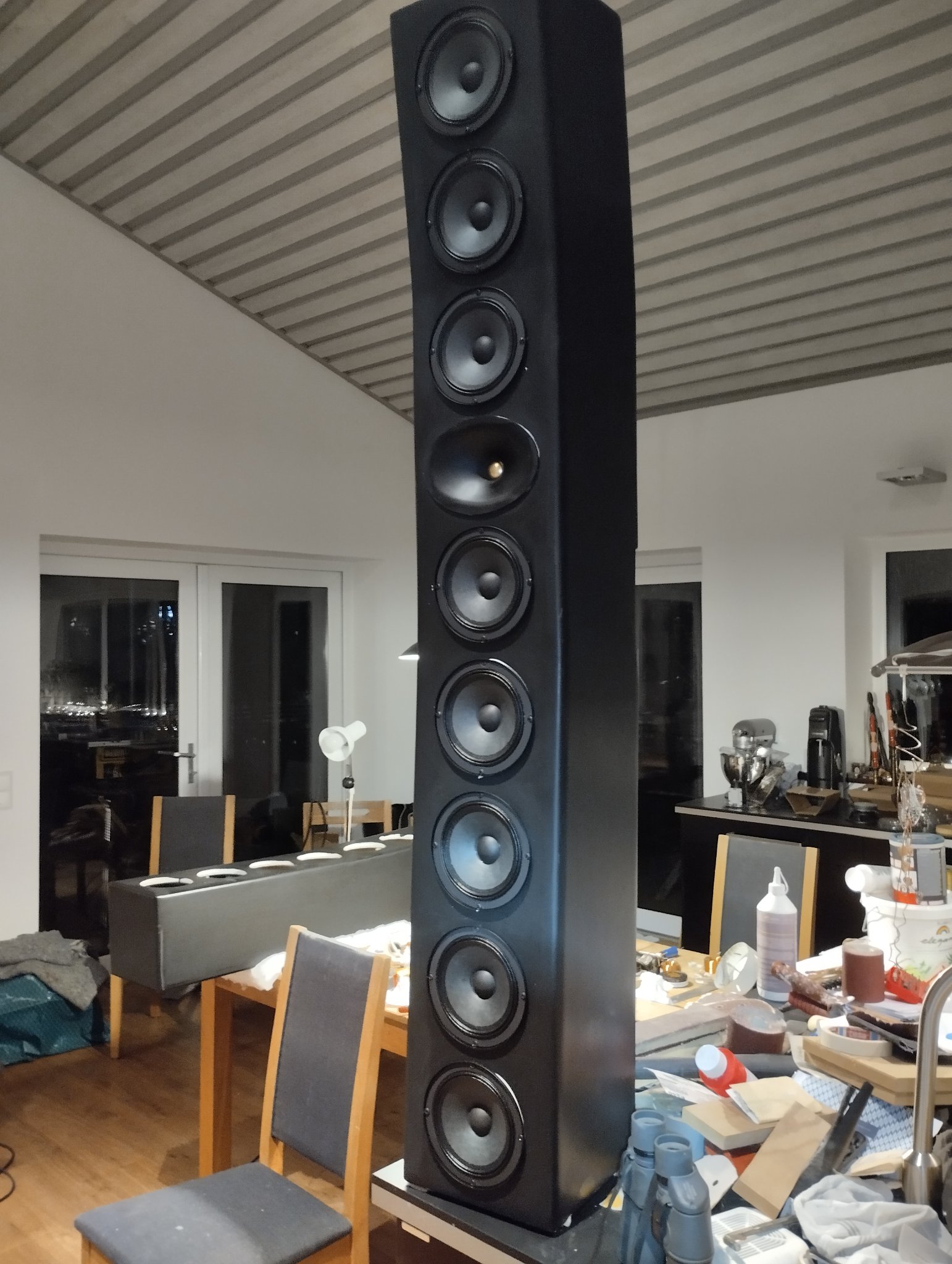

Ivé just build one but with 8 woofers (5,9 inch) and a WG Audax "gold" tweeter.
Are in the final stage with last tweaks now.
measurement from 2,05 m
