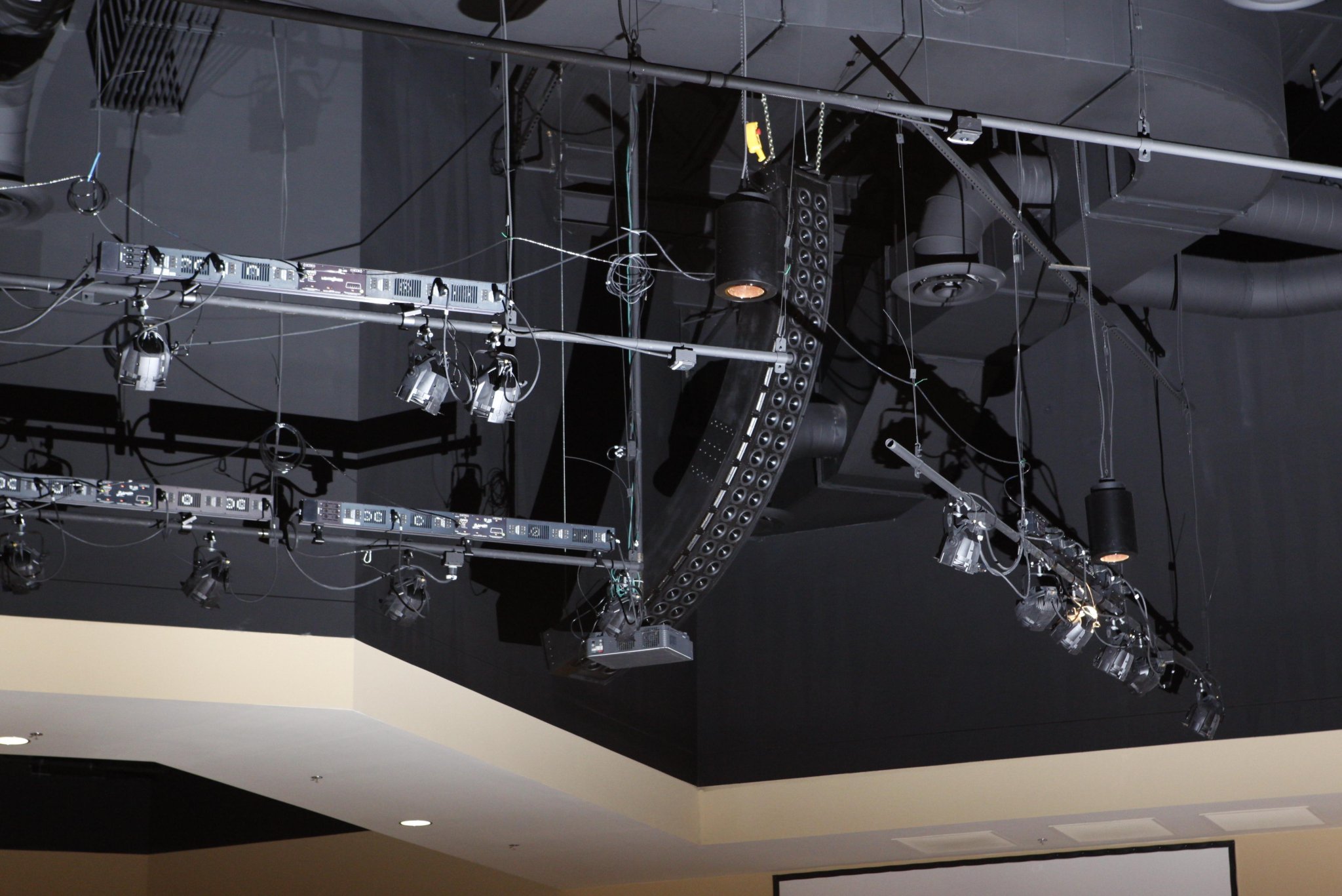

A Bessel array can't accomplish the far throw and directivity of a LA. That means, it's no option for PA use whatsoever.

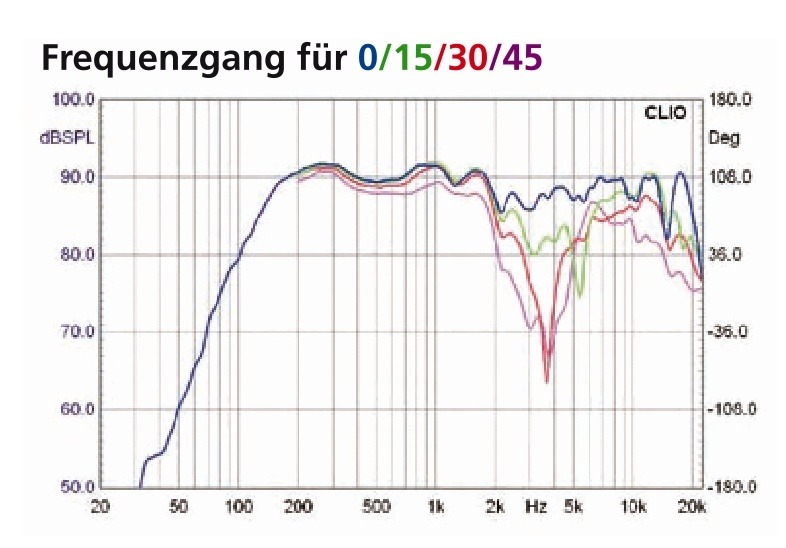

Well, the measurements show where it's lacking. And confirms the horizontal interference.

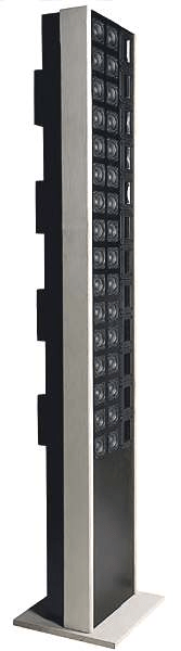

Measurement from Klang + Ton 2/2009 (German diy speaker magazine)
You can say whatever you want but that's a really ugly horizontal interference, caused by the horizontal driver alignment. The subwoofer to this array is bad too, because of the high losses of the drivers it only starts to sound good at high spl. On low level it just swallows sooo many details, it's not funny anymore.
Reactions: mayhem13
For a such expensive array it's a very poor efficiency and horrible measurement. This is one of the worst speakers ever built by Monacor (respective Frank Kuhl, Monacor eployee, who usually builds much better speakers)

Yes, I feel the same! But unlike so many 2-way speakers, that's a horizontal issue, which is much worse in a real-life scenario of conventional 2-way speakers. I mean, if you are going out on building (and paying!) for such an array, you don't get enough of it 'back'. It's simply not worth it! I mean, that Monacor speaker costs 2400€ - without the enclosure! Per side! That's a catastrophically bad bang for the buck and even if you ignore that, there are so much better speakers for that money, even DIY!
A speaker like this needs bi-directional off-axis measurments. It seems that the chart is going only from center to the outside of the tweeter but since most 2-ways perform better below the tweeter, I'd expect it to perform better going from center to outside the mid-woofer array and if you position the speaker so the tweeters are on the outside pointing wide of your head (meeting behind you) they probably measure a lot better than this.
This speaker screams "please please use an active crossover with plenty of EQ and digital delay."
Going to at least LR4 would really have minimized the deep notch seen in the chart. Also, the SPL misalignment at 2 kHz could be inherent in the midwoofer instead of a driver level misalignment since the off-axis notch is at around 4 kHz, but.... hard to say without seeing more.
