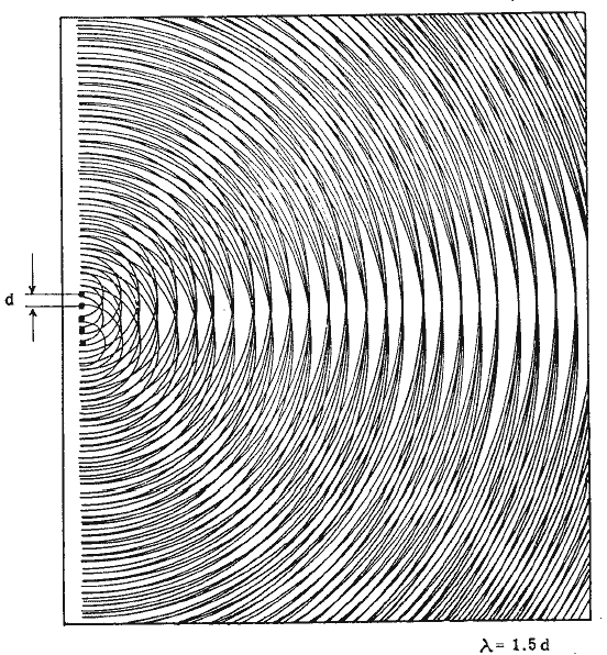

phase problems? can You elaborate on this a little please 🙂Scottmoose said:
Fair play, & this solves the SPL issues at either end -unfortunately, it does little about phase problems associated with this arrangement (see the above image Dave posted, a measure done by one of the godfathers of the array concept)
are they comparable to phase problems caused by midbass(midrange)/tweeter crossover? and by positioning the midbass and tweeter lines laterally side-by-side?
yes, I agree, I was saying in more general terms, line arrays with many drivers are less or more 'tortuous' for me. I am not an amateur cabinet-maker, just a music lover 🙂Scottmoose said:

graaf said:phase problems? can You elaborate on this a little please 🙂
Re the first, I'd suggest you take a look at the diagram Dave posted, and read through the paper it comes from, along with Jim Griffin's, and those put out by JBL. Note that the off-axis response will suffer earlier than the on-axis (in fact, it will narrow the latter). XO's are a different issue; they have their attendant problems (which is why I don't generally like them in the telephone band), albeit usually less severe than those you could expect from, say, a vertical line of FR units with the outputs lobing. YMMV as always. As for twin lines, it's going to depend on the layout & if you designed the spacing etc. right.
graaf said:yes, I agree, I was saying in more general terms, line arrays with many drivers are less or more 'tortuous' for me. I am not an amateur cabinet-maker, just a music lover 🙂

graaf said:but crossover means phase problems, doesn't it?
Indeed they can, although again, it's a case of balancing the evils, and selecting where you'd prefer there to be a compromisein the XO or with the driver outputs? As I say, I normally dislike XOs in the midband, but it depends on which compromise is least likely to drive you up the wall.

Ideally the XO point is determined by the midbass driver spacing and each driver has response on either side of that. If you can get the Peerless mounted with 3" c-c spacing then the absolute max XO is 1 wavelength = 13560/3 = 4.5 kHz. Half that is better. Unless you use 2" drivers you are landing in the critical range in a line-array.
How low do the magnepan ribbons go? I'd be tempted to start by using the XO already in the maggies.
Also keep in mind that the sonics will probably benefit from having the maggie ribbons cover as much of the range as possible.
