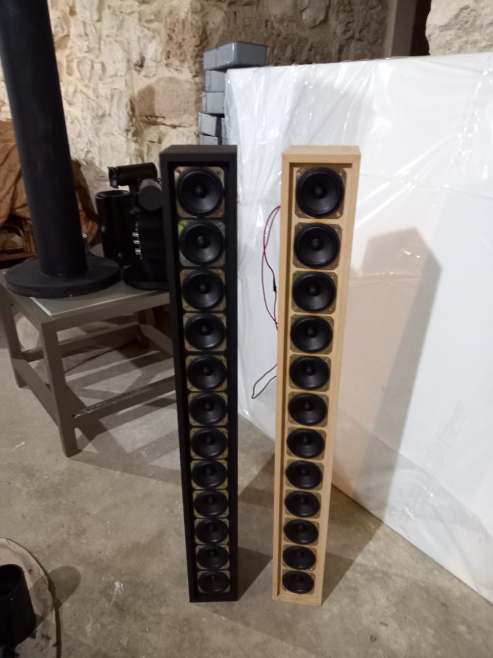

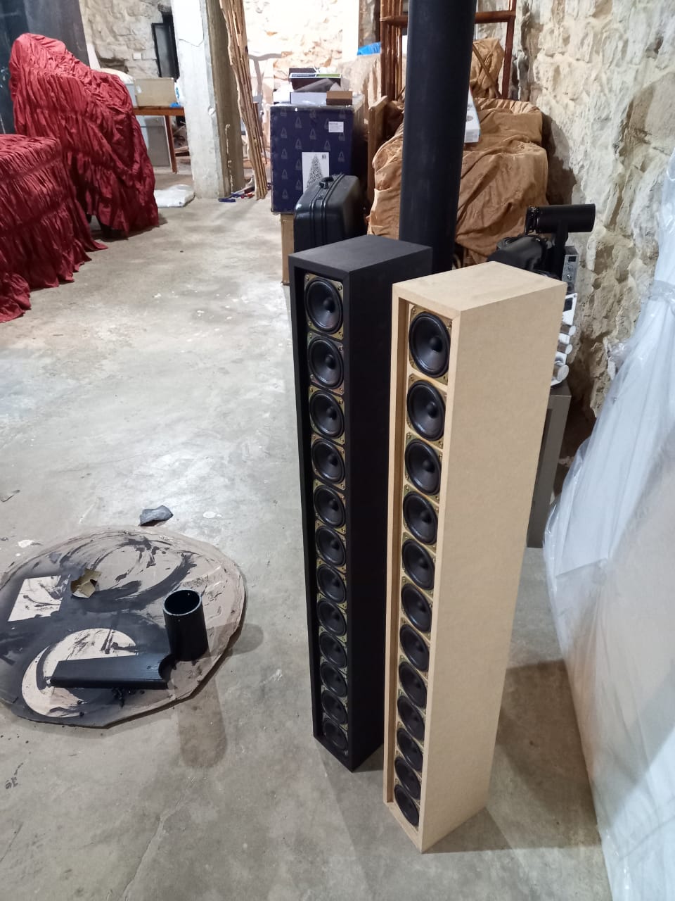

so i've bought 24 drivers, 2 dollar cheapos from parts express, 3 inch fullrange drivers, good from about 200 hz till 10 khz,

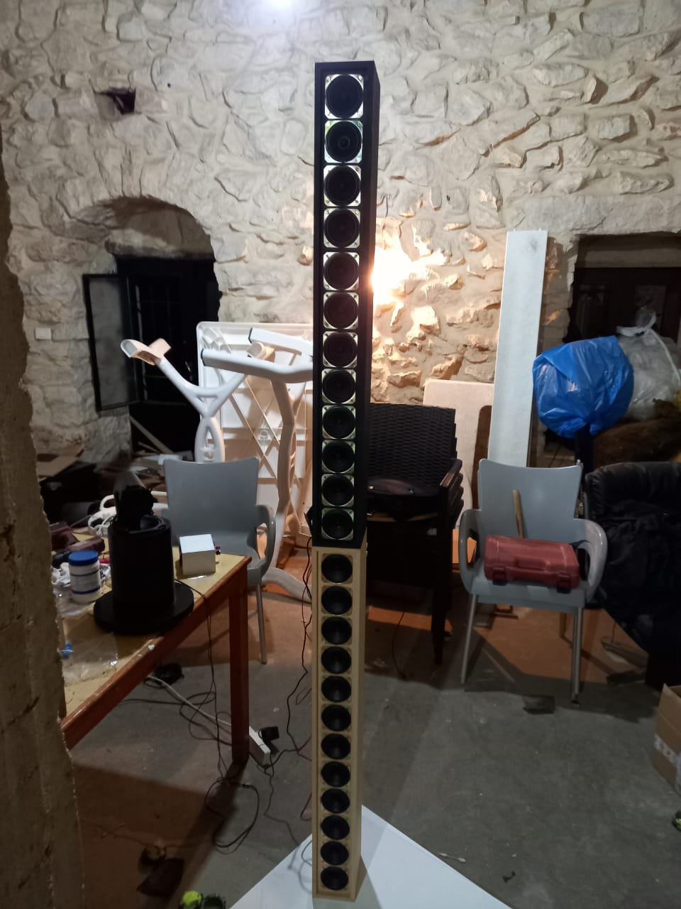

I built a 2 meter high line array , driving it with a 14 watt lepai amp, applied a HPF and LPF at 200 hz and 12 khz

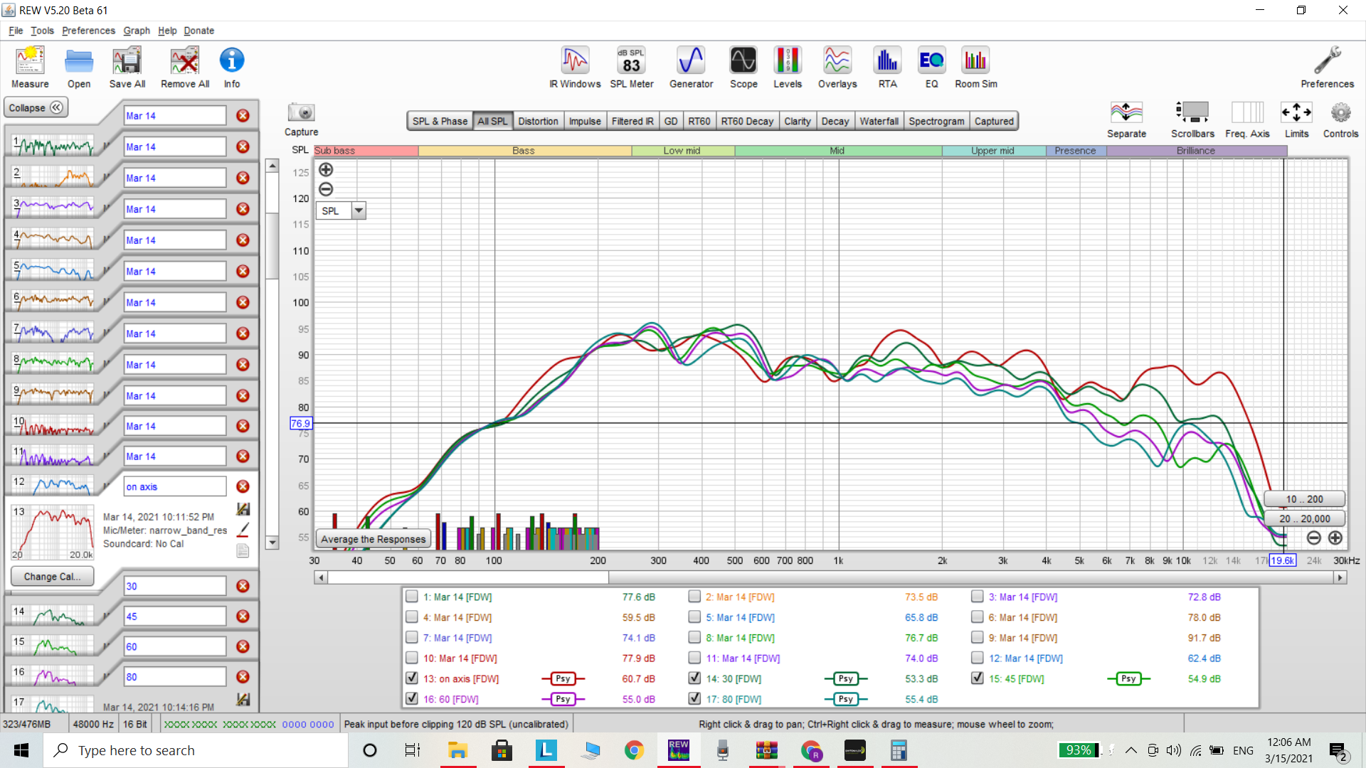

attached are gated measurements at 1 meter, on axis and off axis responses, 30, 60 and 80 degrees, they measured better than expected, they sound pretty good too horizontally,
vertically there's an instant 10 db drop and it drops even more when increasing the vertical angle, which is expected and needed.
i;ll also attach pictures of the arrays, and a small video that i took using my phone microphone, did a decent job capturing the sound
they did a pretty good job maintaining an almost constant spl up to 10 meters,
can't hear any comb filtering , tried playing pink noise from 300 hz till 5 khz and using RTA with a microphone going up and down from 1 meter away, expecting to see destructive interferences, nothing showed up on my RTA,
seeing the good horizontal coverage and the absence of audible interferences makes me wonder if any shading is needed at all in my situation, am i missing something?
And what do you guys think about the measurements, arrays and the video?
PS no EQ whatsover, only HPF and LPF

Cool huh? 🙂 Great to see your 2 meter tall prototype.
If you want to shade or not depends on your own needs/wants with regards of quality.
It would be possible to get an even more well behaving vertical beam. Cute video, can't say I recognize the song 😉.
Arrays are fun, and pretty amazing for their floor size.
Like I said earlier (I think in a PM?) if you could use an array like this up front, and after it falls off, repeat it with another (same height) array, properly delayed to make it seamless with the first array this might work, depending on the size you need to cover.
Did you try it inside the church yet? Good work so far.
