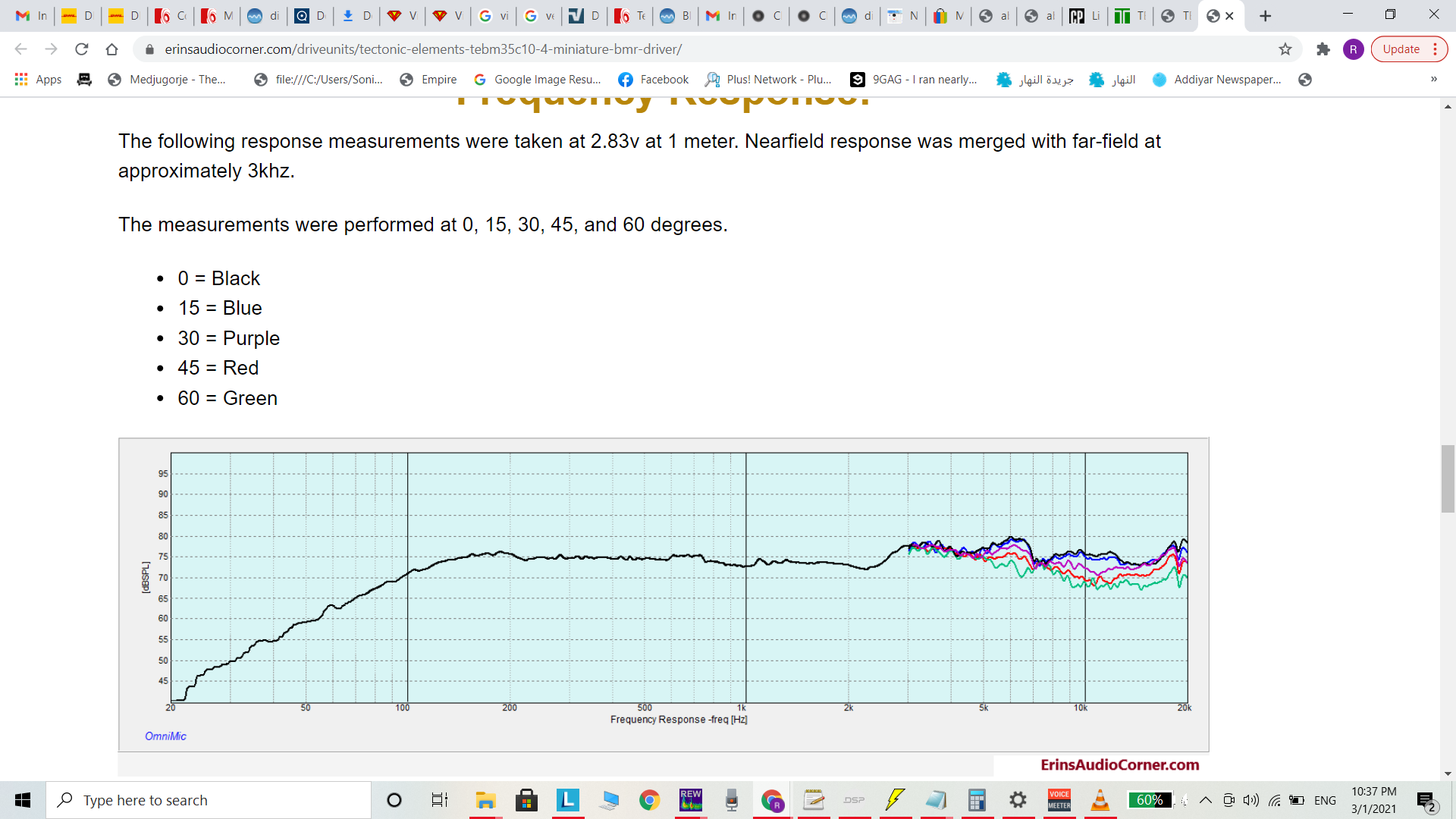

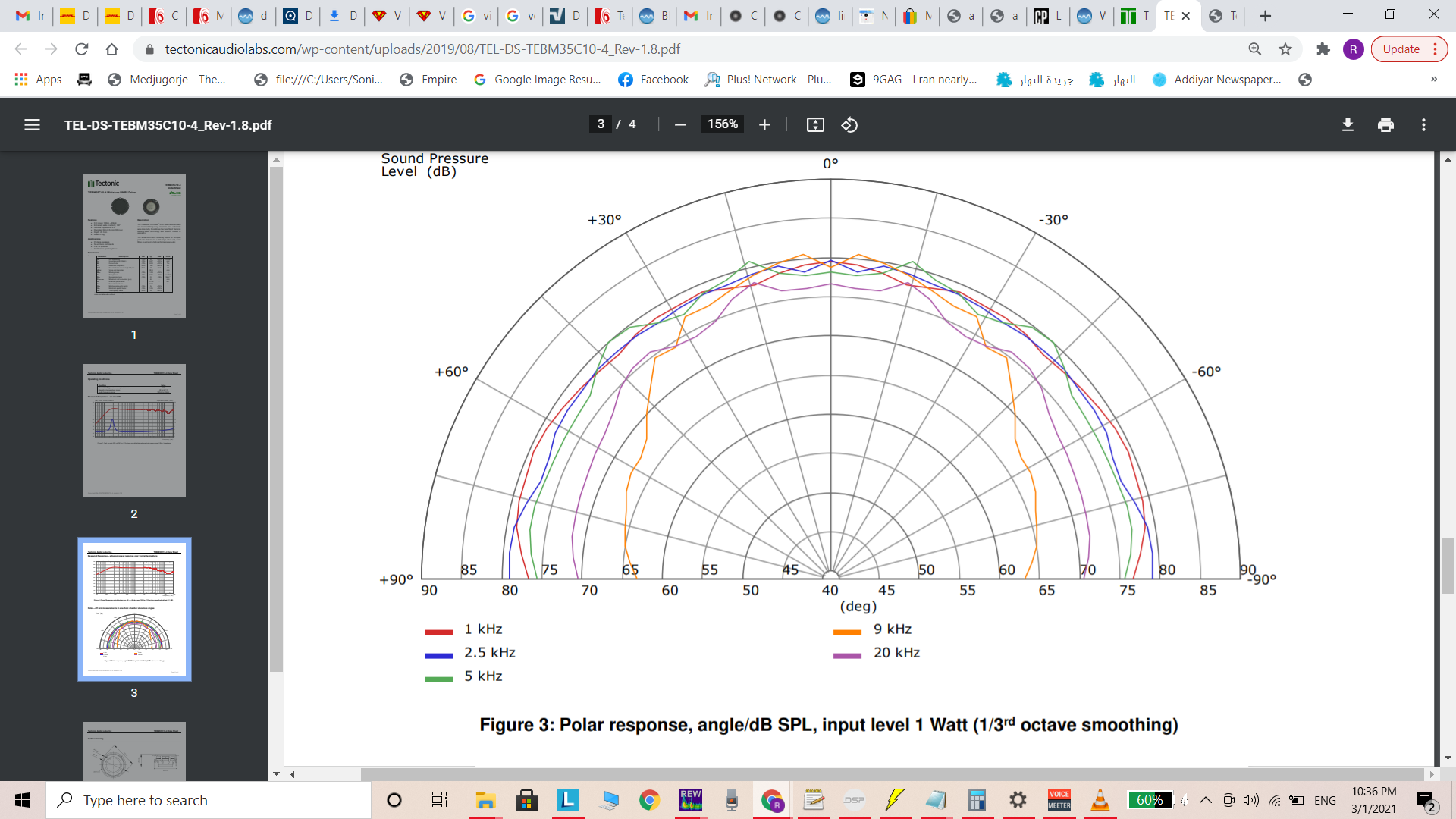

i've attached the off axis and polar responses of the driver i've mentioned, how can the vertical array beam if the drivers are this small, and used in a specific frequency range?
i'd prefer a vertical array cause of aesthetics and other limitations

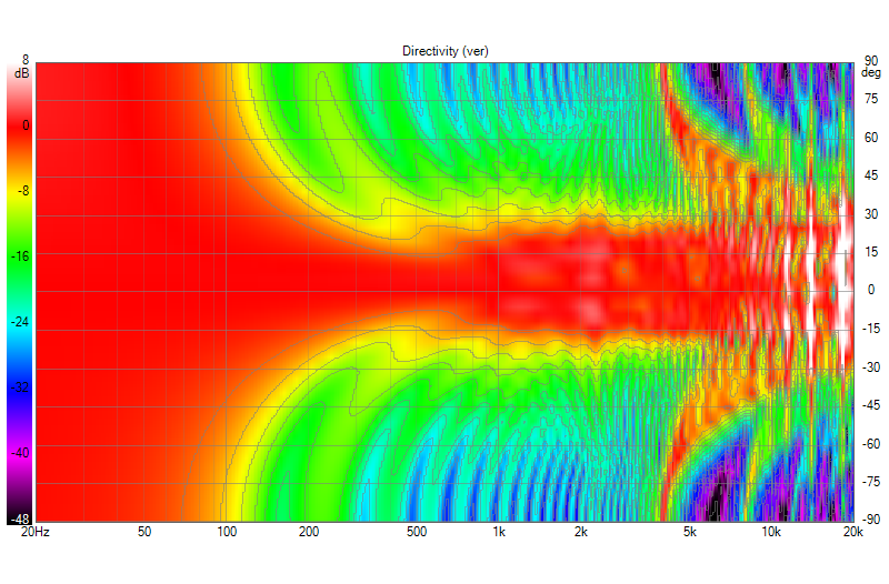

Here's a simulation of a row of 25 drivers (TC9) unshaded (vertical plot):
attachment.php
See how it creates a bundled effect (beam) of roughly +/- 15 degree in the vertical plane?
You can also see the lobes aimed toward the floor and ceiling, which are due to the driver to driver distance. Your driver will be closer together, but also have more dispersion vertically, so it will also show lobing, starting at a higher frequency.

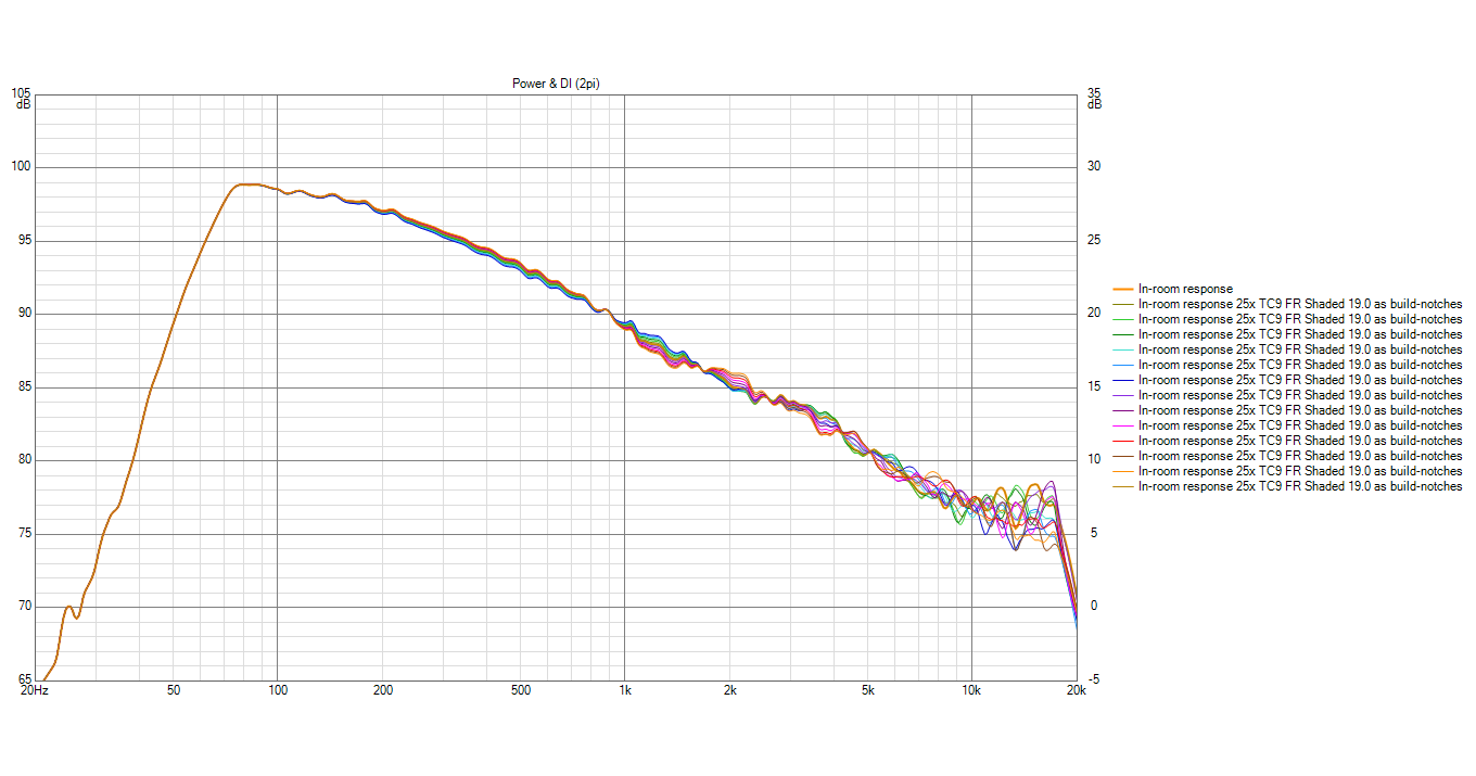

Another thing to account for is the drop of about 3 dB/octave the higher one goes in frequency. You can't simply state it will be 100 dB/watt at 1 meter, as it will show this decline, the higher one goes up in frequency. It needs EQ to bring the top end up/bottom end down.
A sample from my frequency shaded array plots (don't have an unshaded variant handy):
913629d1611161288-towers-25-driver-range-line-array-25x-tc9-fr-shaded-19-0-build-notches-power-di-single-driver-correction-png
This plot shows frequency response at different heights, while having the DSP correction on this array, needed to make only one driver measure flat.
Obviously, the array needs EQ compensation to make it measure flat again.
See the drop the higher one goes from 70 Hz to 10 KHz?

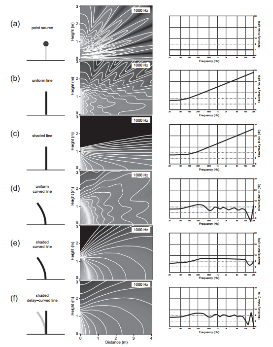

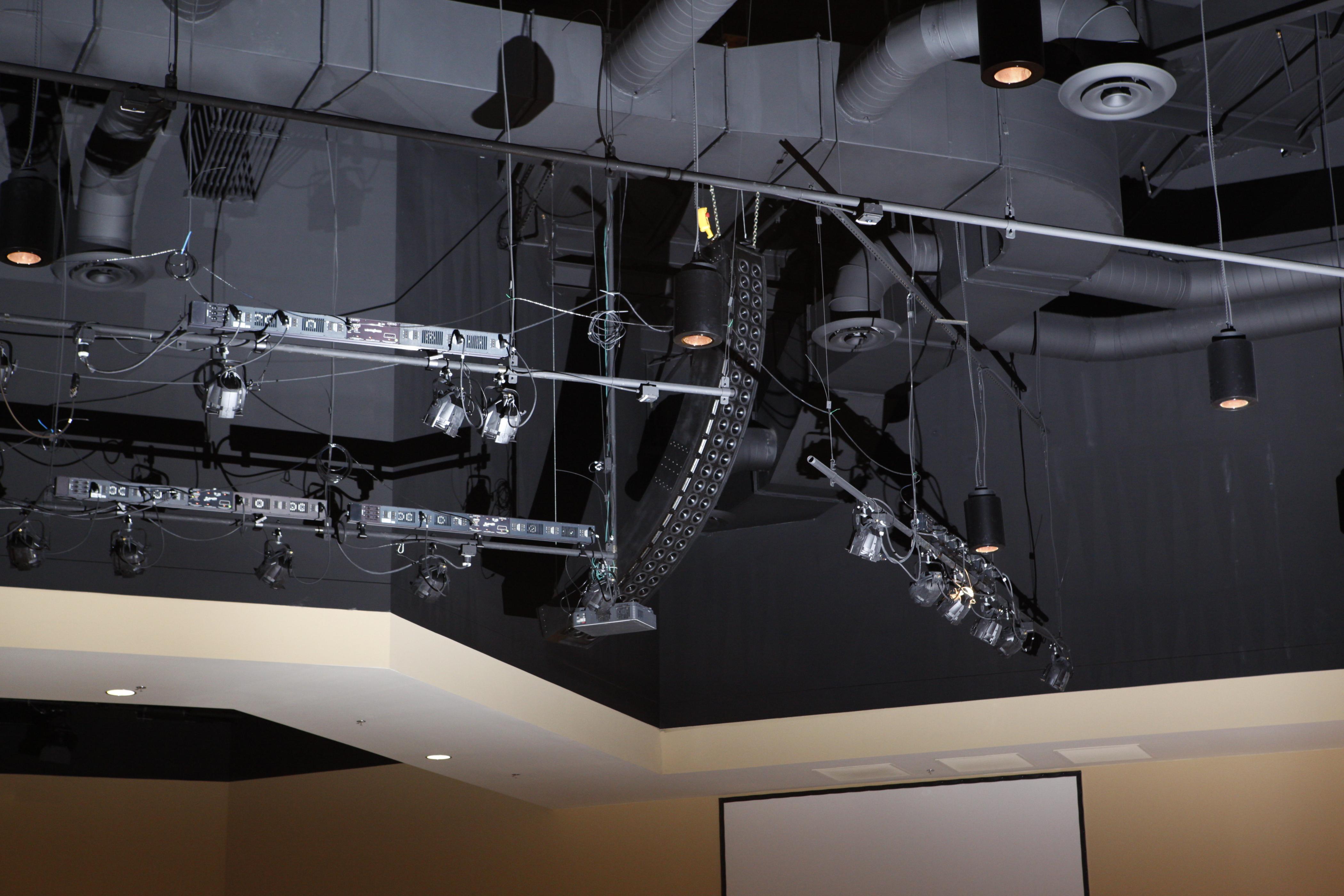

(or one of JBL's CBT solutions, a bend array while being straight to look at. This could be an inspiration to DIY, but it's a multiway array)
i was reffering to keele cbt, curved for better coverage
In this link: https://www.diyaudio.com/forums/full-range/242171-towers-25-driver-range-line-array-657.html#post6490393 you can find an example of a (frequency) shaded TC9 array that was created to have an even vertical response out to about 6 KHz by using shading. It avoids serious lobes from being created, it was meant to be able cross over to a planar tweeter or something similar.
So the shading was optimized to get an even vertical coverage over as large a bandwidth as possible. Horizontally it will be like the dispersion of a single driver.
