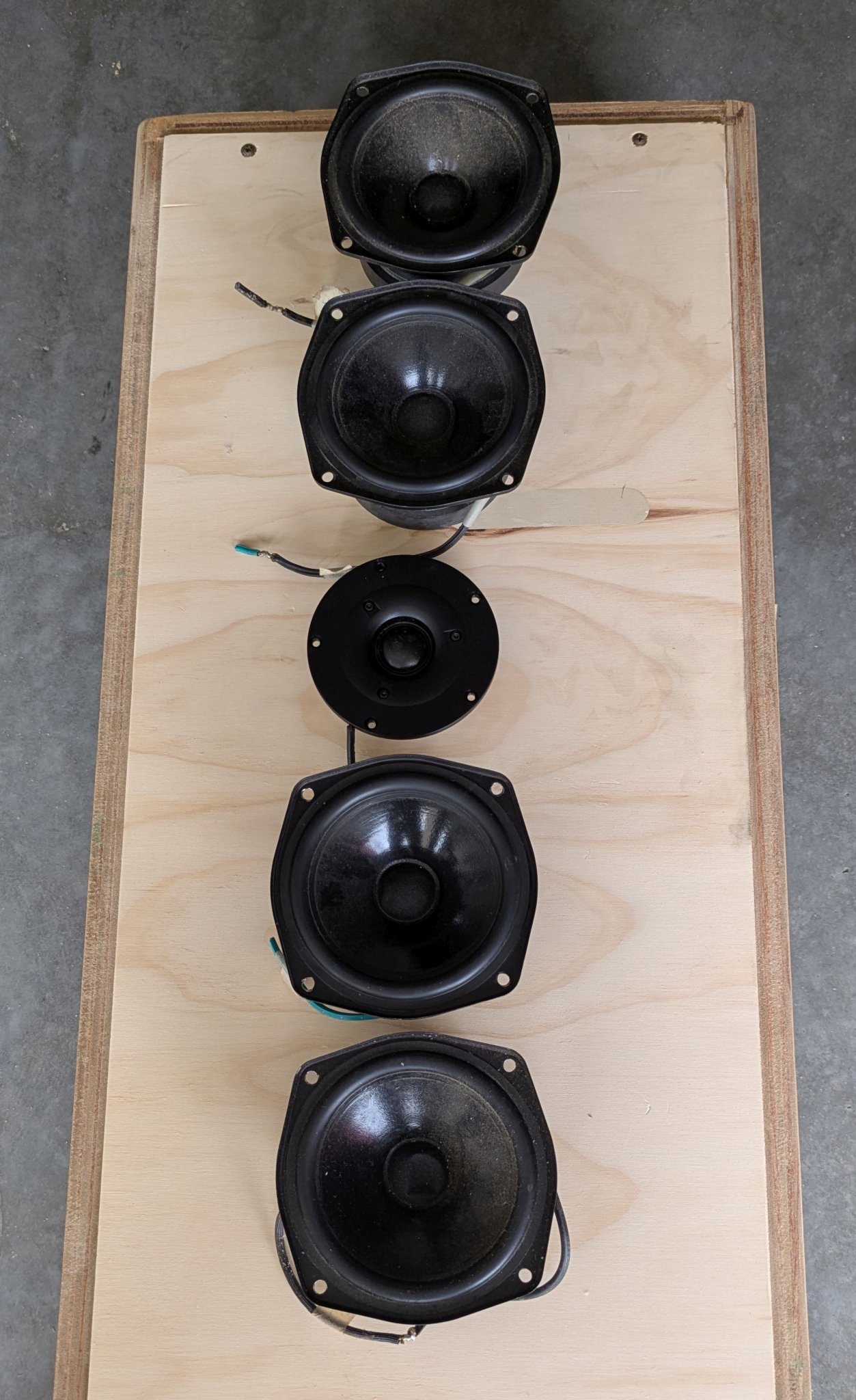

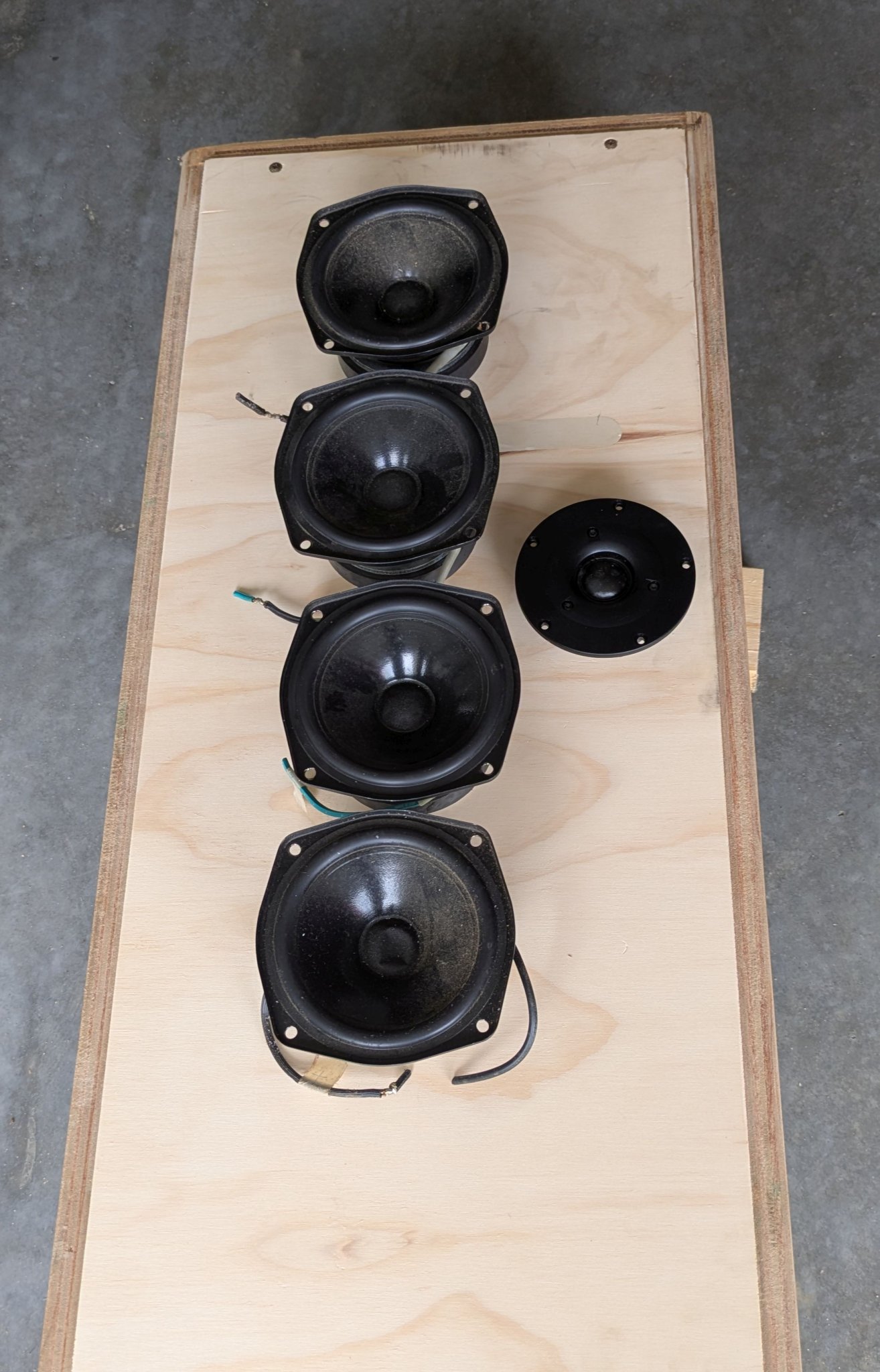

I am constructing a truncated line array with a single tweeter.
The 2 configurations that I am considering are
1. D'Appolito style
2. Uniform array with the tweeter offset
I am leaning toward 2. since the tweeter voice coil will be nearer to the listener in configuration 1.
1. D'Appolito style
Yes, it's difficult to pick a winner. I probably wouldn't use physical delay as a reason to override a spatial requirement.
